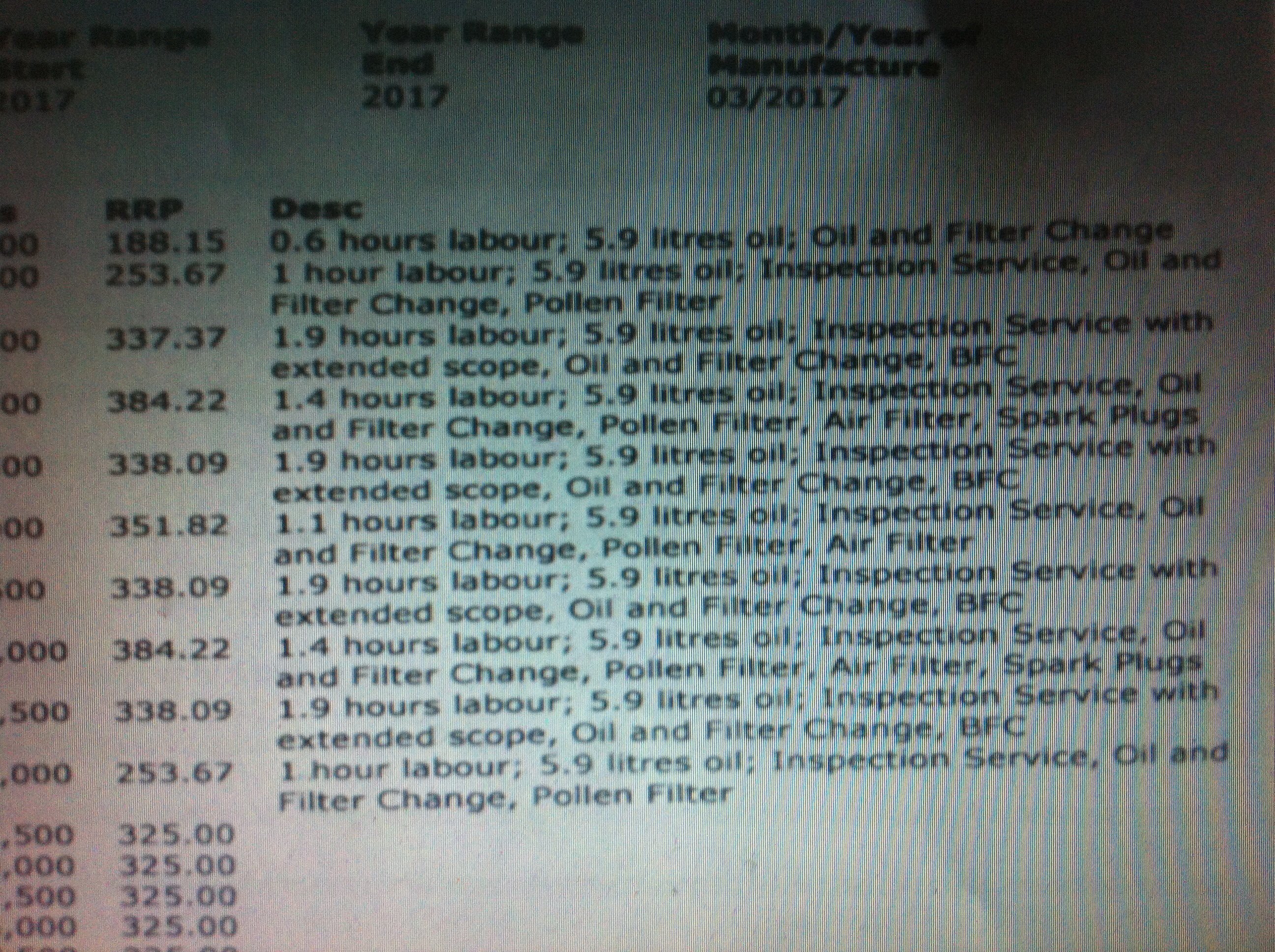

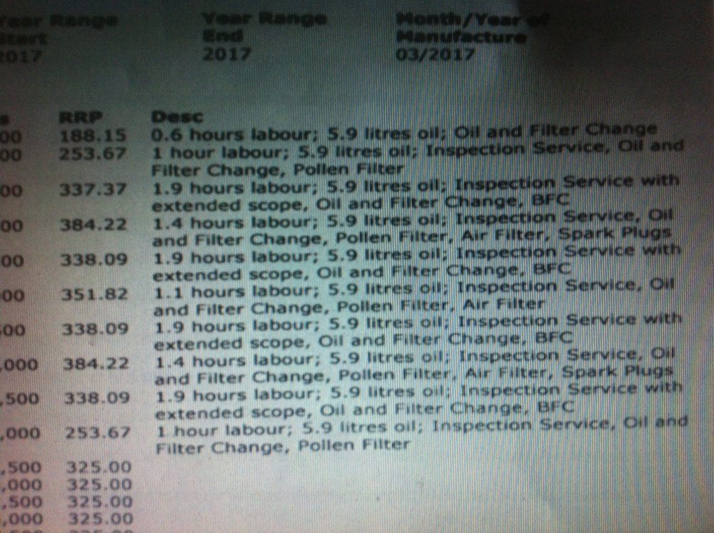

Saw on official list published on here recently from Skoda that they state 5.9litres to fill so that may explain the low mark on the dipstick.;)
Oh, ok.
I searched and found everything saying 5.7.
8 minutes ago, Alex-W said:
Oh, ok.
Here you go.
