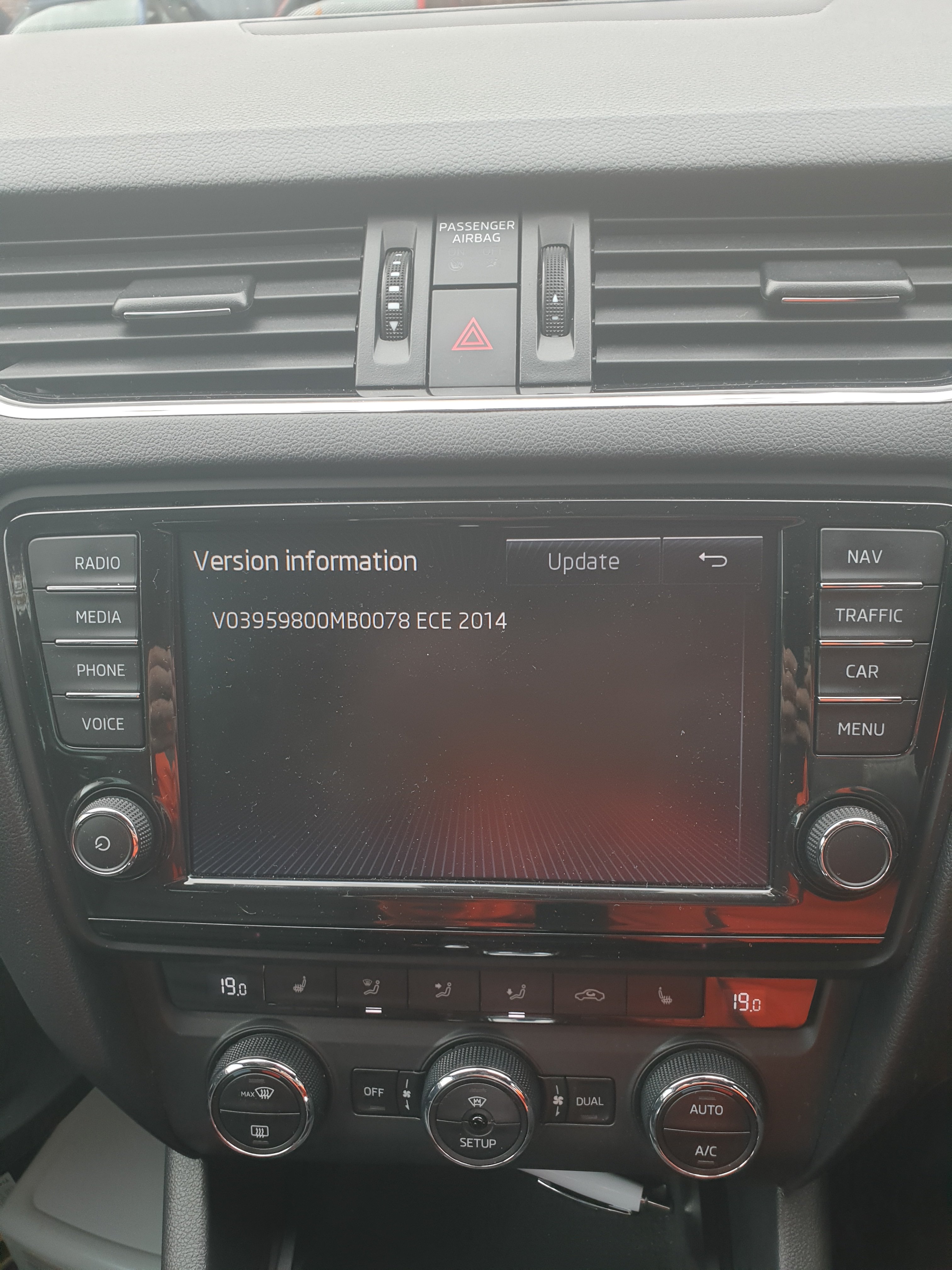

My car is an Octavia VRS TDI 2014 - Not sure which unit i have. Think it might be columbus. I only have a samsung sd card (32gb) as my car didnt come with a genuine Skoda one. Ive got 2x SD card slots, a CD slot. Also noticed i have some sort of HDD for storing media (only noticed the other day)
On VW portal Ive selected Golf > From 2015. Not sure if its 'Discover Media' or 'Discover pro' - Any help?
I believe i can use any SD card with columbus. If so, and i download the VW files to it, how can i back up my current system incase anything goes wrong?
That's a Columbus.
Go to the VW site and select Discover Pro.

But I think mine is mib2
Thats an MIB1 unit,  MIB2 was from 2016 onwards, no point in using the the MIB2 files as they may not work.
Thanks guys for stepping in. I wasn't sure as I've only got an Amundsen (cheapskate).
Edited by TheWanderer
Can confirm that's an MIB1.
MIB2 doesn't have physical buttons.
The official way is to copy all files to the SD-Card (both MIB1 & MIB2 folders) and the devices chooses the files it needs.
However it can't hurt to delete the MIB2 files & try it.
Will perhaps save you 5 minutes copying but the install time in the car is the longest time (approx 45mins to 1 hour).
