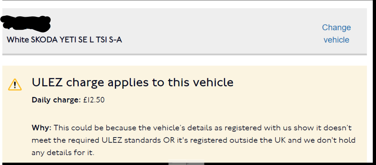

Hi I have just changed from a well worn (!) 2.0 diesel Superb MkII  (2010) estate to a 1.2 tsi 2016 DSG Yeti. Part of the reason, was to comply with the London ULEZ charge. My Superb was not exempt and I automatically thought the Yeti would be....my wife has a 2015 VW Beetle which is exempt and has the same running gear - 1.2 Tsi DSG petrol engine.
It transpires that my Yeti will have to pay the £12.50 a day !
Has anyone else had the same result when checking a similarly specced  Yeti?
Many thanks.

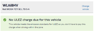

How did you arrive at that conclusion?
As far as I can tell petrol car qualification to avoid the ULEZ charge is Euro 4, which became mandatory in 2005...
Did you enter your registration number correctly?
I just checked the reg. number of a 2016 1.2 TSI petrol DSG Yeti from Autotrader...
All good, no charge...

Hi Silver/Muddyjim  - I did the same as you, got a registration from autotrader -  the same model and year - and spec - and yes, you are correct, however my Yeti received this:
However I did speak to someone at ULEZ and he agreed that it was compliant and interestingly asked me if it was a 'Motorbility' car before I purchased it - which it was. This has some bearing on whether it is compliant or not - I didn't quite follow his logic. Now they want to see a copy of the V5 to establish that it is what I say it is.
Thanks for you response - I do hope they sort it out promptly!

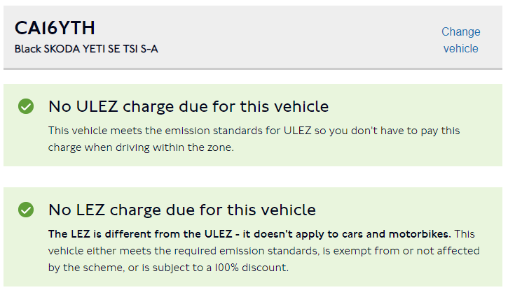

Below is the 'one' I tried....
John

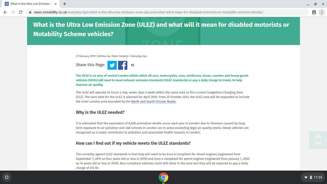

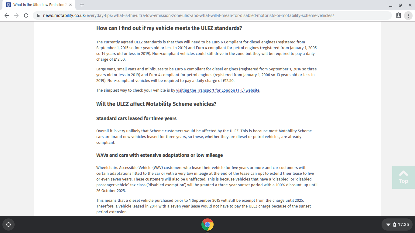

Reading the gov website about ulez charges, I reckon the reason is this; it looks to me as though a Motability car is automatically exempt from ulez until 2025 regardless of its emissions rating. If a car before then is removed from motability status, I presume the ulez exemption will have to be reassessed, in case it doesn't comply?
Re 2025.
See the bottom 3 lines here and diesels.
