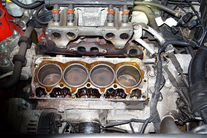

And it's off.
Edited by TMB

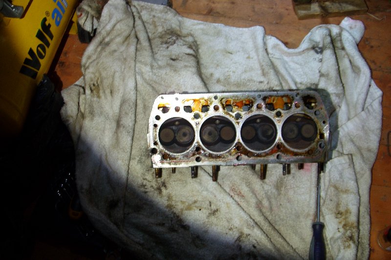

That head gasket has been blowing for quite some time judging by the state of the mating faces.

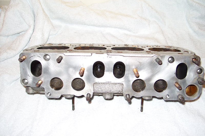

Just cleaned up the manifold gasket face...

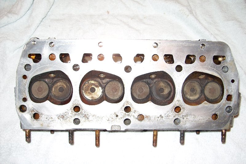

Head face has some pitting but it's not very deep, so hoping the skimming will take care of that...
Yeah, no doubt.

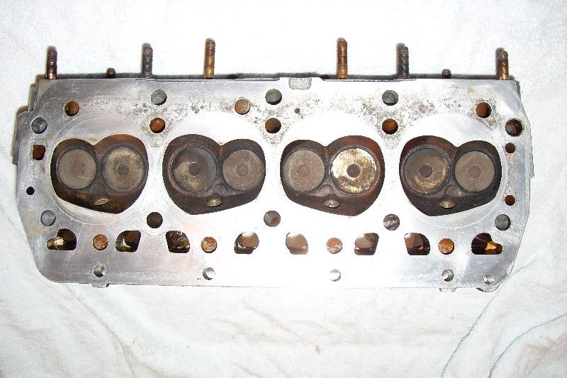

One of those inlet valves looks suspiciously clean!
It's just where I was wiping when I was cleaning the head. As you can see, it wasn't like that when I took it off...

Never had a head skimmed before, do you have to remove the valves, studs etc? I want to put new valve stem oils seals on it so will probably remove the valves anyway.
Do they go through some kind of wash afterwards to remove swarf etc?
The machine shop will generally get the head set up on blocks and clamp it to the machine table without removing anything, and yes they will clean it after flycutting it. You might as well get them to replace the stem seals as well since they'll be able to do it much quicker than you.

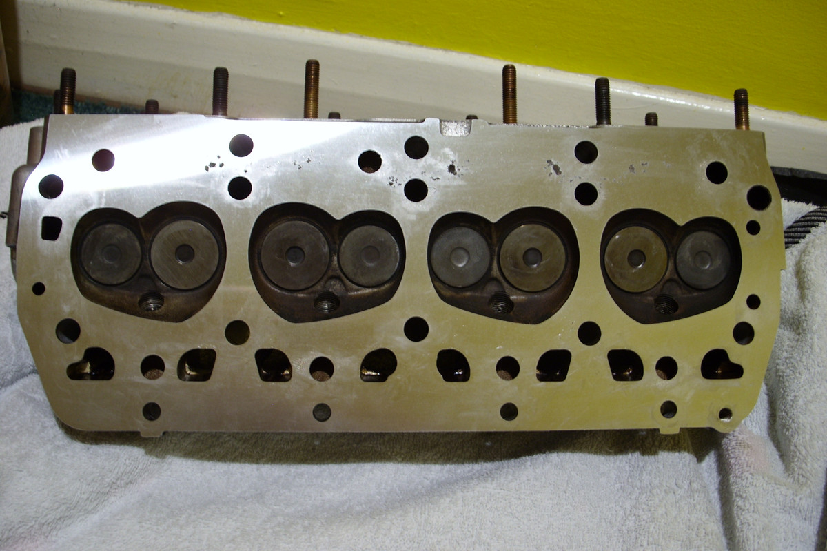

Head after skimming. Still looks a bit shit but the guy said it will be OK. I found a lot of swarf remaining in some galleries, so will be putting the air gun on it. Cost £60 for the skim and to install new valve stem oil seals.

Looks good, £60 is a KILLER price as well for all that work, would've been nice if they'd put it through the parts washer though.
I wasn't sure whether the price was good or not but you know better than me about engine stuff, so if you say it's good, it must be good :thumbup: I checked to make sure that he had fitted the new valve seals and he definitely has. But yes, cleaning could have been better.
