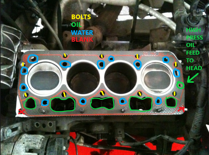

If anyone's doing this job and wants to know what all the holes are, here's a pic...

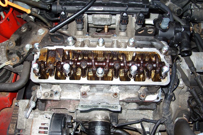

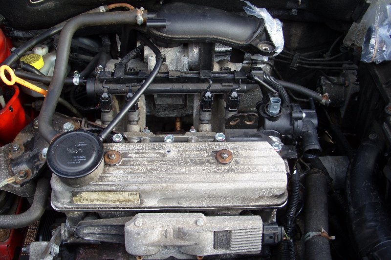

Bit of good weather this morning, so tappets set and all done apart from cooling system flush but I need a break from it as my back is aching 😣
OMG it won't go. Starter motor sounds all wrong as though there is hardly any compression. I set the valves to the letter so god knows what's going on.
Check the valves are closing properly, set number 1 on compression and check the tappet clearances.

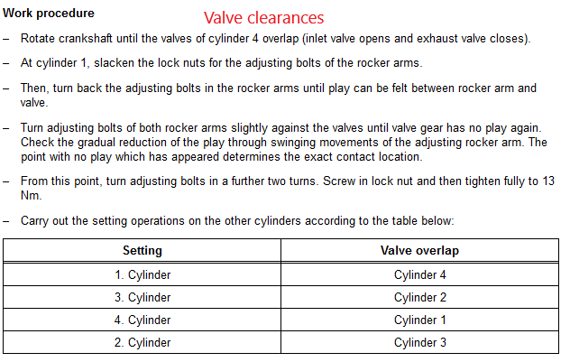

Holy fuck it's going! It was the tappets. I follwed the Skoda instructions to the letter but they needed backing off. There is no actual clearance just so many turns of the screw to set preload. If I set them so that there is just to say no play it runs.
This didn't work...
Edited by TMB
I would have expected the tappets to be too tight because the head was skimmed.
I know but I'd already adjusted them. Just drove it a few miles and it drives fine but it's definitely tappety. Will have to tinker with them again later. I'm not even sure the car is fixed because after the drive there was tons of pressure in the cooling system. More than I would think normal. Time will tell.
