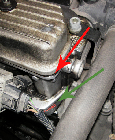

What year is it? There was a revised head gasket fitted to later ones. The revised gasket is identified by the red letters TEMAC on the front right of the gasket. Green arrow here...
Edited by TMB
Mines a 2001 1.4p 8v but no sign of water in the oil 😁
Best have a look and see if you have the revised gasket. There won't always be water in the oil.
Edited by TMB
Just had a look and it isnt a revised head gasket
May well be the gasket then. Sorry 🙁

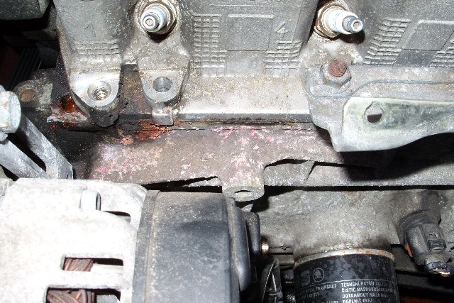

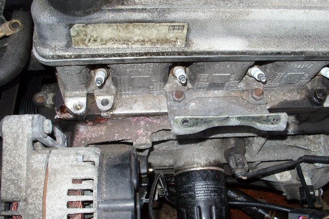

Started taking my cylinder head off. Got all the bolts out of the manifolds but they are stuck absolutely solid to the engine 👀 Anyway, I noticed some pink staining on the block where coolant must have been weeping...
If you're certain all the fixings have been removed from the manifolding then use a big block of wood and an equally big hammer to jar them loose.
