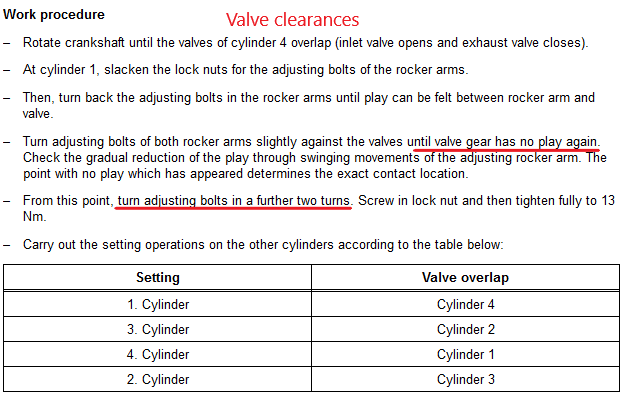

I'm not sure what to do about the tappets. If I adjust them to what Skoda say, the valves are hanging open and the engine won't run. The procedure is the usual pretty common procedure for setting the preload on hydraulic lifters for OHV pushrod engines  - adjust the rocker arm until it's only just making contact with the valve stem and then turn the adjuster down two more turns in this case. If I do that it doesn't work. I can only presume that the setting procedure is meant for brand new lifters with no oil in them, only spring pressure. Or that the oil should bleed out when adjusting used ones. The lifter piston is meant to compress to the preloaded position but my lifters must be full of oil and solid, so the engine valve is moving down instead of the lifter piston. This is stopping me from making a proper setting. Not sure how to overcome this.

If you want to go old school on the tappets then set exhaust to 0.016" and inlet to 0.012".
No need to overthink this one.
I wonder if I tried adjusting them on a warm engine. Maybe the thinner oil will bleed out of the lifters more easily.
There is meant to be zero lash before making the preload of two turns. Nothing to do with overthinking and everything to do with doing things properly. Giving something a clearance when it's meant to have a preload is not the answer.
Edited by TMB
Generally when you overhaul the head you empty the hydraulic tappets on OHC engines but since yours is OHV the tappets are hiding down in the engine block so this is not possible.
When the engine is running the tappets should take up excess lash by pumping up with oil pressure so I don't understand why you wouldn't want any lash when there's no oil pressure.
Because there are springs in the lifters which take up the lash for initial setting. And because Skoda say so. From what I can gather, the purpose of the 2 turns preload is to set the plungers inside the lifters to about the midway point to give the plungers some leeway from hitting the top or bottom of the lifter cylinder.
See Tech1e's post here...
https://www.briskoda.net/forums/topic/203744-fabia-14-mpi-valve-clearences/
Skoda says zero lash then adjust to preload, and so does every other OHV lifter setting procedure I've read. Some of the preloads vary but all have a preload.
Edited by TMB
I thought you tried setting it up this way but there was no compression so you couldn't start it? There seems little point in going round in circles desperately trying to follow a process that simply isn't working, I'm trying to suggest something that might work.
You are wrong. You apparently don't understand what a preload is.
Edited by TMB
  • Sponsor
How long did you leave it between doing the 'book' adjustment and trying to start the engine?
About an hour.
Just tried the Skoda settings again on just one cylinder, and it doesn't even start with just the one. If I put it back to just zero lash it runs well but sounds like a Chrysler Alpine.
I've made the book adjustment on cylinder 1 again and will leave it overnight to see if the oil bleeds out of the lifter. It's going to take an awful long time to set the valves if I have to leave it overnight for every cylinder.
You could lean on the pushrods to push the oil out of the lifters, it'd be a lot quicker.
Success!!! Leaving it overnight for the excess oil to bleed out of the tappet has worked. I just need to do the same on the other three cylinders, but rather than leave it again overnight I will try a few hours.
Two hours worked for the next cylinder. Only two cylinders to go 😁
All done and running and sounding great! B)
