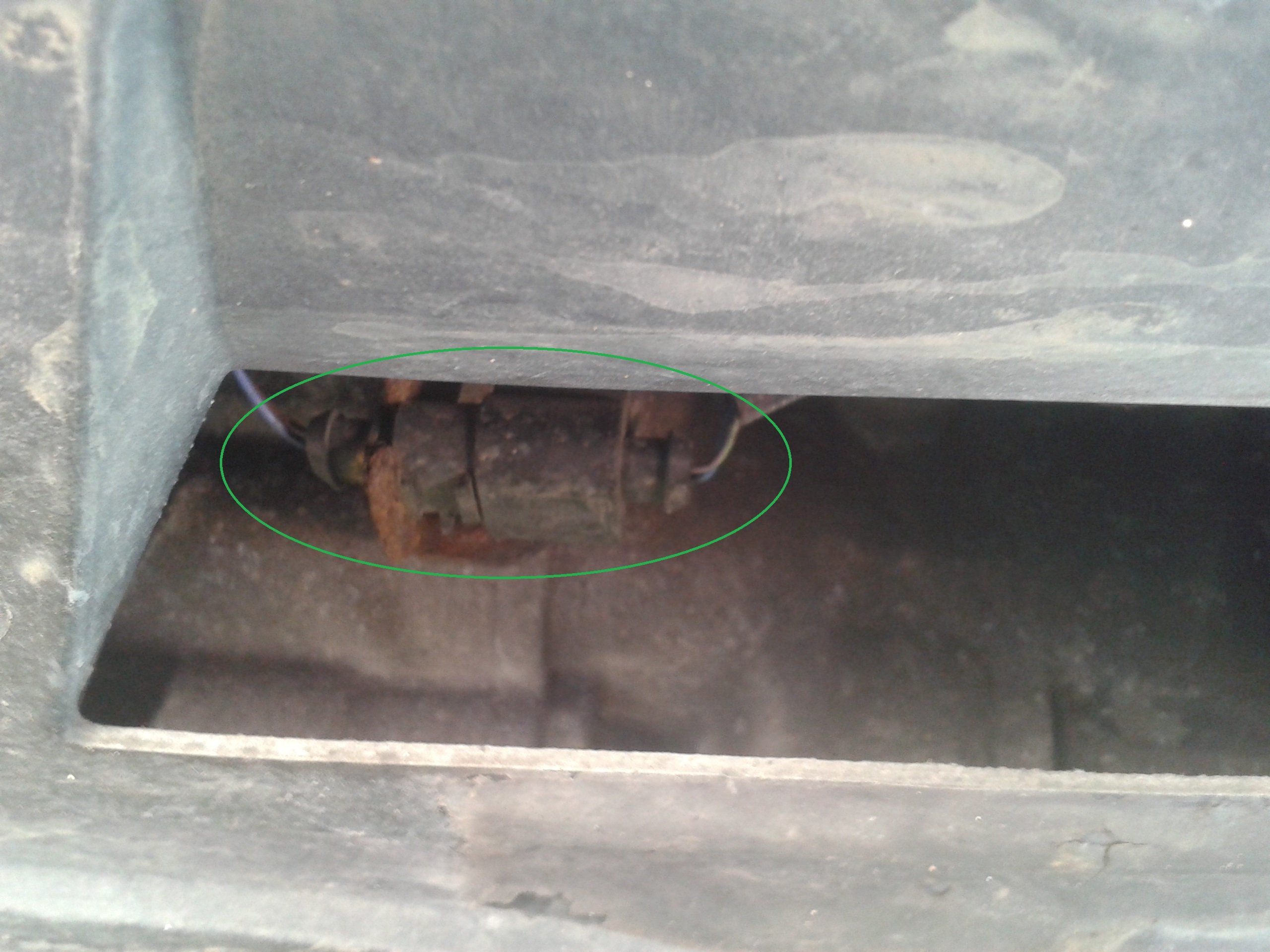

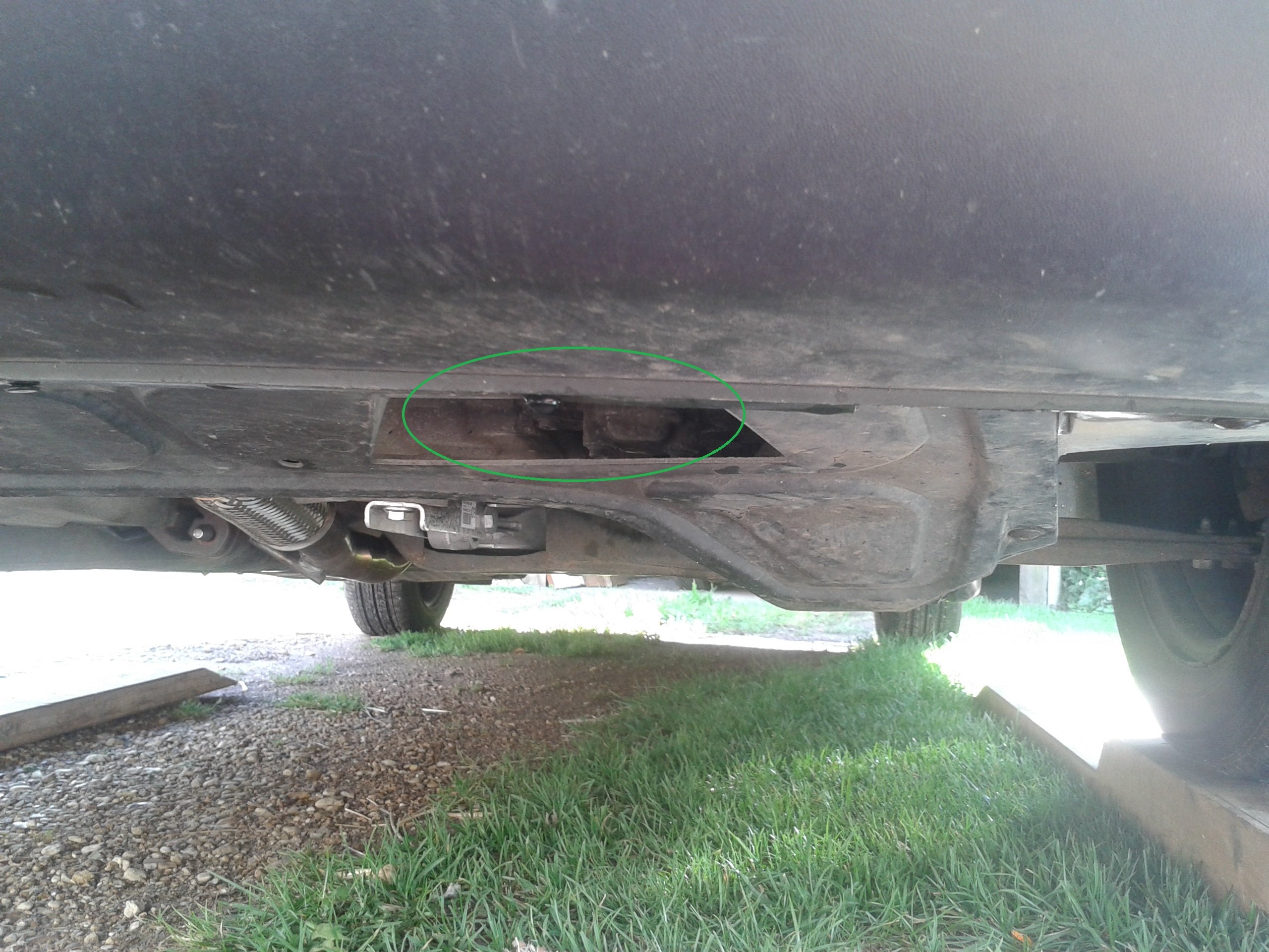

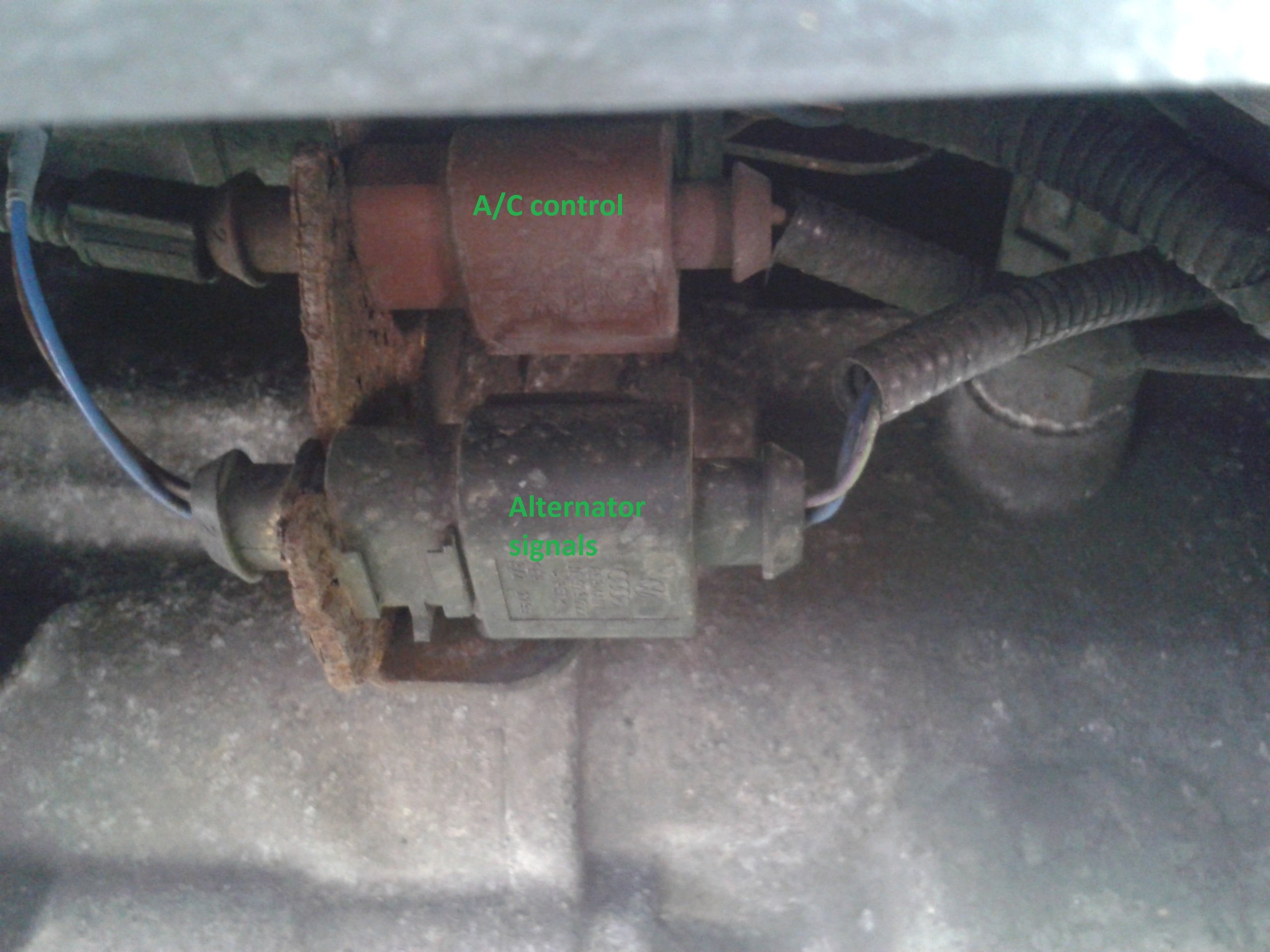

It's likely the blue one is broken at a two-pin plug/socket connection on a bracket on the front of your gearbox. Access usually best from below.
Edited by Wino
I think I can manage that , so if I take the sump gaurd thing off then look up at the gear box I will see it ? What dose it do ? The car has been a pain to start on colder mornings but is fine rest of the time thanks in advance
  • Sponsor
The blue wire supplies current to the alternator to help it start up generating.  If it's broken, the alternator may not start up reliably when the engine starts running; this tends to make the battery gradually lose charge.
Not sure if your car will have this slot-shaped hole in the undertray, but if it has, you may be able  to see the wires without even removing it, by torchlight.

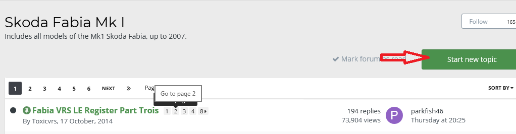

Give this big green button on the right a click next time you find yourself in this situation:
