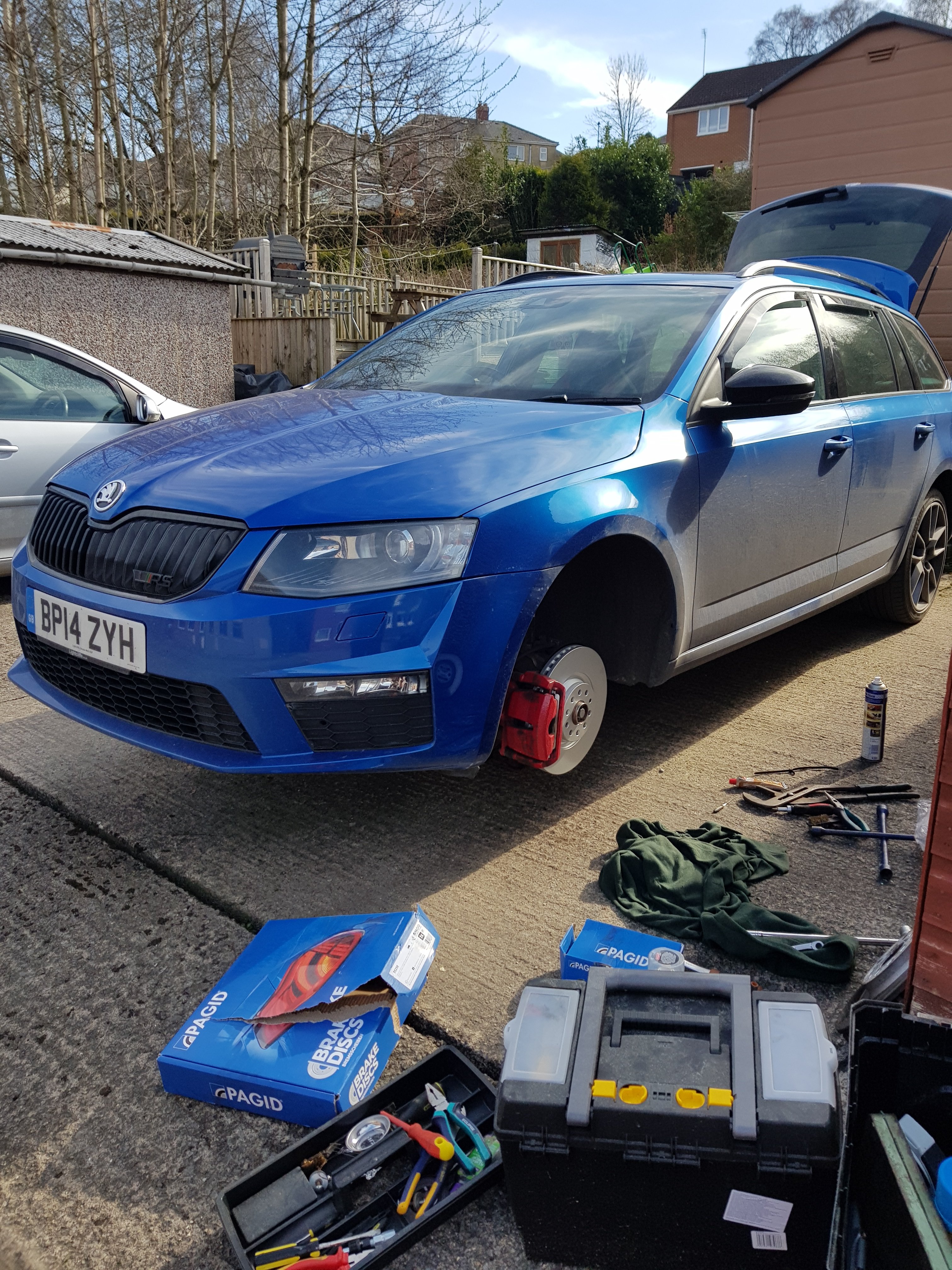

As the title depicts, I fitted new Pagid discs bought here, and similar pads to the car in July.
Within 3 months they were oscillating under breaking, and giving wobble. This hasnt gone away, the pads are wearing evenly and I'm a bit dissapointed..
Are there any better discs out there I can choose from? I've had a search on the forum but couldn't find any specific posts about warping so it might not be a common problem. I drove the car sensibly for a could couple of hundred miles before giving it some beans - is it a case of harsh driving?!

Cheers for the replies, I'll try and rule them out..
The hub faces were cleaned with a wire brush, greased and mounted correctly by yours truly
The pistons in the calipers were a little sticky but were pushed back okay
       - If these were not done correctly and were to blame - surely it would have been noticeable instantly?
The car had it's MOT last month and I was underneath the car with the mechanic who is a friend, all bushings looked ship shape
The only thing I can think to add is that on the odd occasion when the car is cold & travelling at low speeds, there is a knock coming from the front brakes..
