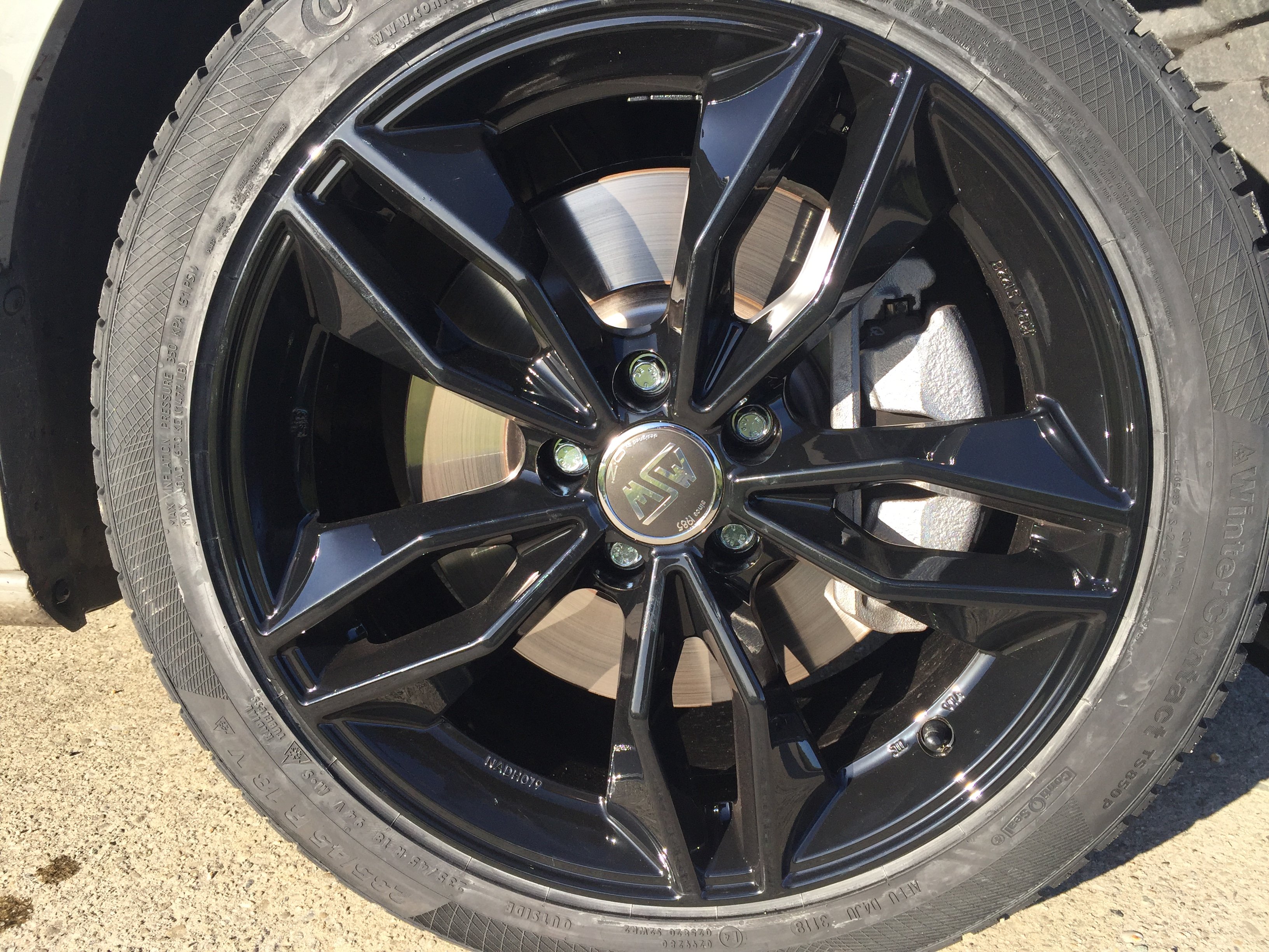

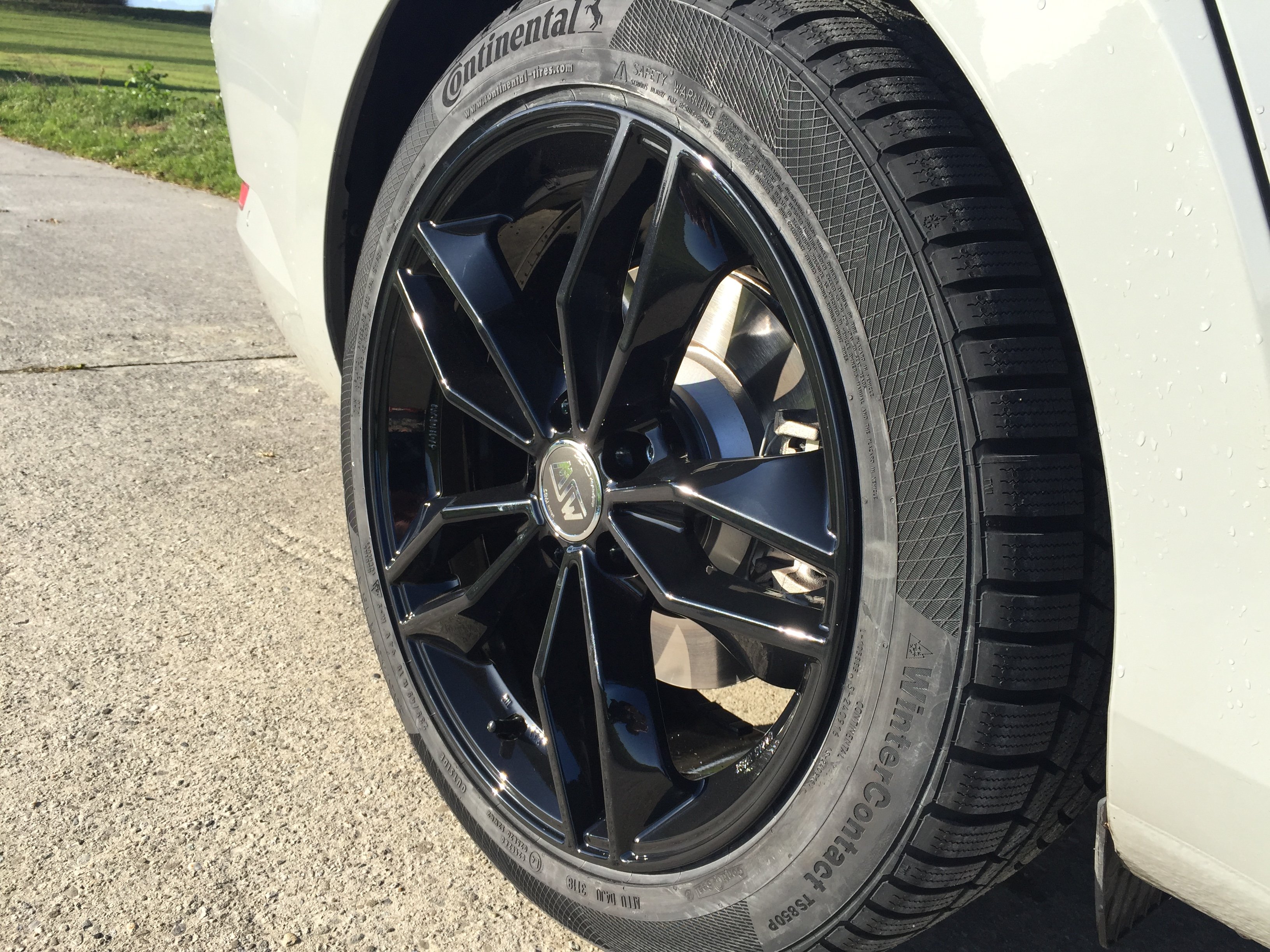

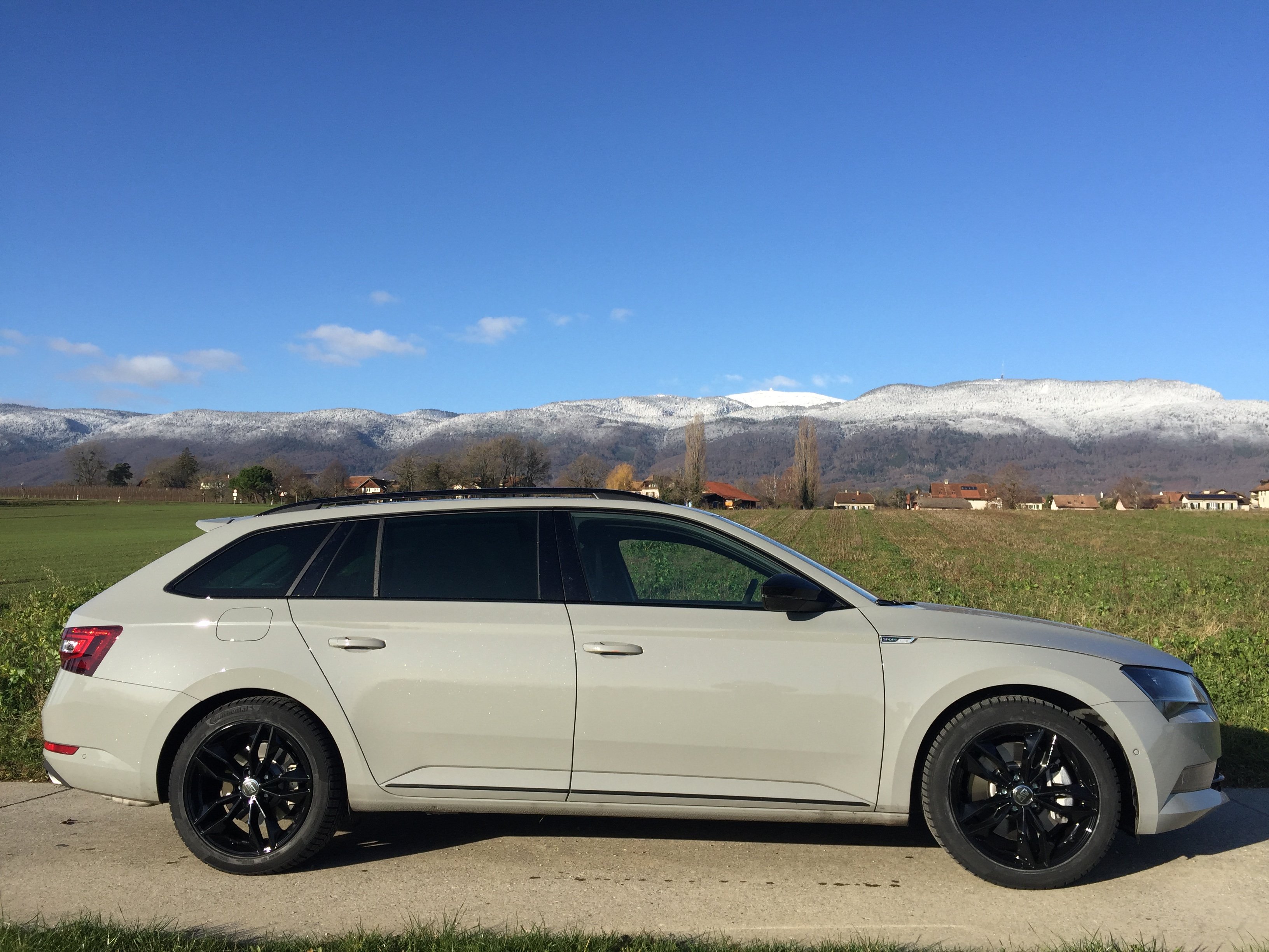

Hey all,
After visiting local wheel shop ended up going for these - MSW 71, gloss black, 18", to be fitted with contis.
https://www.ozracing.com/alloy-wheels/msw/avantgarde/msw-71
Thanks to @newbie69 I could have got a better deal saving a few hundred on another set, but they dont deliver to Swiss, so would have had to hassle a friend in France.
In the end got a set of nice 18 inchers with contis that look not too dissimilar to the summer nova wheels currently on, for the same price as VAG were offering for ugly 17".  Plus the local wheel shop was very helpful, and will store my summer wheels, so happy to give them the business.
Will post a pic here when they are fitted.
Thanks again @newbie69 :)

Photos are up in the picture thread:
Edited by newbie69
Sorted issue with uploading pics (pah!)
Edited by Grumpybeard
And last one
