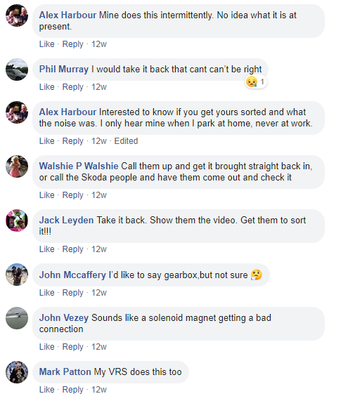

No issues mechanically wise on my first Kodiaq, only had to get a door trim refit as it was rattling. Second is going back in sometime to get a buzzing noise checked out, and the steering wheel replaced.

That buzzing noise, can it only be heard by passengers in middle row?

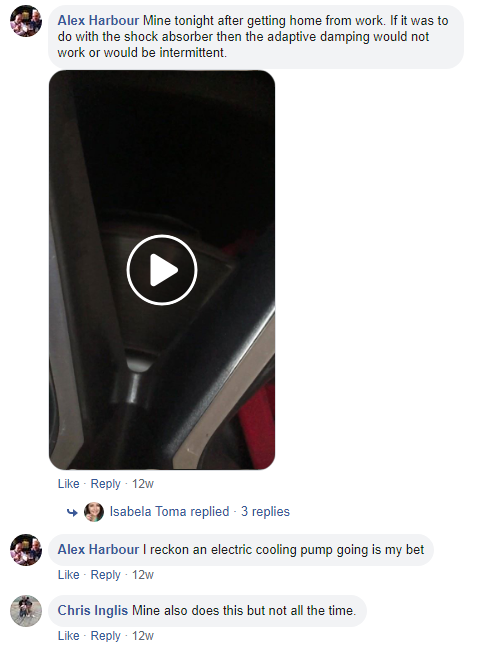

Nah. Happens for 2min after I turn the car off after a drive, then makes a whirring sound (like it's shutting something off) and it stops.
Edited by ZacDaMan72
Might be a sound of closing air vent flaps.
Nope. Dealer has no idea what it is.
Auxiliary pump to cool the turbos?
A lot of modern cars do this.
My Mercedes-Benz makes quite a bit of humming, buzzing and clicking after turning off the engine.
My smaller engined Kodiaq is pretty quiet though, its only really the priming of the fuel pump I can hear when unlocking and opening the door, and then sporadically as long as the door remains open.
Buzzing like this? Yeah nah. https://streamable.com/6u6cy
Gremlins?
Strange, the link works OK for me, perhaps you need to be a member of the Facebook group?
Turns out it isn't normal. vRS owners in the UK are getting their electric water pumps replaced under warranty.
