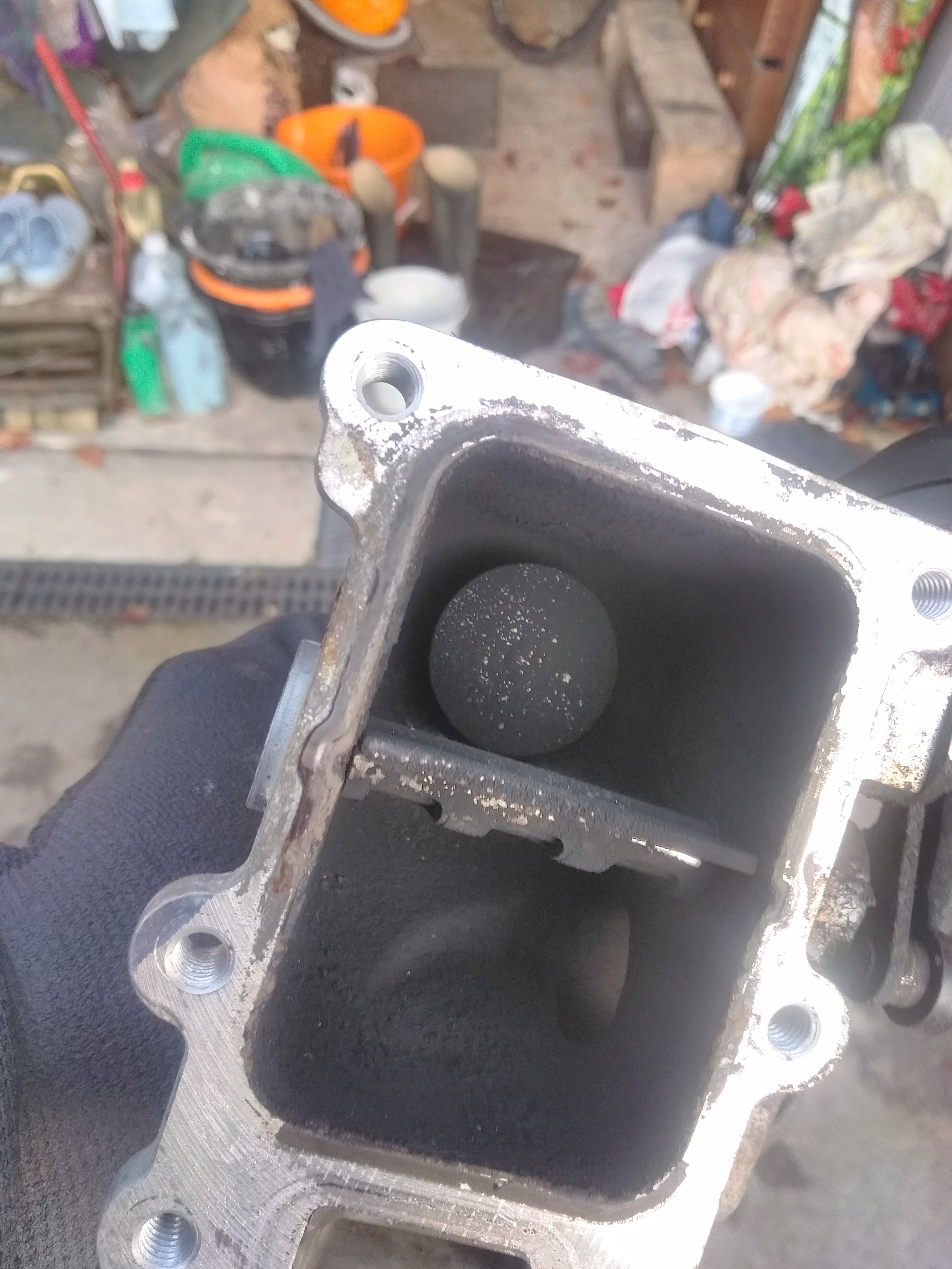

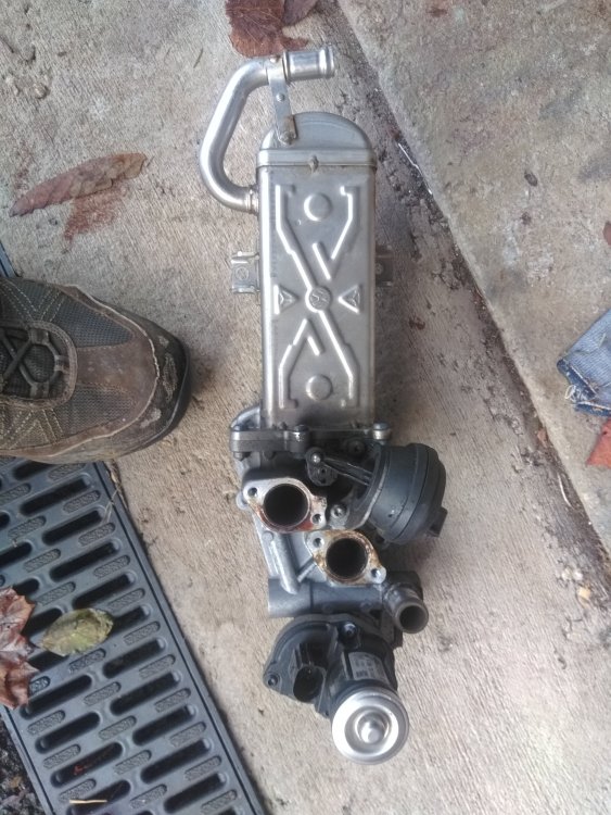

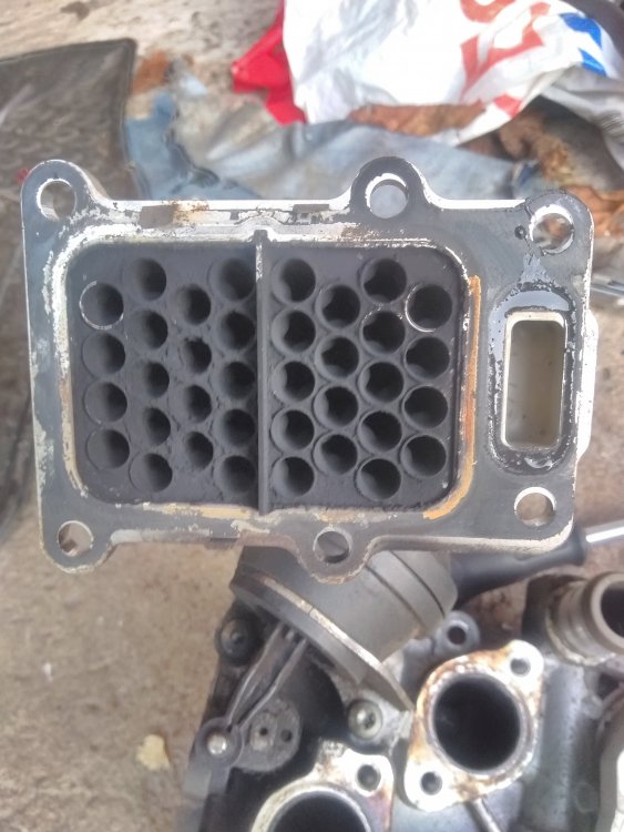

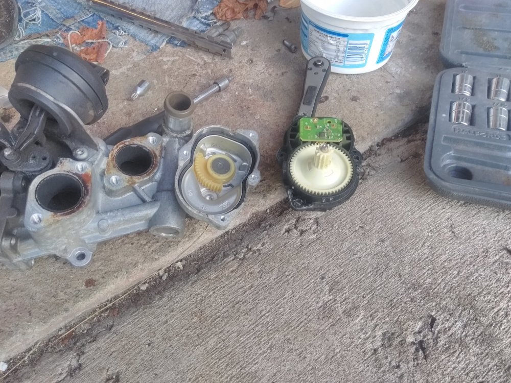

Hi, Thank you for your reply.  I have had the car fixed by replacing the EGR.  This cost just over £700 at a VAG independent garage and as far as I am aware VAG parts were fitted sourced from TPS.  I kept the old EGR and have taken it apart.  I was surprised how relatively clean the internals were.  All the mechanical side appeared to function OK and the garage said it is normally the electrical part that fails.  This is electric motor (maybe stepper motor) with position sensors i  would guess.  The out put is a plastic gear/cam which drives a poppet valve to open/close exhaust gas flow.  Also there is a vacuum solenoid which operates a butterfly valve.
The valve is quite large see photos below.
In all probability it is the electrical part that fails.  Is this available as a spare?  The part number is 117255.05
Hi, I have attached a couple more photos for interest.
