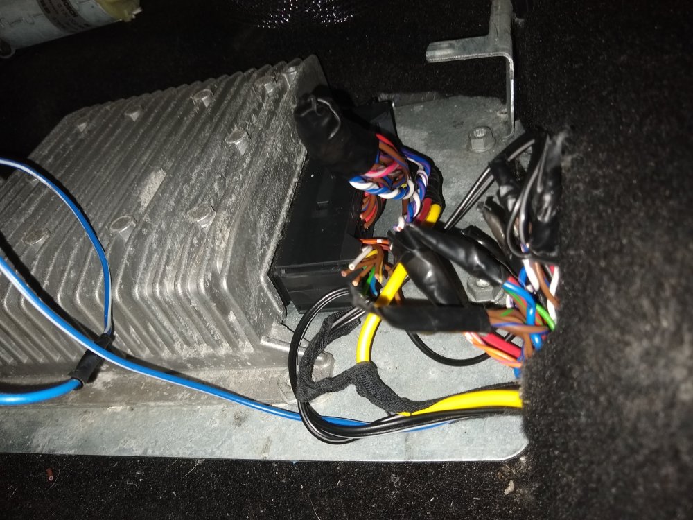

After being disappointed with the stereo in my l&k superb 14 I paid for a sub to be fitted. They fitted it and told me it's supposed to be an amplified system but someone has bypassed the amp.
Took a look and found the pic
Why would this be done?
How do I unf*CK it?
Guessing rejoin the wires and reset stereo to low level out?
Edited by Prstu
At a guess the amp died and it was cheaper to bodge it that way.
