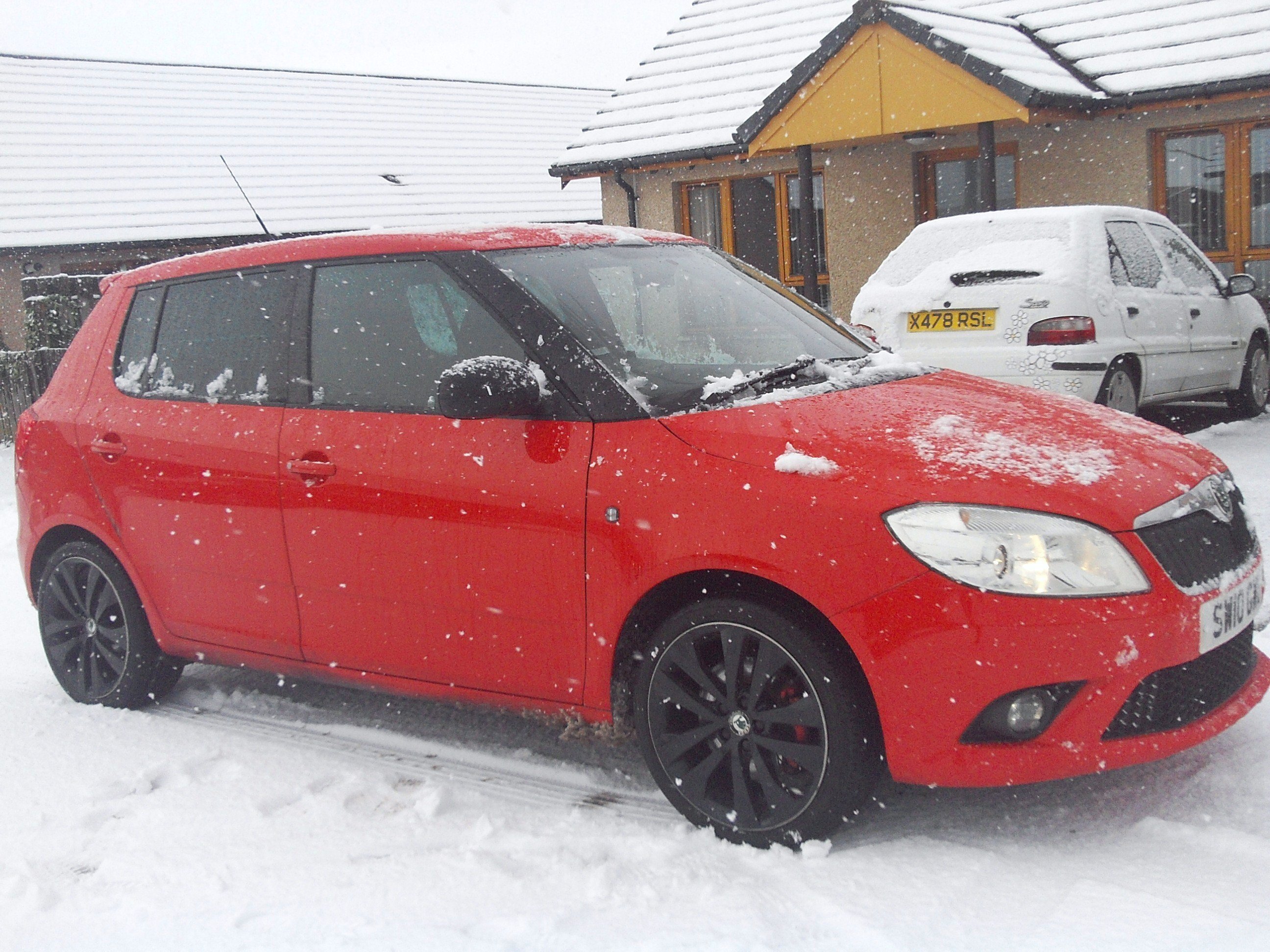

Uniroyals 215/40/17 all round best tyre had so far for MEDIUM range, was excellent in the snow we had a few years ago, WET GRIP A,

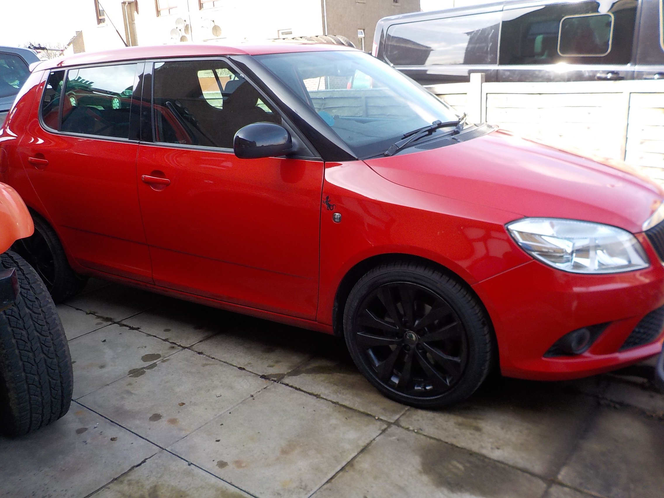

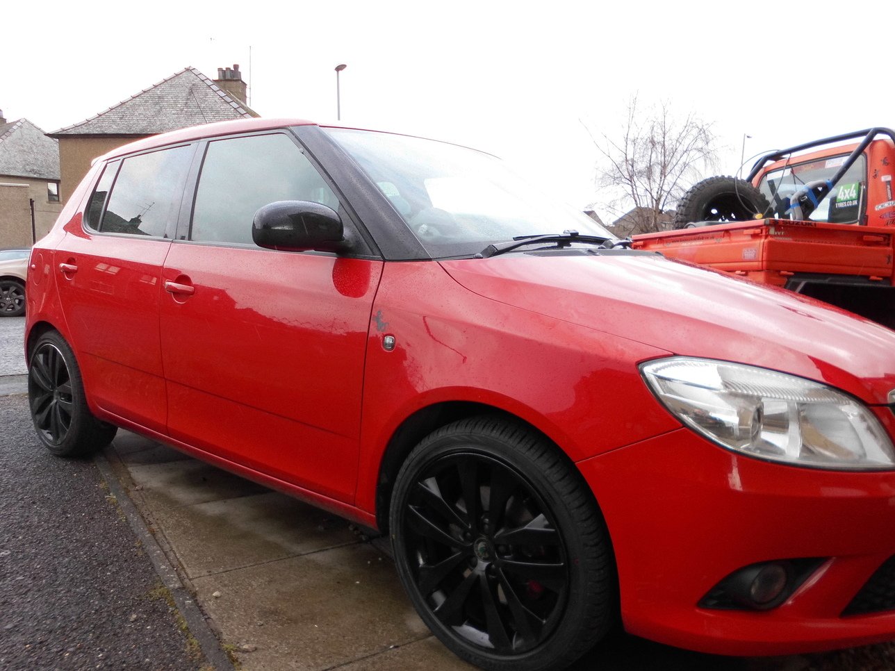

Top pic is 205/45 R 17,  2nd pic is 205/40 R 17,
all others are 215/40 R 17's
