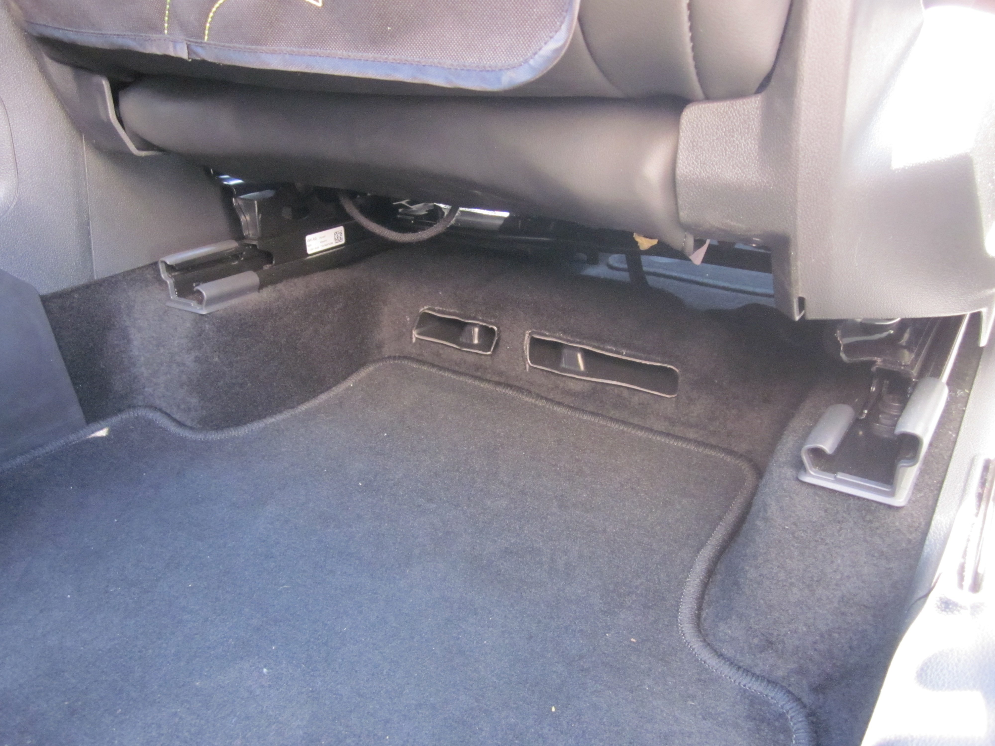

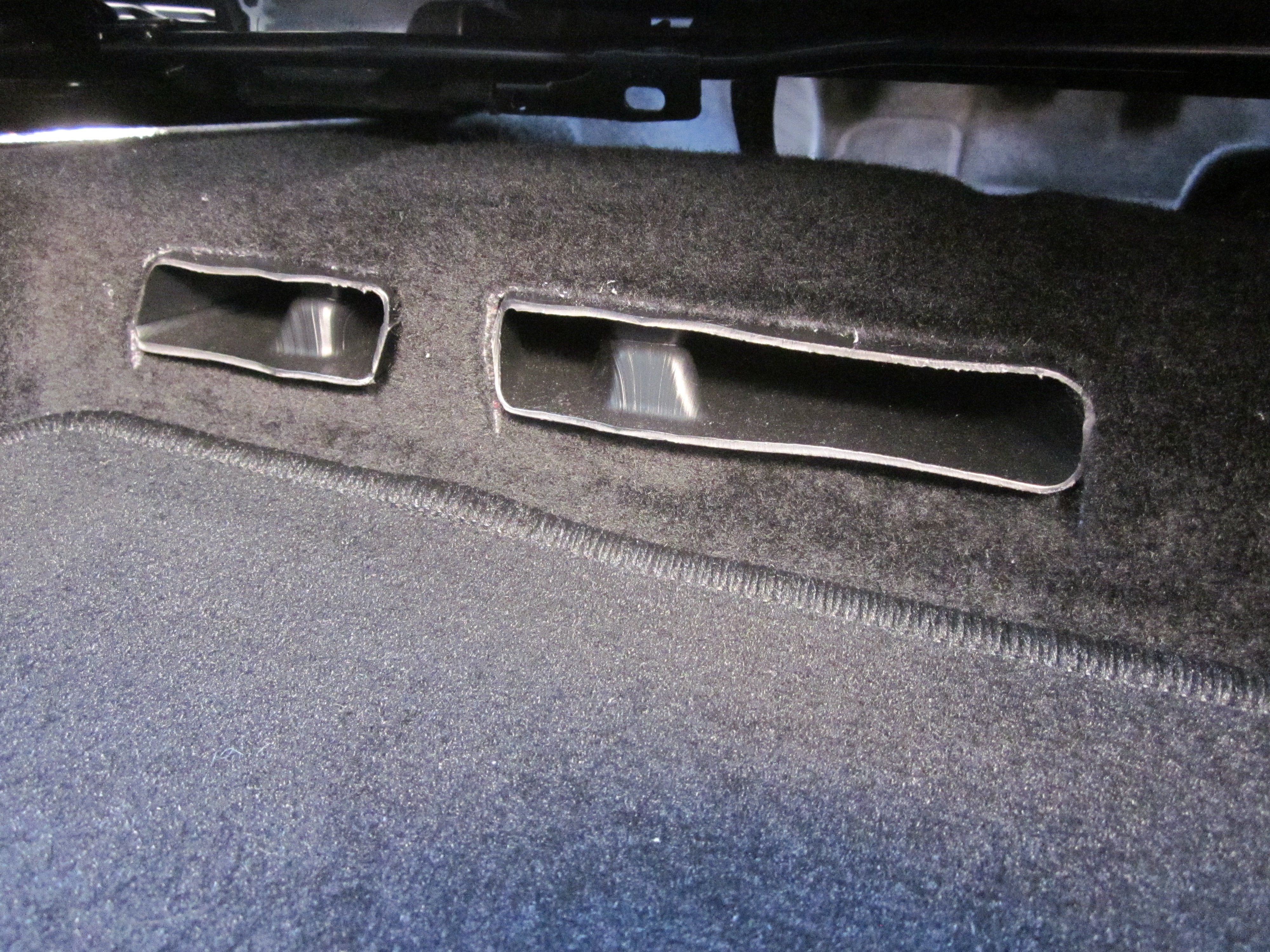

I was surprised how efficient the floor vents are in Kodiaq. The other day did some work outside, gloves totally wet. Threw them to the rubber floor mat at the back. After some time when i reached home the gloves were dry as ever. Never happened in my previous cars.
That's cos' they're massive! 😂
Massive and Ugly. If you gave me an old milk bottle and a blunt penknife I could make a better job than Skoda did.
Fortunately I get very rarely so drunk (as a passanger of course) to have a chanche for a close look.
I stuck some cheap tat over Skoda's cheap tat...
