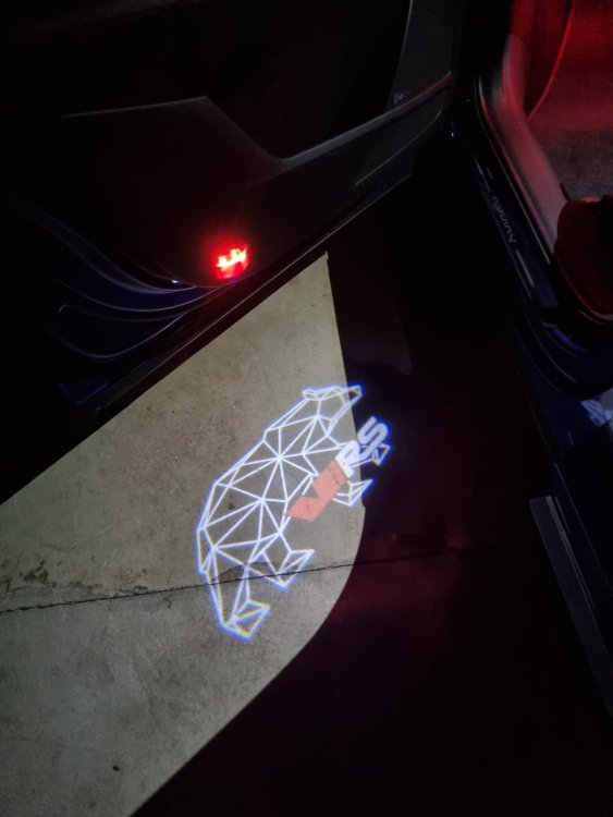

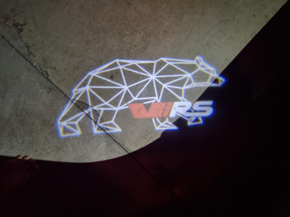

Hey Crapula, YOU ROCK!!! Thank you for this amazing post, so easy even a girly could do it, now I have my vRS Kodiaq Bear welcoming me home!!! I owe you a hug and a beer (or many) Thank you!!
