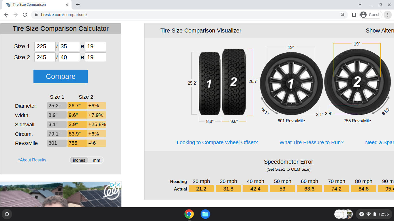

So to be clear, will the 245/40/R19 mechanically fit the vehicle?
I have seen elsewhere that at 245/45/R18 fits without issue on the MKII VRS models.
9 hours ago, Ootohere said:
BS i think.
Recalibration to suit the increased tyre size.
You are looking at the wrong size.
Go a smaller wheel to get a tyre with more sidewall and even rubber on the road, and no greater circumference.
Tyres / Wheel size that will not cause you issues, including fitting and then the Type / Approval and Insurance.

I was considering the 18” wheel with a 245/40/R18 which is only slightly taller thanks the OEM size?

zhz on the other thread, fitted his 245/45R18 to 7.5J rims. According to ETRTO, 245/40R19 need to be fitted to at least an 8" rim width, so will be at least 5mm wider than 245/45R18 fitted to 7.5J rims...as shown in the chart below.
Actual inflated width of tyres (measured from sidewall to sidewall, at the widest point)
225/50R17 fitted to 7Jx17 rims 233mm
245/45R18 fitted to 7.5Jx18 rims 237mm
245/40R19 fitted to 8Jx19 rims 242mm
245/40R19 fitted to 8.5Jx19 rims 248mm

On 17/11/2024 at 22:38, JackHenry said:
It’s less about comfort and more about stopping the alloys getting wrecked lol

The 19" Extreme rims are only 7.5" wide.
According to ETRTO, 235/35R19, 235/40R19, 245/35R19, and 245/40R19 need at least an 8" rim width.
According to ETRTO, 255/30R19 and 255/35R19 need at least an 8.5" rim width.
However, some owners have fitted 235/35R19 and 235/40R19 tyres to their 7.5" width rims...although this is against ETRTO's rules.
Skoda have never sold 19" rims for the Octavia MK3 that have a rim width of more than 7.5"...so 235/35R19 and 255/30R19 have never been approved by Skoda for fitment to this car...because Skoda along with all the other major car brands don't fit tyres to rim widths that aren't approved by ETRTO.
Edited by Carlston
I was considering the 18” wheel with a 245/40R18 which is only slightly taller than the OEM size?
245/40R18 needs at least an 8" rim width.
245/40R18 fitted to an 8Jx18 ET44 or 8Jx18 ET45 rim might fit the Octavia MK3...although there's always a risk of rubbing or the tyre sticking out of the wheelarch when pushing the limits.
245/40R18 has a slightly smaller outside diameter than the 17" Octavia MK3 Scout tyre, ie. 225/50R17...and has an actual inflated width of only 9mm more than this 17" tyre size, ie. 4.5mm more each side.
