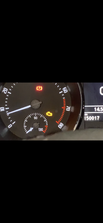

i'm in Australia and few moments ago my Yeti start giving me problems.
Call roadside assistance and the report from the fault it is:
"RAA gave report : Transmission DSG fault. Code P2841 present, drives and holds 1st gear before neutraling and revving high."
Any ideas? Anyone got same problem? if yes how much would cost the repair? just for me to have one idea cause I am not swimming in money...
Skoda Yeti front wheel drive engine petrol 1.2 Turbo year 2012  DSG gearbox automatic with 6 or 7 speed???

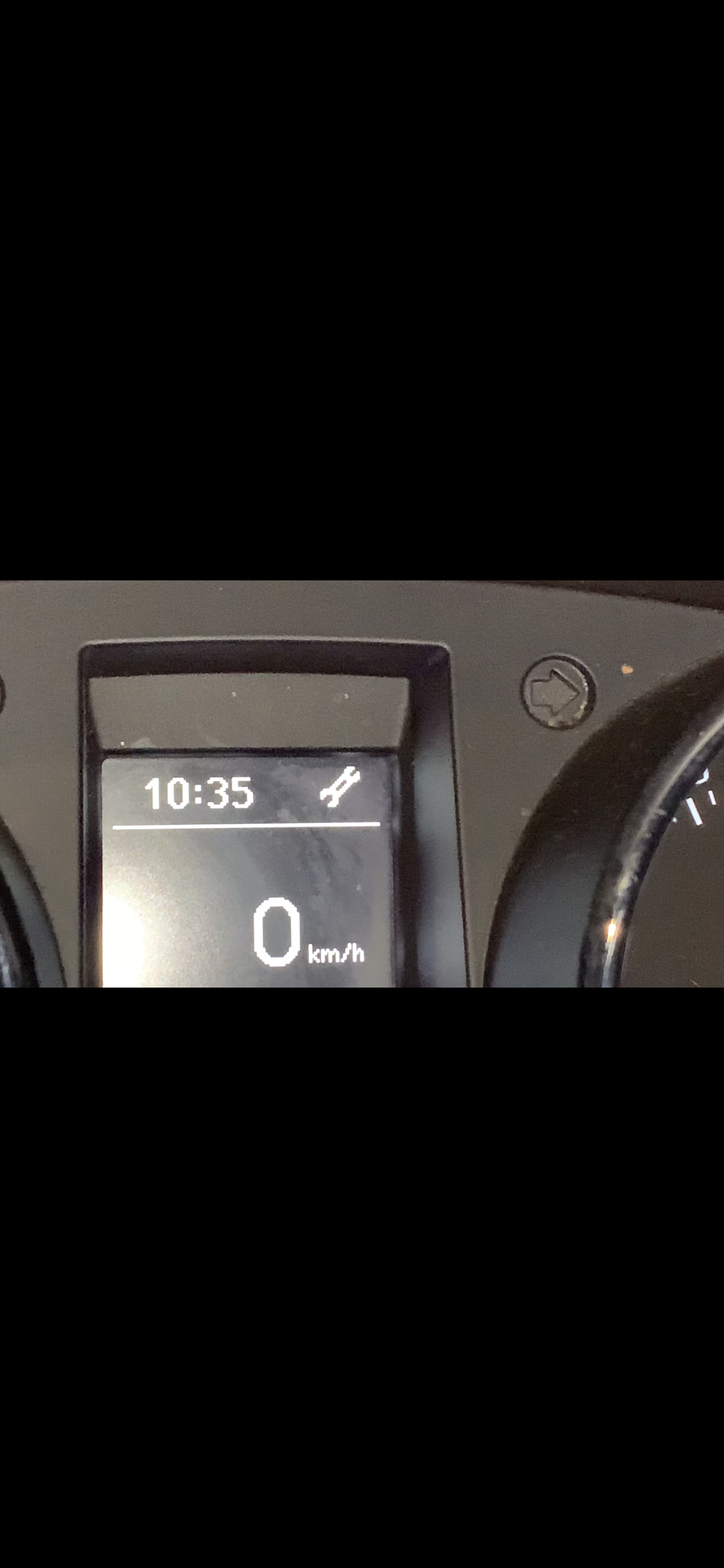

The yellow engine light always on and top right corner showing D1 and changing between D1 and an wrench 🔧 symbol.
I don't trust very much those guys from road assistance so I'm asking if someone else had the same problem...
I'll gonna Upload photos cause video more than 10MB.
Thanks for any help or suggestion.
