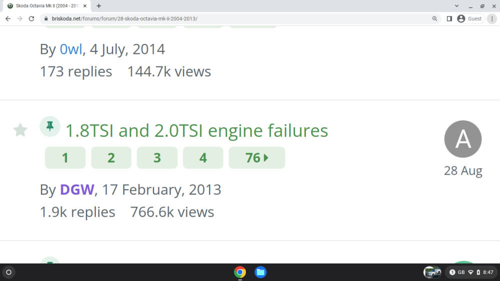

I can't seem to find this thread, don't suppose you could link me?
This is the link for ease of finding it.
