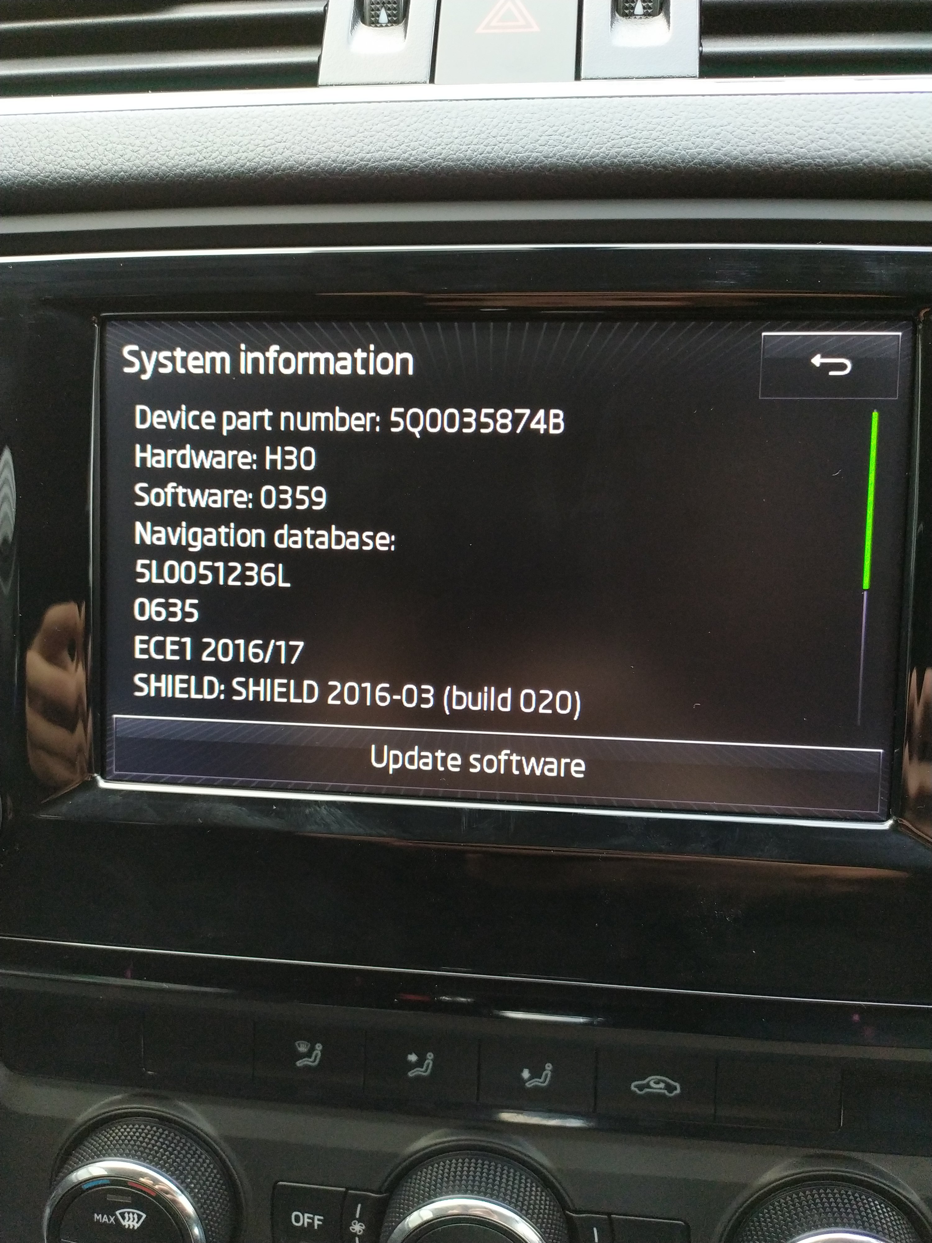

Also it is the older model screen. Ive read here its a straight swap for the 8" FL screen. But what model would i need? Ive attached some photos of the system info.

If it's MIB2 then any 8inch FL screen will work. MIB1 is different. Should be good to go with a 66 plate as the later system was fitted from 2015<

I think looking on here its an Amundsen MY17?
Which i think makes it mib2 (it has 2 sd slots)
There are a couple of versions of the screen ending in n or m i think, does it matter which one?

@SashaGrace would i be right in saying that i would need the 5E0919605 screen? And doesnit matter if it is N or M?
SmartLink was never standard on the PFL, but was built into the cost of the FL cars on all trim levels. You have a MIB2 Amundsen so the correct Amundsen FL display is 5E0919605M, the Bolero is the N model which has no NAV button. Will still work though, just no shortcut to the NAV from the screen. Aim for no more than £137 for SmartLink activation, £122 for the part and 15-20 mins labour.
