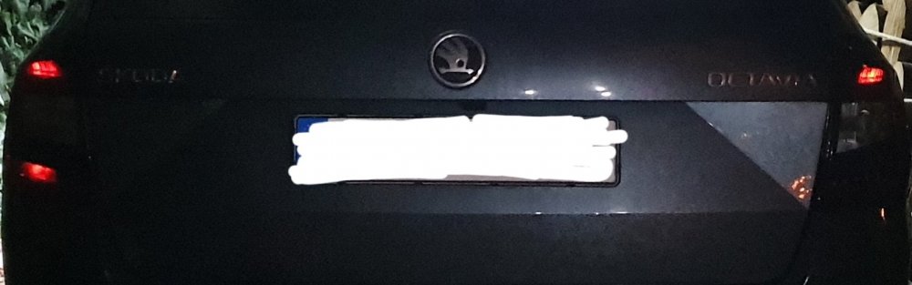

The brake lights and the left fog light glow lightly
Greetings,
I have been struggling for some time to see the brake lights and the left front fog light come on after replacing the vFL-LED taillights with the new FL-LED lights. The BCM does not want to "fall asleep" and the consumption is approx. 0.6 A until the BCM can finally "fall asleep" (10-60 minutes).
I tried to check the coding, replace the BCM and nothing helped, and I also found that the brake LED and the left fog lamp light up slightly while driving.
Did any of you run into this problem?
I notice that I have also activated the right fog light, which does not light up like this. It works the way it should.
I am attaching a photo of what it looks like when it shines. This is done when the car is locked with lights set to zero.
PS: I apologize for my English, it is not my mother language.
What coding have you changed?
@langers2k might have some advice here...
Edited by silver1011
I didn't changed anything at first. Then I realised that the fog light is now LED, so I changed it to 32 allgemeine LED bis 12W (I found that in facelift Octavia) and still had this problem.
And I also realised that I forgot to activate right fog light, so I changed it properly based on facelift Octavia UK. As you can see in the picture, the right fog light doesn't have the problem like left fog light and brake lights
In the old days problems like this were normally caused by a poor earth connection or water getting into the cluster - still worth checking
Yeah,
I checked that, but it looks like, that this is not the problem.
I found out, that if I have the pre-facelift LED lights (original with the car) or facelift Full-LED lights, locked car has in both options same quiescent current (which is around 0,28A). Normally cars with this interior and exterior features has around 0,15A.
