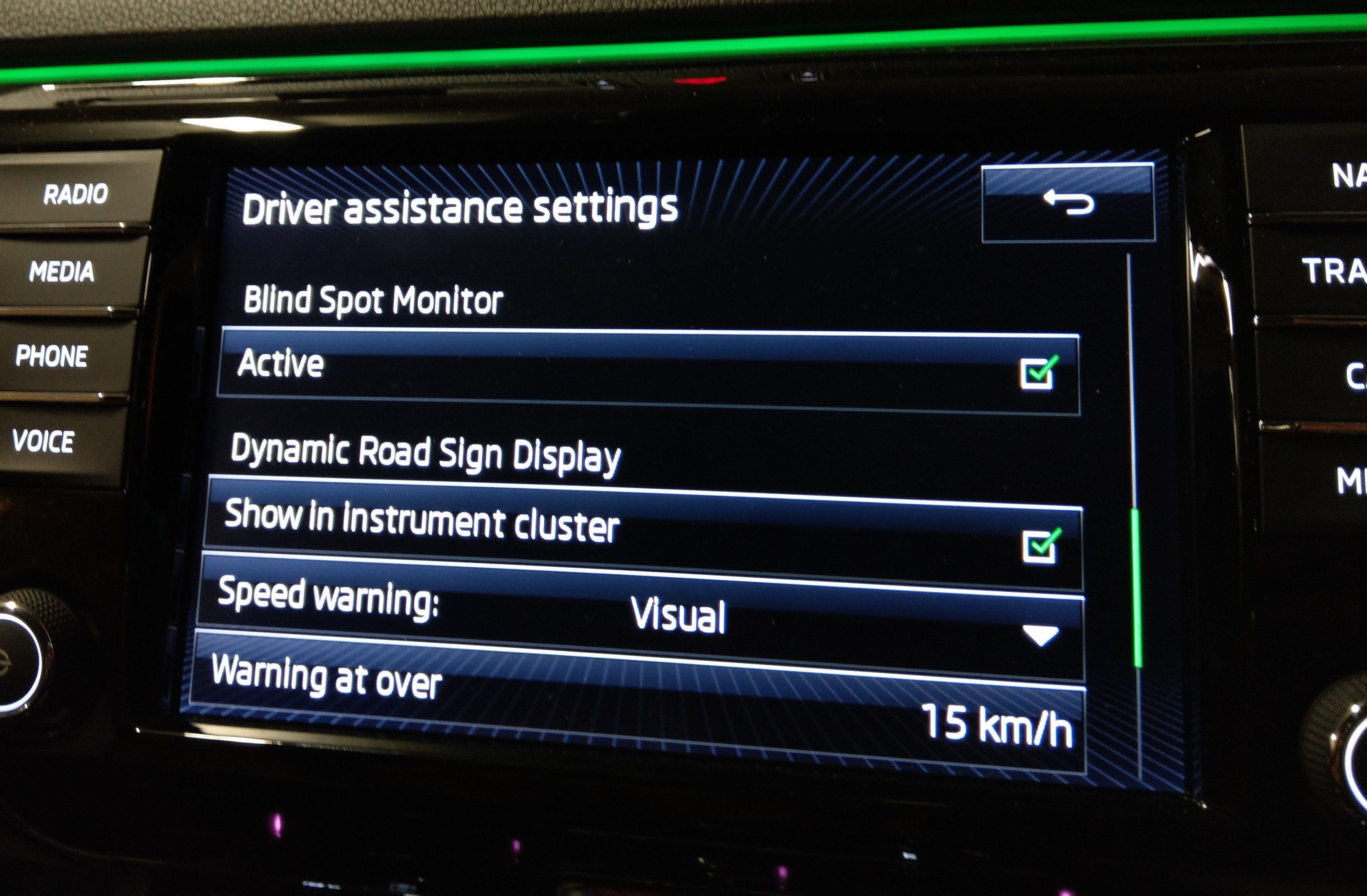

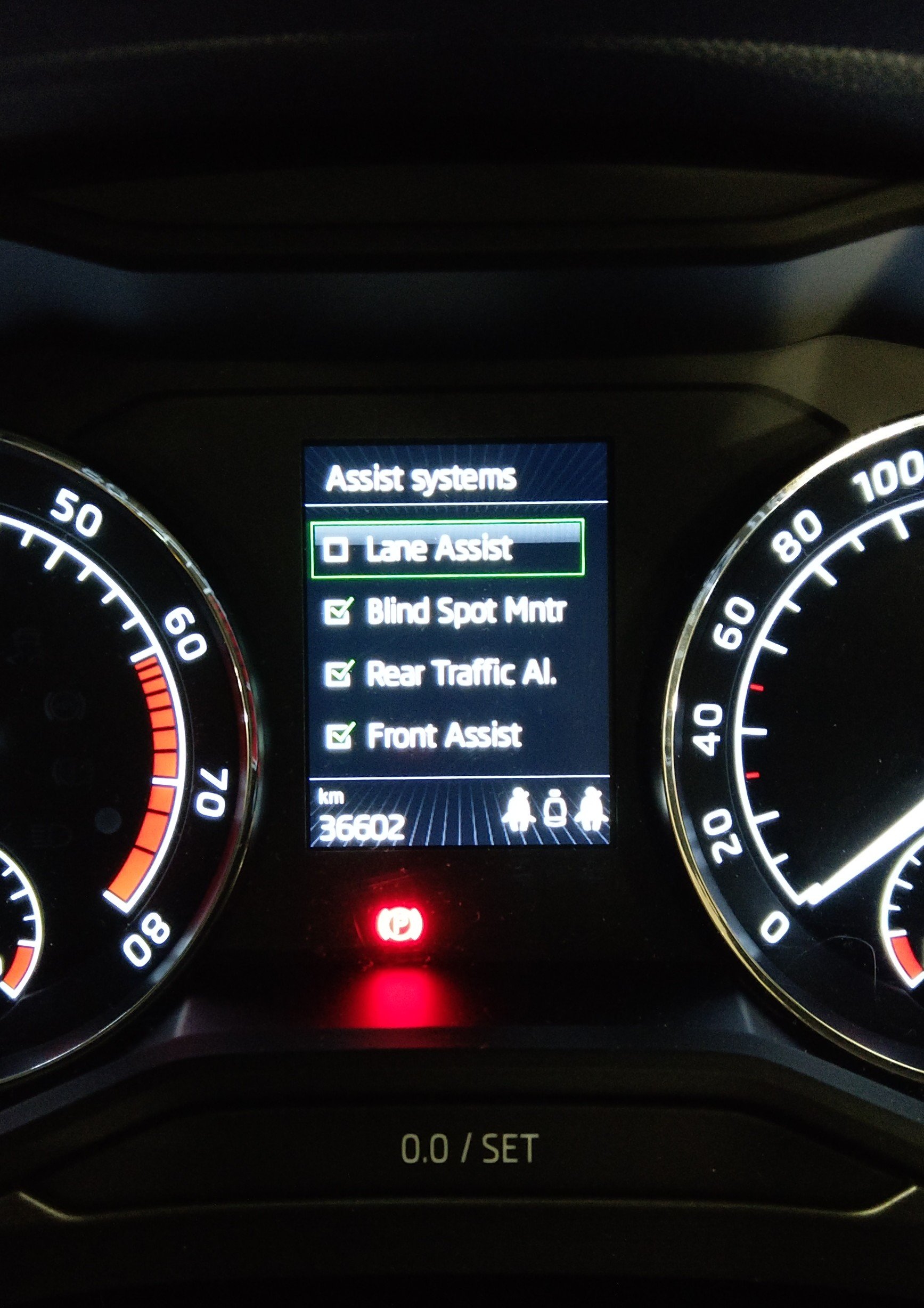

Blind spot detection, can be deactivated using the multifunction steering wheel buttons, if necessary. You'll then get a special display on the MOT. (Un)Tick what you (don't) need ;)
The Blind Spot menu, if fitted, is there in the Cluster and the Infotainment.
