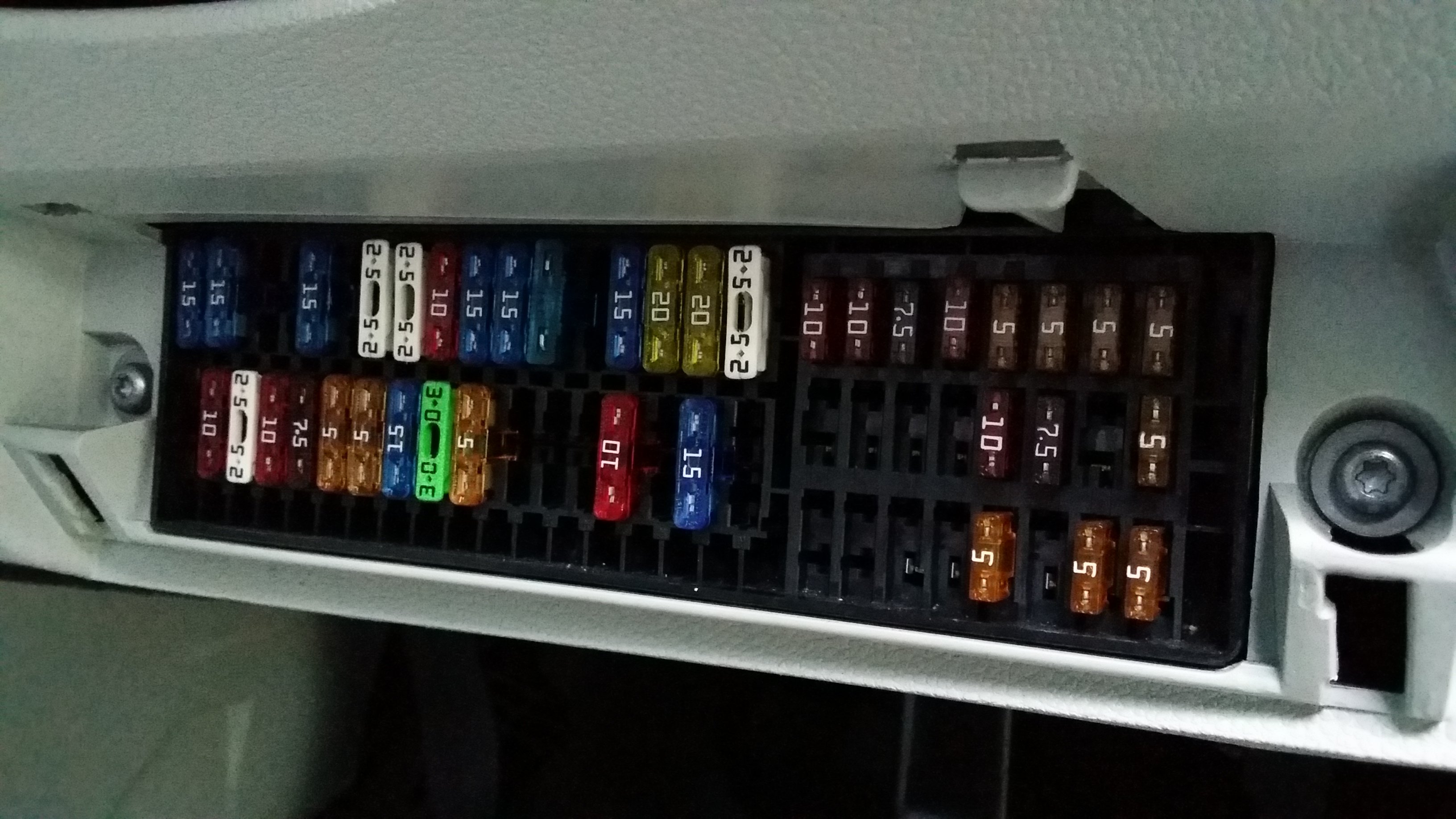

Indicator works. Left rear lights don't. Tested bulbs for continuity - through outer case & inner 'lump' on the bottom. Can't make head nor tail of fuses - panel diagram doesn't seem to correlate to what's there . What are the rear bulbs / lights called? parking lights? Thanks. Have tested each fuse in panel with multimeter except the extra large ones without the testing window.

PS: spin that sticker of fuse assignments 180° for a better match. No. 17 is the one, top right on your fusebox.

yes number plate works & fron tleft side light  - ok thanks top right - but it works anyway - dont have any of those smaller fuses - will need to get some
FIXED! In desperation gave a bang to the whole unit - suddenly it's working - on the upside I now know the fuse unit & how to remove the lights / bulbs etc. Also didn't realise there were 2 sizes of fuse - need to buy some of the mini ones (do they have a name??)

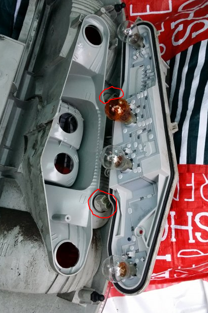

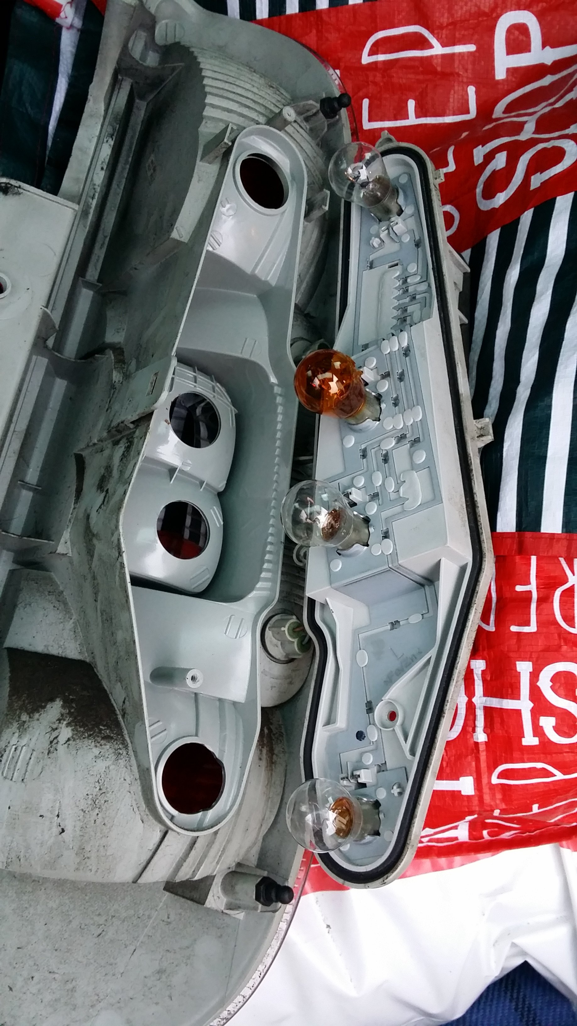

@MikeRoom, not sure if you spotted this during your testing, but the tail (parking) lights are these bulbs here (circled in red)...
They are difficult to spot (as they are on the MkII Octavia) and are regularly missed.
Either way, looks like it wasn't the bulbs but this might be useful for others.

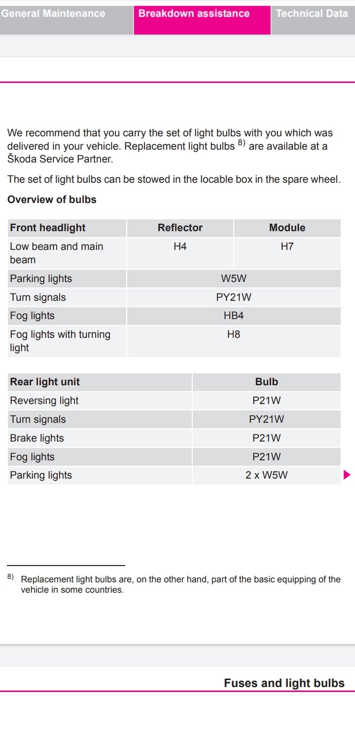

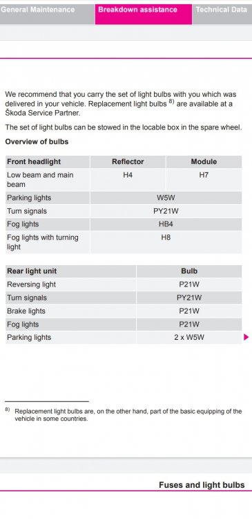

Crikey - no I had no idea there were bulbs there!!! Are they a standard bulb? I'll order some. Thanks silver1011
They are W5W...
On 31/12/2019 at 21:03, silver1011 said:
They are W5W...
Brilliant thanks very much silver
