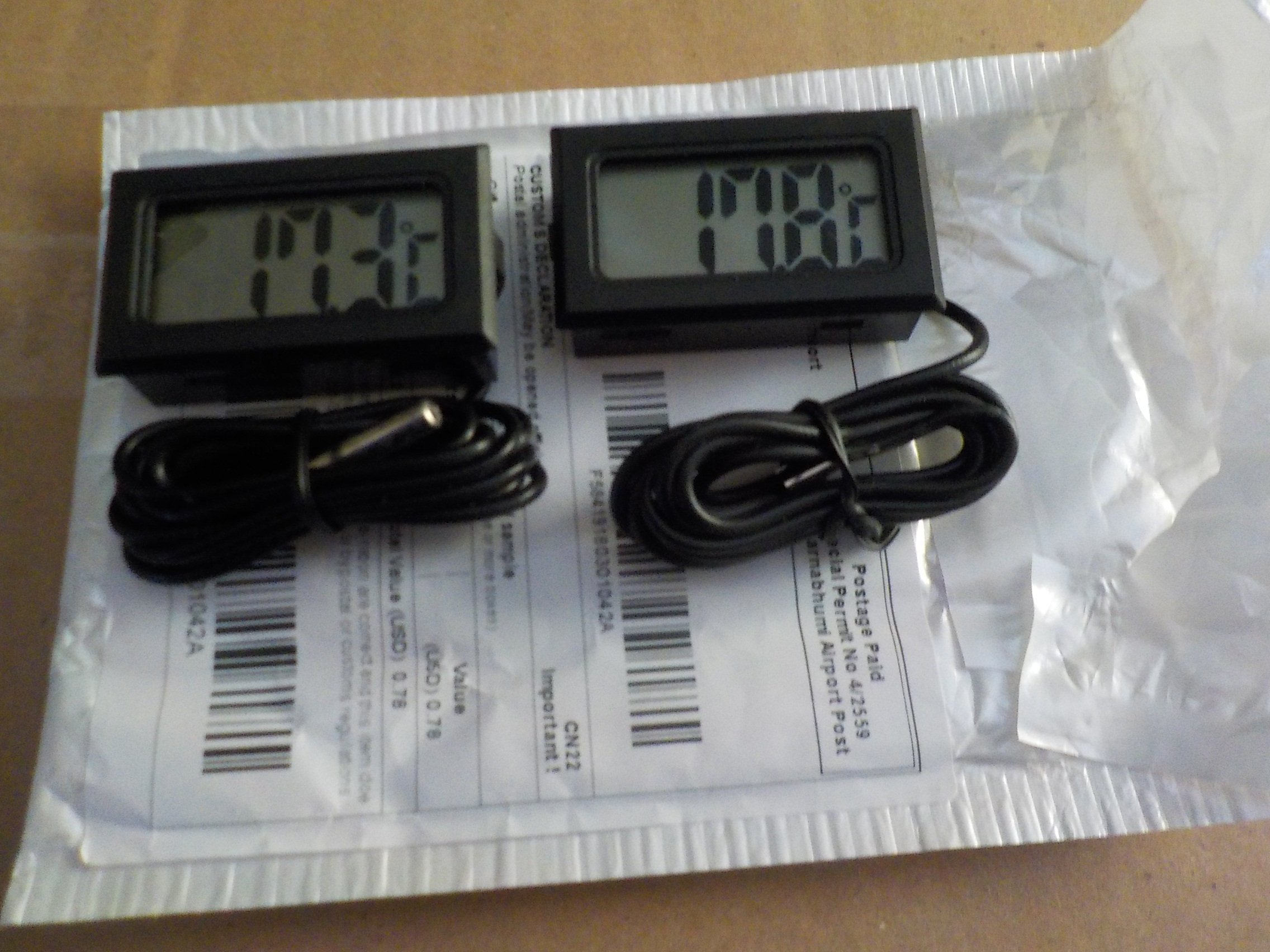

With a £1.99 digital fridge thermometer you can check the tyres temperature.  or the heat at the hub.

No real need for this, I know why the warning light comes on, the tyres have heated up and that is the only reason. It is far too sensitive on my Citigo 😞
