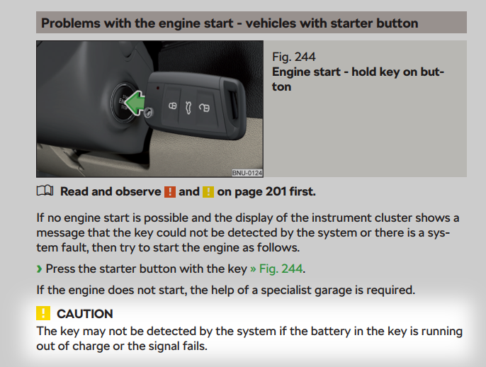

Unfortunately, that doesn't work for everyone. Even the manual says it's something to try.
Personally, I've had mixed results from that expedient. It sure must be attempted several times before giving up.
Edited by agedbriar
Interestingly other manuals say press the button then place the back of the fob on the button...   Might be something different to try and probably depends on where the transponder is within the key.
