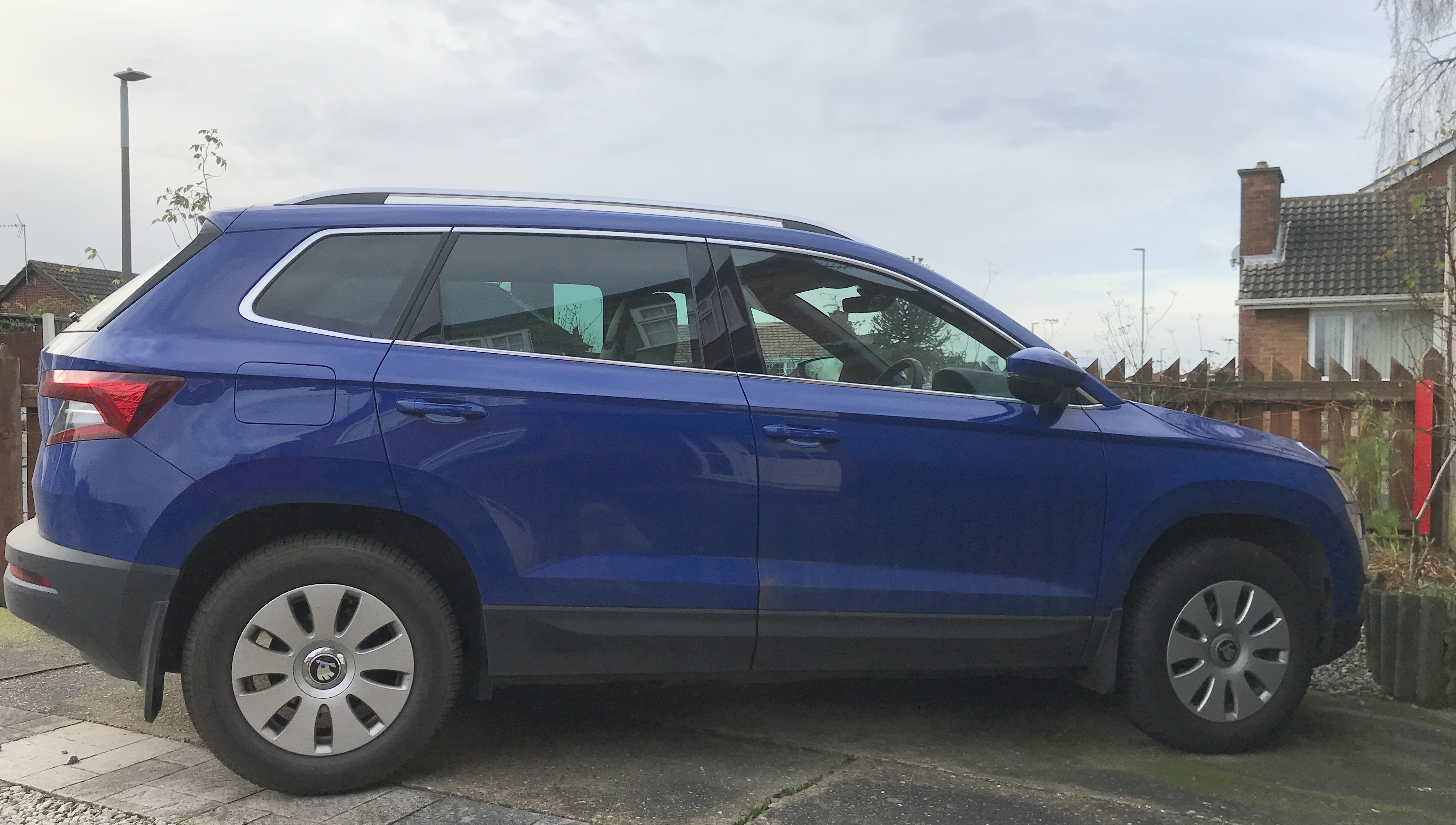

Here's our Karoq wearing its winter wheels and tyres - Michelin Cross-climates.

No offense but I'd rather do a Van Gogh and cut off my ear than drive around on wheels that look like that.  :D
No offence taken........Austerity Blue and my 13 year old Audi alloys fitted with tyres that shrug off kerbs.....little point in making it look too smart......☺️
They have a massive advantage over most modern Skoda alloys because they appear to be really easy to clean.:thumbup:
Its not so much easier to clean as they just dont get dirty from brake dust.
I have had steel winter wheels, genuine OE with Skoda hubcaps (bought on this forum) on the car for a couple of months and whilst the car is filthy with road dirt the wheels are pretty much spotless, its usually the other way round.
