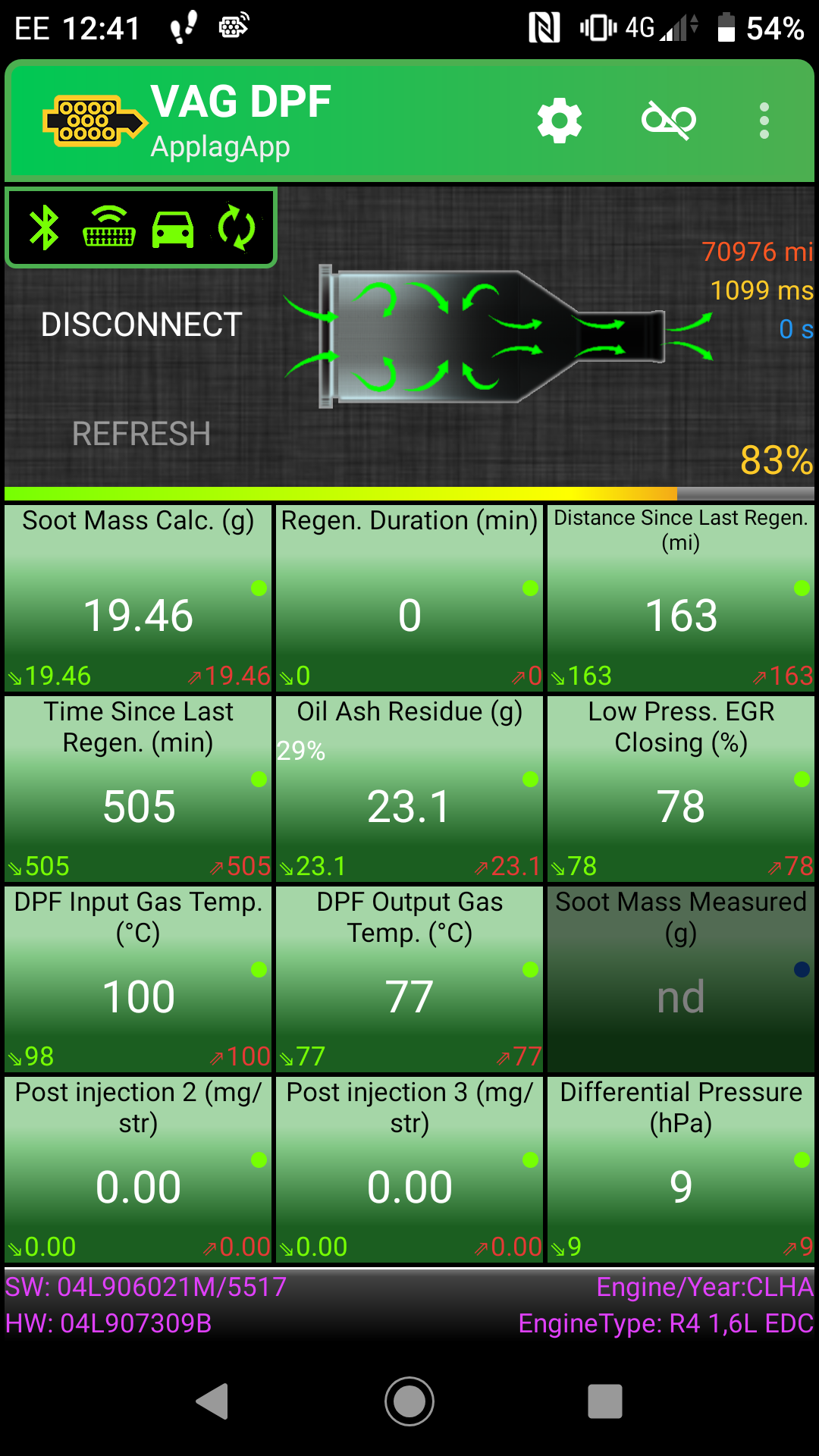

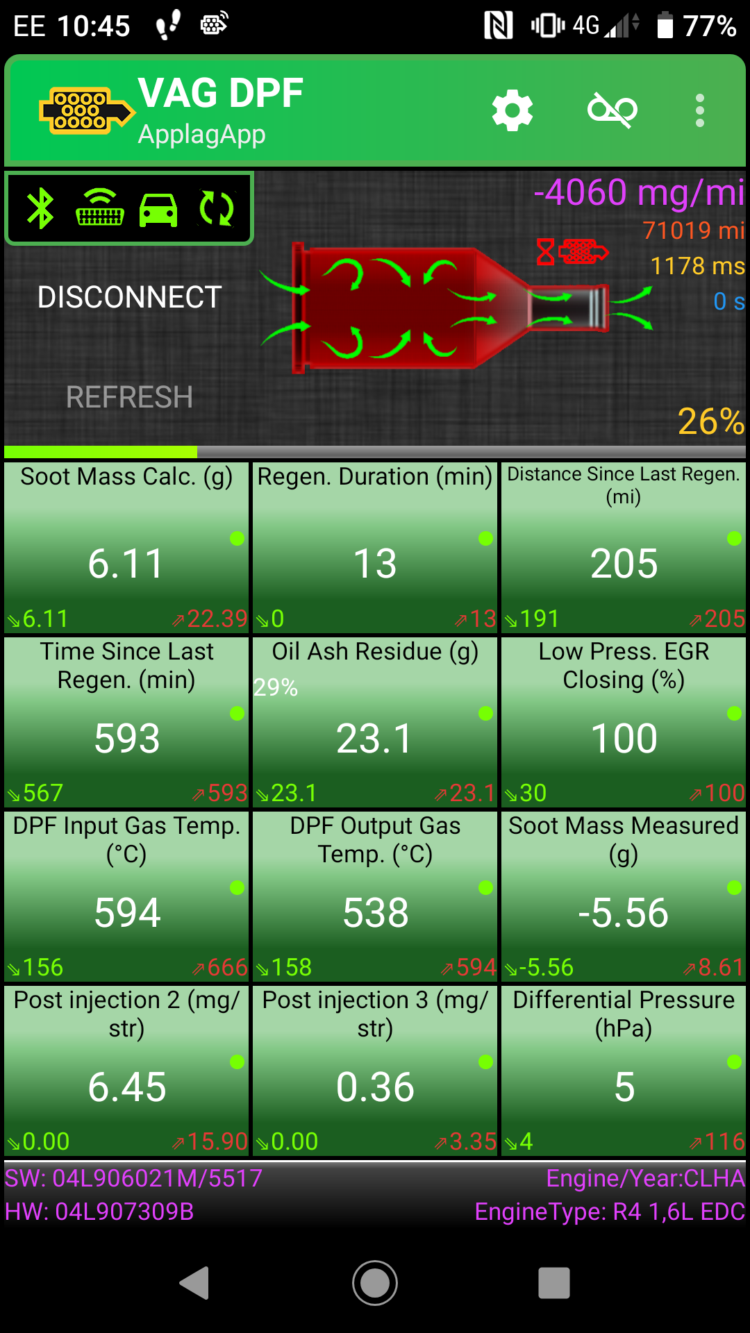

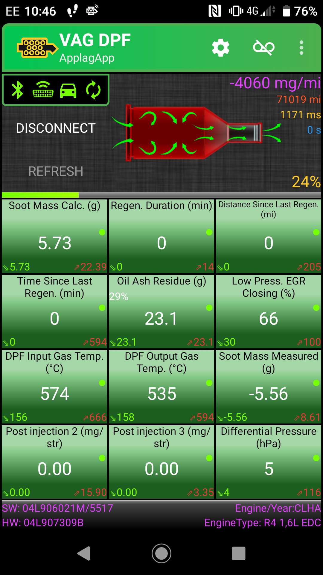

Anyway today took it out for a long drive to get a dpf regen done.
When we picked it up yesterday it was at 83%
The regen kicked in at around 95%
And stopped at 24%
I've also ordered a set of genuine skoda rubber floor mats.
Could you explain the above pictures please? Just out of curiosity - if you don't mind!
They're screen shots from an android app called vag dpf. It gives a readout of all the variables for the dpf including soot content and oil ash residue, the oil ash give you an idea of the life left. As the soot is burned off during a regeneration small amounts of it that can't be burned off are left and eventually fill the dpf to a point where it will need replacing. Mine is currently on 23g or 29% full at 71k miles so theoretically if it rises at the same rate it should be 200k before I need to replace it.
Thanks very much for the explanation - very informative!

I understand that an active regen should be triggered when the soot level reaches 45%, and further attempts will be made if it is not completed. The VAG DPF data from the OP starting with a soot level of 83% would suggest that a number of incomplete regens occurred before he took possession of the car, but he has successfully got it down to 24%.
My reasoning for triggering a regen was with it being sat of a forecourt for however many moths and an almost full dpf, I just wanted a clean slate so to put it to start with.

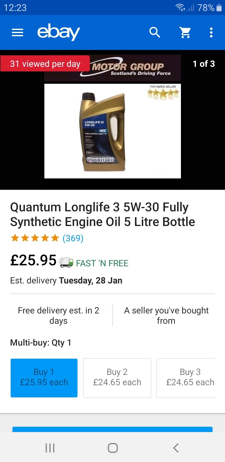

If you're not bothered by premium brands for oil, then VAG'S own VW507.00 oil from Fuch's can be found for a lot less than the Castrol...
Passat is well dead, and though the best part of £30 worth of bp ultimate diesel would be better in the octavia than in the scrap man's car.
Thats the same stuff I used in our passat but the castrol edge stuff was only £28 with free next day delivery so went with that.
Funnily enough from the same place.
https://rover.ebay.com/rover/0/0/0?mpre=https%3A%2F%2Fwww.ebay.co.uk%2Fulk%2Fitm%2F223598844670
Although I've noticed the price of the vag brand stuff has been slowly rising, last time I bought it it was £24 and the time before that £20.
