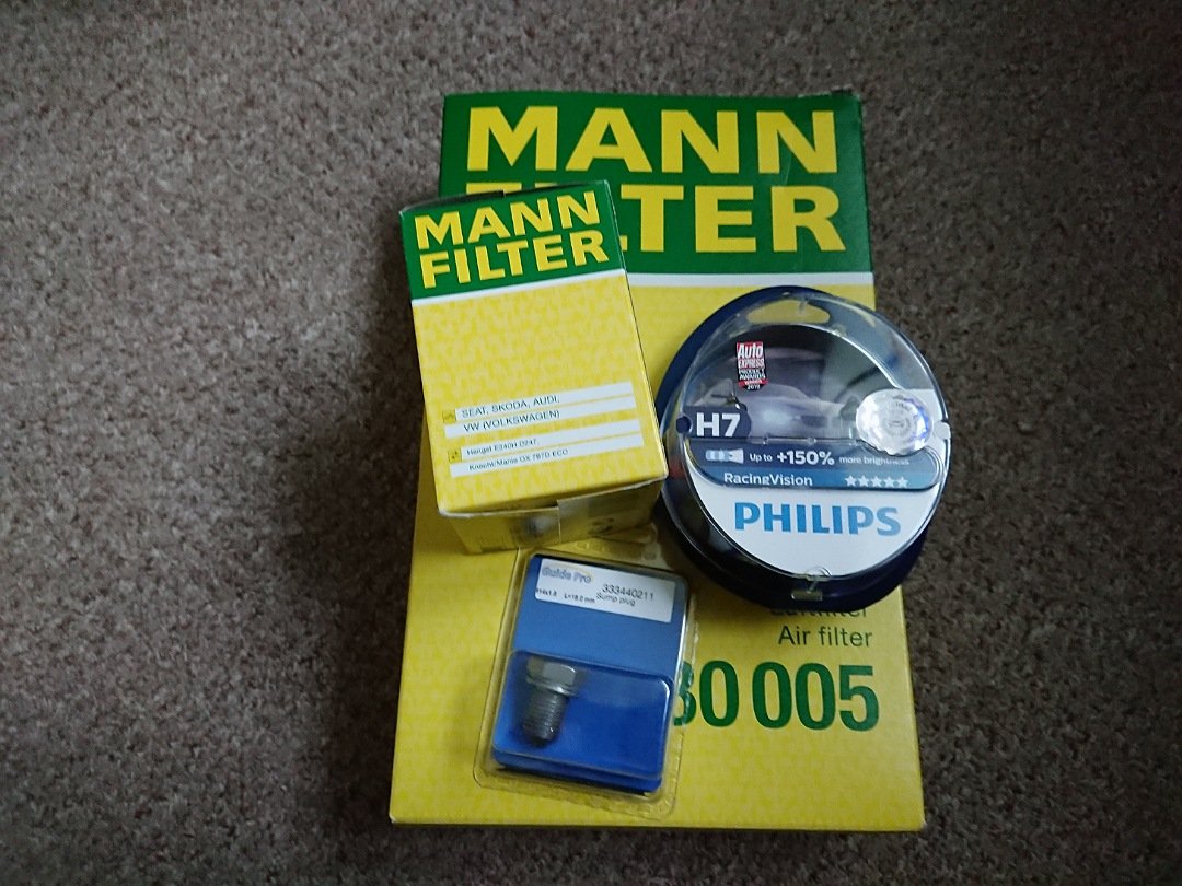

Well I'm all ready for when the weather gets better. Also while I was out ecp had some philips 150% bulbs on for £20 so thought I'd give them a go.

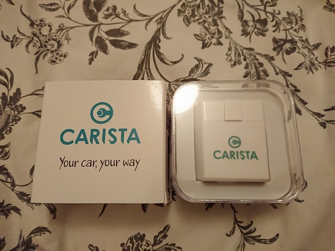

This arrived today.
IMG_30012020_172821_(1080_x_810_pixel).thumb.jpg.cb07ac20306ef7bf26abb200a399f2bd.jpg

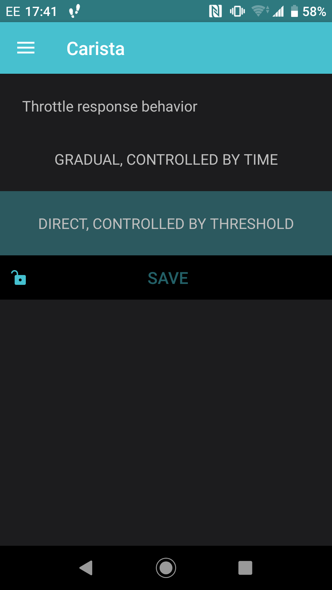

Having read through a few of the adaptations posts there's a few things I'd like to try out this weekend.
I had a play with the carista plug and app this evening.
I changed the throttle response setting which has definitely improved throttle response. (funnily enough)
Ive also enebled the directional fog lights when turning, last fill up amount in the maxi dot screen and a few other bits and pieces.
To be honest I feel the app is a bit basic, good for a beginner but lacking for more experienced users. I'm probably going to look at getting the obdeleven plug as well for the long coding.

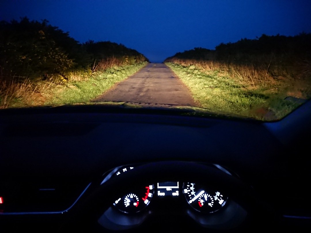

So, I finally got around to fitting fitting the new bulbs.
Before.
IMG_01022020_175758_(1080_x_810_pixel).thumb.jpg.1aee69ca8ea745707c678a0cbfd176a6.jpg
After.
IMG_01022020_175809_(1080_x_810_pixel).thumb.jpg.e734a6698a5a985dea72ad9739e922b2.jpg
For some reason my phone camera makes the old bulbs look very yellow and the new bulbs very white. Realistically there isn't that much colour difference but the new bulbs have improved things.

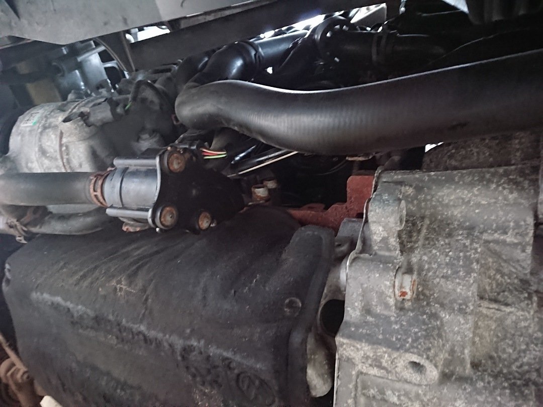

Also while tinkering a changed the oil and filter and air filter.
IMG_01022020_175859_(1080_x_810_pixel).thumb.jpg.8553562195cde59f2b048d681f409b8d.jpg
I spent a good 10 minutes looking for the oil filter housing, expecting it to be under the bonnet facing upwards. Turns out its underneath hidden behind wires and pipes.
IMG_01022020_175907_(1080_x_810_pixel).thumb.jpg.03d251aa15e26eb817aeef83eb7a1bd2.jpg

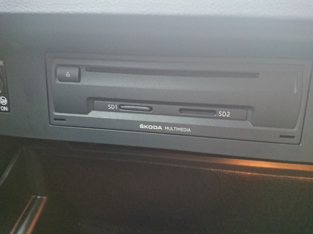

I updated the maps on the amundsen this afternoon.
After a few hiccups I finally got there. I had bought a new sd card but no matter how I formatted it, it just wouldn't recognise it. So ended up formatting the original skoda sd car and putting the new map files on that.
IMG_08022020_165415_(1080_x_810_pixel).thumb.jpg.05051b3824a582ff62fb1c4fabdda7e3.jpg
Unfortunately after checking the website again it appears there's a new version of the maps since I downloaded them a few weeks back 😢
The Amundsen requires a genuine Skoda SD card as it has embedded security data that the Amundsen checks for.
I noticed a couple of days ago that the Skoda portal is (finally) showing the 2020 maps (at least for my MIBq Amundsen), but I've been running the 2020 maps for several months by downloading them from the VW website :thumbup:
