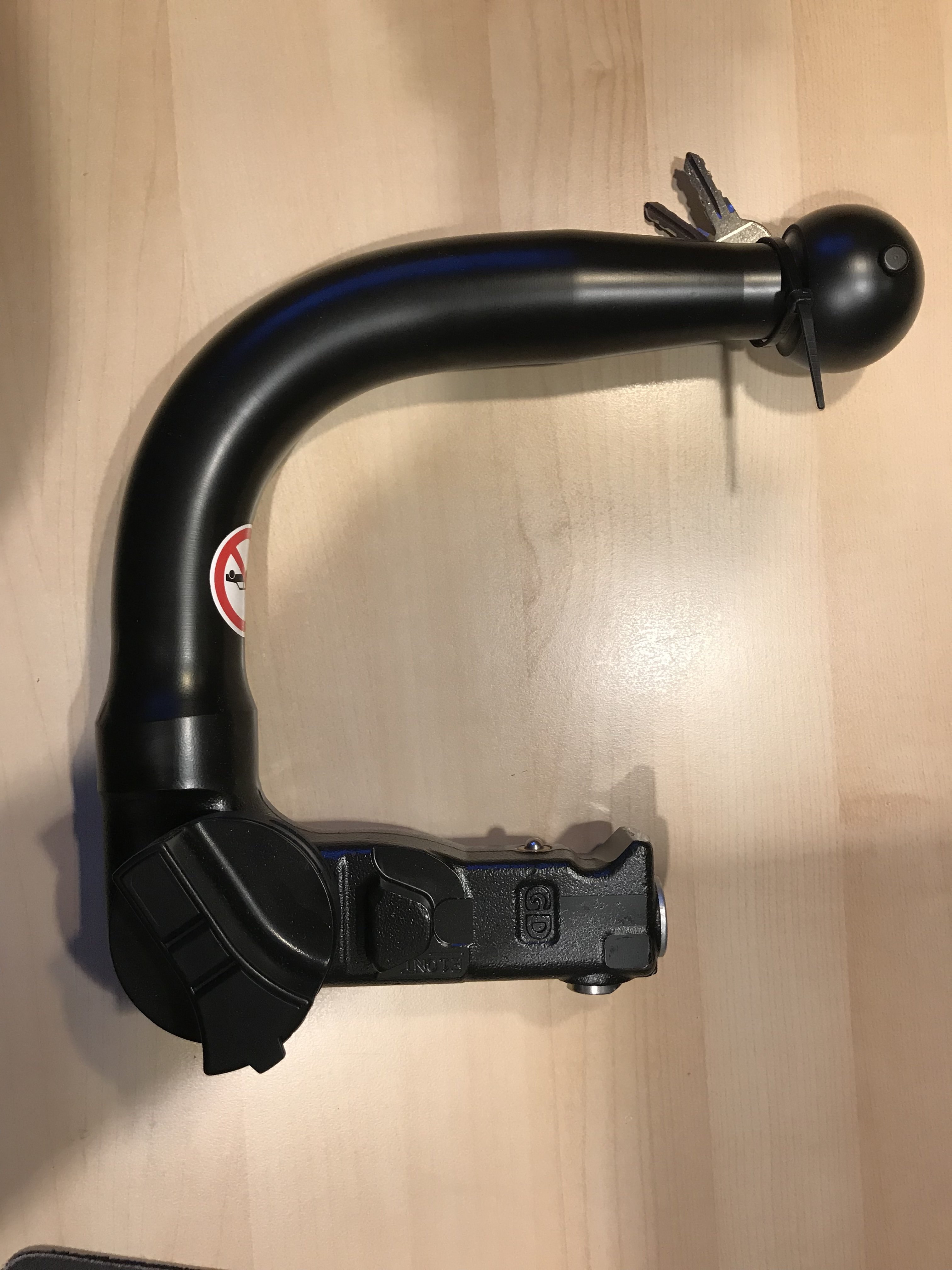

When I bought my BMW 2-Series Gran Tourer a few years ago, I spent quite a bit of time looking at cycle carrier options. The BMW dealer strongly advised against using any kind of tailgate-mounted cycle carriers. He said that there’s too much risk of damage to modern tailgates, which often have plastic parts (eg. the spoiler / wind deflector at the top of the tailgate) which cannot withstand the force exerted by the taught straps of a cycle carrier. He said that even steel tailgates are now often made of thinner steel than in the past. He claimed to have had a customer who managed to bend/deform the edges of their tailgate by tightening their cycle carrier straps too tight - it seems a bit far-fetched to me, but who knows........
I ended up going with a towbar-mounted cycle carrier. Fortunately, one of the BMW factory-mounted options was a “cycle carrier preparation”, which basically looks like a removable towball but it’s only rated for a cycle carrier, not actual towing, and it was about 1/3 of the cost of a full towbar solution. I never did manage to find out whether there was really any difference between this “cycle carrier preparation” and the full towbar solution, because the metalwork underneath the car looked identical for both options......

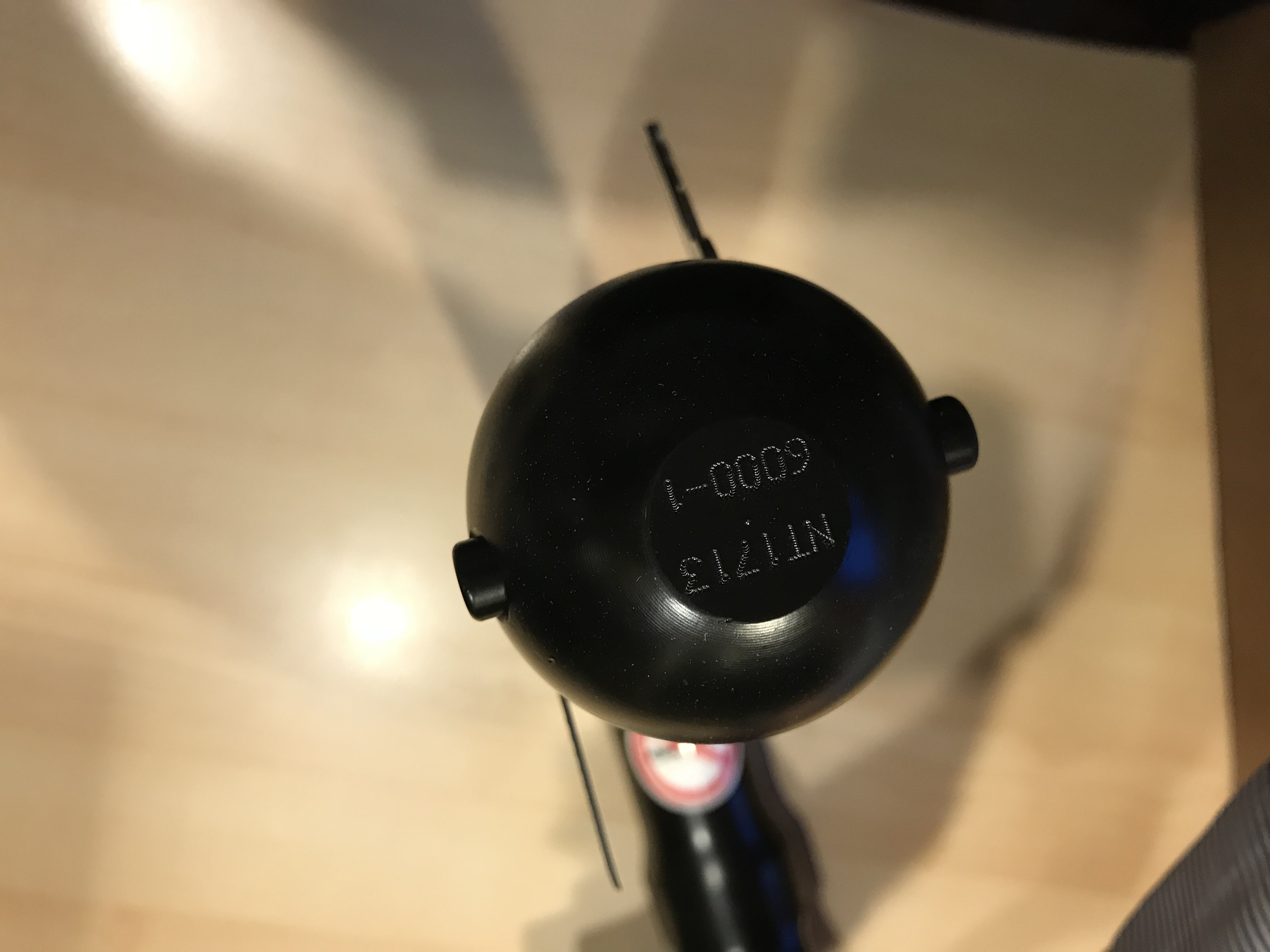

It’s a shame the car manufacturers can’t come up with some kind of standard fitting method for cycle carriers which is cheaper and less hassle than a full tow bar solution. I saw one which BMW did for a Mini in the past where the cycle carrier had 2 long arms that fitted into what looked like 2 standard tow loops. Instead of having a single tow loop on one side of the car, they had added a second one on the other side of the car.
I know this is a Skoda forum. But for anybody who is thinking of getting a BMW who wants to be able to carry bikes but doesn’t plan to do any actual towing, I found the “cycle carrier preparation” on my 2-Series Gran Tourer (7-seater people carrier) pretty good. But you can only get this when you order the car, not as an after-market solution. It cost me about £260, and it included all the electrical wiring and connection point for the lighting/numberplate board, and all the metalwork underneath the car where the removable towball is attached. The removable towball itself is available as an aftermarket BMW purchase, and I paid about £90 for it. The only downside is that there may be some cycle carriers which don’t fit onto this towball. The towball is not a standard, completely spherical design. It has a protrusion on each side - it looks like a hole has been drilled through the centre of the towball and a metal rod inserted through it. I have  attached a couple of photos. I couldn’t figure out whether this was to provide additional stability to the cycle carrier (to prevent it twisting around) or whether it was something which BMW did just to force you to buy one of their own OEM cycle carriers (which cost about twice as much as a Thule carrier). In the end, I managed to get a second hand BMW OEM cycle carrier for about half the new price, and it’s rated to carry up to 2 electric bikes. There’s also an optional 3rd rail which you can add on afterwards, if you need to carry 3 bikes.
The “pin” is probably there to stop you using it to tow a trailer or caravan.
Before we got the Karoq we looked at a Kia Niro hybrid. Found out it was not type approved for towing although you could have a towbar fitted as long as it was only used for mounting a bike rack.
