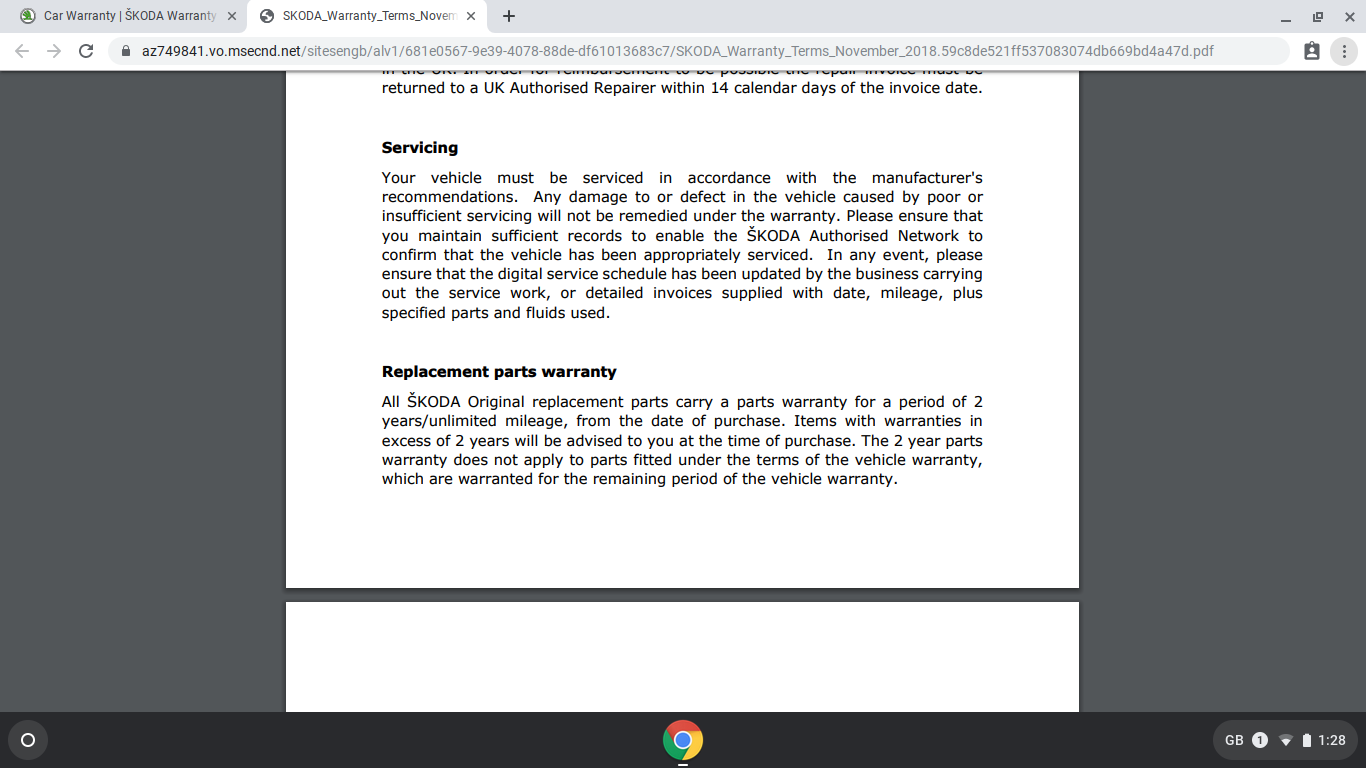

Best get Skoda UK Customer Services to check with the Technical Department and put it in writing to you the Service Schedule.
 Also get a Dealership to show you in writing the Service Interval now that is a Schedule or a Guideline.

SKODA_Warranty_Terms_November_2018.59c8de521ff537083074db669bd4a47d.pdf

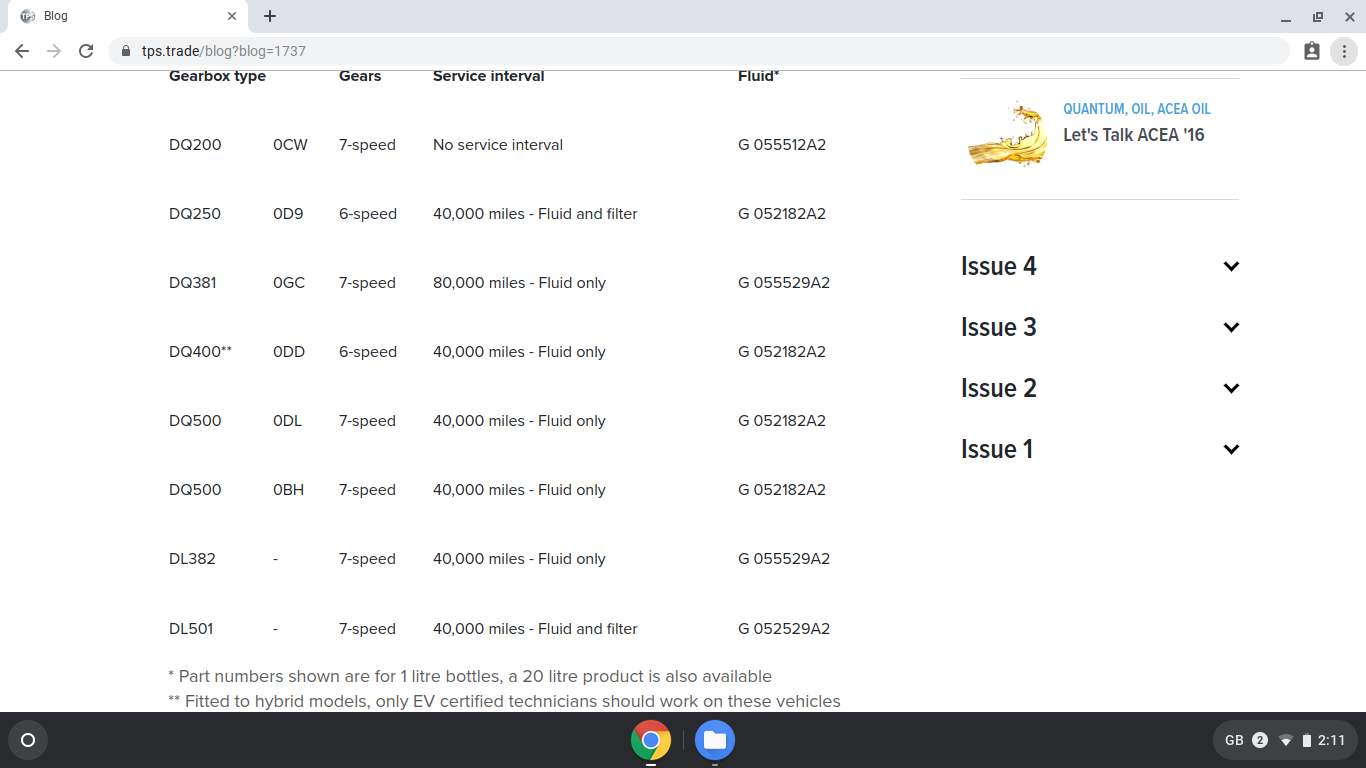

DSG can be sealed for life (no service), 38k or 80k for the skoda superb MK III, depending on the engine variant you have.
Assuming it requires a service and is not sealed for life, it's 38k, unless it's one of these newer engines which is an 80k service. 80k service required on the following:
2.0 TDI CR 7 Speed Automatic DSG DFGA 150 BHP
2.0 TDI CR 7 Speed Automatic DSG DFHA 190 BHP
2.0 T FSI 7 Speed Automatic DSG DNUA 272 BHP
2.0 T FSI 7 Speed Automatic DSG DKZA 190 BHP
2.0 TDI CR 7 Speed Automatic DSG DSRB 150 BHP
Edited by Wardy-
The only 'Sealed for life DSG from VW Group are DQ200 7 Speed Twin Dry Clutch DSG 2009-2020.
They are no more than 192 PS & 250 Nm Toque.  so 1.0, 1.2, 1.4 or 1.5  or 1.8 TSi FWD or 1.4 or 1.6 TDI's
Then when VW Group do a World Wide Recall or Service Campaign as they did 2012-2014 then they might change the oil.
38,000 mile is what Audi say on s-tronics,  (Same as a DSG)  VW / Skoda / SEAT say 40,000 miles.
& the 80,000 mile thing is appearing now.
**** See DQ381 *****

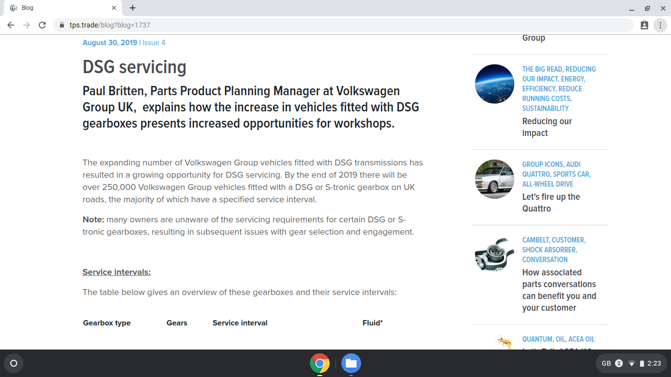

http://tps.trade/blog?blog=1737

Based on that variant; If it's the 6 speed auto, then it's 40k. If it's the 7 speed auto, then it's 80k
