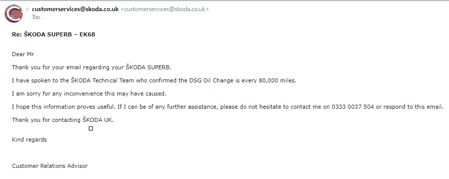

I've now received a response from Skoda Customer Services confirming it is going to be at 80k

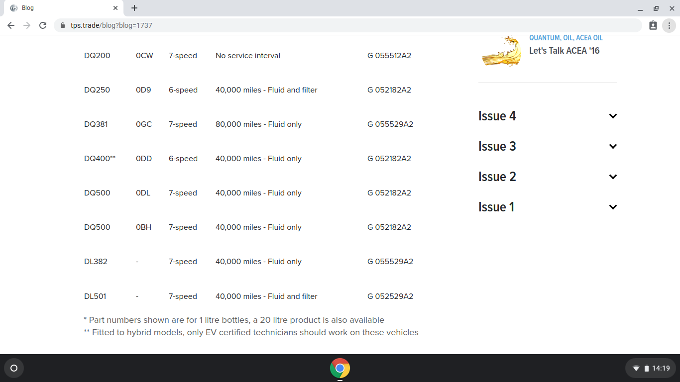

What is the code of the DSG that conformation from Skoda UK is talking about?
No code mentioned, I gave them the car reg.
How can I find out this code myself? and I will update this thread once I pickup the car tomorrow..
So about as much use to others as a VW Group Owners manual.
Fire off another Email and ask, is it a DQ380 DSG you are confirming has a Scheduled Oil Change at 80,000 miles and is it just Fluid or Fluid & Filter.
They might as well do something for a living as well as knock back Warranty claims.

They've come back saying it's a DQ381 scheduled oil change for transmission oil only.

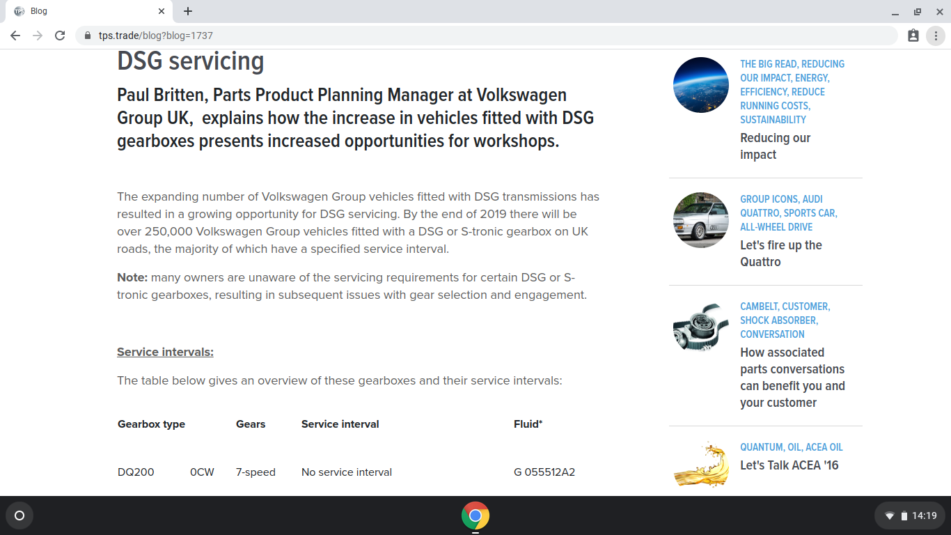

I’ve actually met Paul a few times 😁
