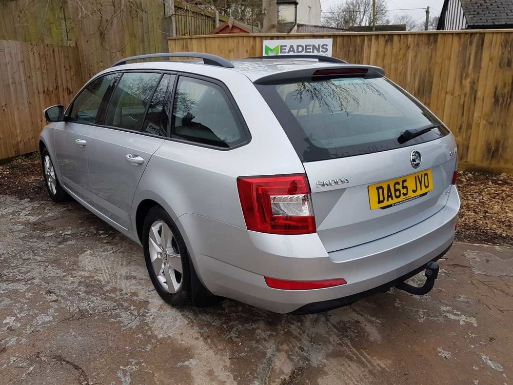

Wanted a towbar with a bumper protector plate   not like the one above

Yes you can get normal type bolt on "fixed" towbars, I have just fitted one to my Yeti, they are called "flange fit" or "flange type" IIRC.
I use a drop plate for my various trailers & a bumper protection plate, I also use a towball that has a coupling pin integrated for towing a site trailer.
The flange part is interchangeable with a swan neck hitch & in theory could be unbolted & only fitted when needed (electrics would have to be secured away somewhere) but in practice once the bumper is fitted you cannot access the fixings s make sure they are good & tight!
One (for me) great advantage is that its the closest fitting towbar I have ever had, very little projection and fits really snugly against the bumper (requires either the bolts cut to length or clearance holes in the bumper panel), the swan neck ones as illustrated stick out a very long way and now I have just become blind in one eye I would be barking my shins all the time.
