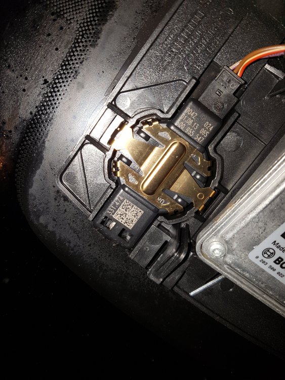

I shall have a look... Whats the best way to tell? Can I see off the original component without taking it all out? I'll have to have a look at how my mirror assembly comes apart. Thanks for the help!
I've ordered an A, and guessing mine is probably an A anyway as its a 2013 car.

you can tell via obd11, to which I can tell you how (if you have obd11) or the other way is to disassemble the rear view mirror, turn it anti-clockwise with a little pull down & it should drop down (if I remember correctly) then use some flat plastic blades to unclip the black housing, you will then see the sensor to the left, you might have to just slightly open the retainer clip either side in-order for the sensor to come away but be careful of the gel pad on the sensor that is then on the windscreen, let the air get at the gel pad for a few mins & that will come away easy enough, unplug the plug from the sensor & on the back of the sensor will be the part number, you might not have an (A) (B) or (C) if 2013 vehicle, it might just be the part number but replace it for the same part number & it doesn't matter if the new part number has (A) (B) or (C) at the end of it, just as long as the part number is a match, number for number, letter for letter. B)

On 02/12/2020 at 14:41, BATVANVRS said:
Ah bugger, looks like it's a 547,but not with any letter now I've finally got round to doing the job!
Edited by Mikebham
Any pointers in getting the brass retaining clip off though, I can't seem to get that bit to come away at all!
Edit... Finally pinged off
Edited by Mikebham
I used a flat screwdriver (very thin on) to just open up the clips either side, you will see it  hear it ping open.
Fitting everything back is the same process but just in reverse order. sensor 1st & don't forget to plug the wires back in, the plastic housing, then the mirror but at this point I might of done the mirror then the plastic housing, you will see so either way will work. (Mirror will be clockwise upon fitting) & don't forget the mirror has a button underneath so make sure a green light is on.
