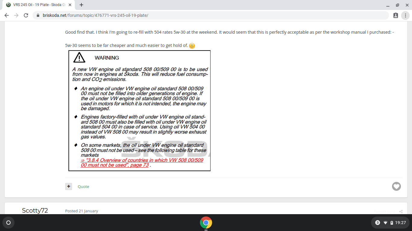

*. My  19 plate 245 Vrs has just had its 1st service and the dealer has used  508.00 0w-20 oil which is the correct spec for this car. The service manager seems to be on the ball and explained the importance of using the correct oil spec.  If for some reason the engine goes pop and you are trying to claim on the warranty they might carry out an Oil test. With the correct equipment they can tell the spec of oil used and if it's found to be incorrect this will void the warranty
What's your point when it's already been stated and officially shown on this thread that you can optionally use 504 spec oil instead. Only difference it will make according to VW is higher emissions.
As per the above, you can use 502, 504 or 508 in your vRS 245. I just changed my oil from the factory water like 508 to 504 spec.
After researching this further I may even swap it in a few thousand miles to 502 spec for even greater engine protection. 502 will offer better protection and lubrication long term especially if we get a warm summer.
I plan on changing my oil every 4-5000 miles. The oil was filthy black even after 5400 miles from new with the 0w-20. I dread to think what it would look like after 20k if I stick to the variable servicing.
VW definitely don’t care as much about the motor in my car as I do. Their interest is to sell you a new car.
My point is that Quoting the Oil spec from the handbook, 508.00 oil is the correct spec oil for the 245 Vrs.
