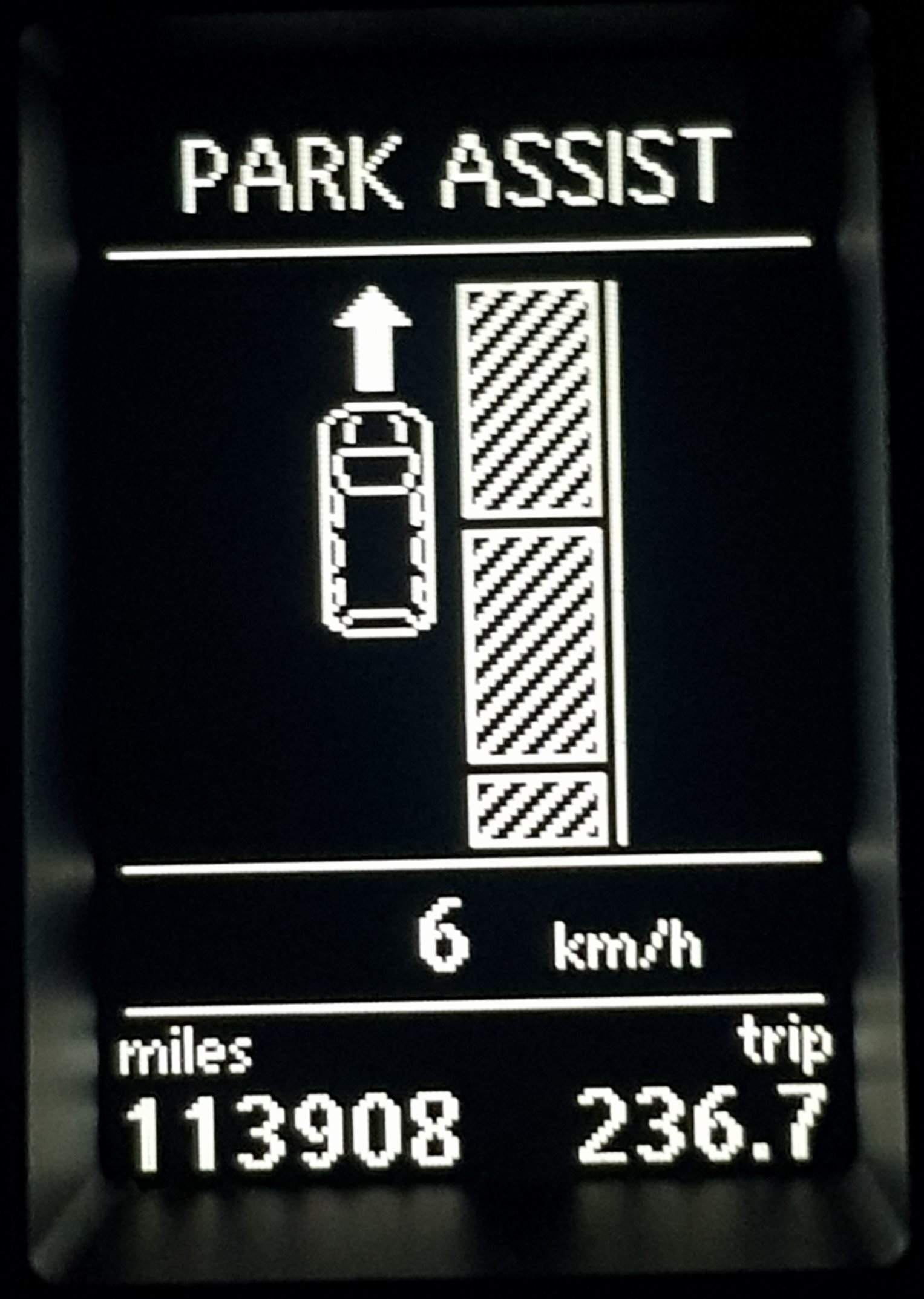

When park assist is switched on, the matrix should show the line of parked cars on the LEFT of the display as default.
Mine however is defaulted to show the line of parked cars on the RIGHT as shown below.

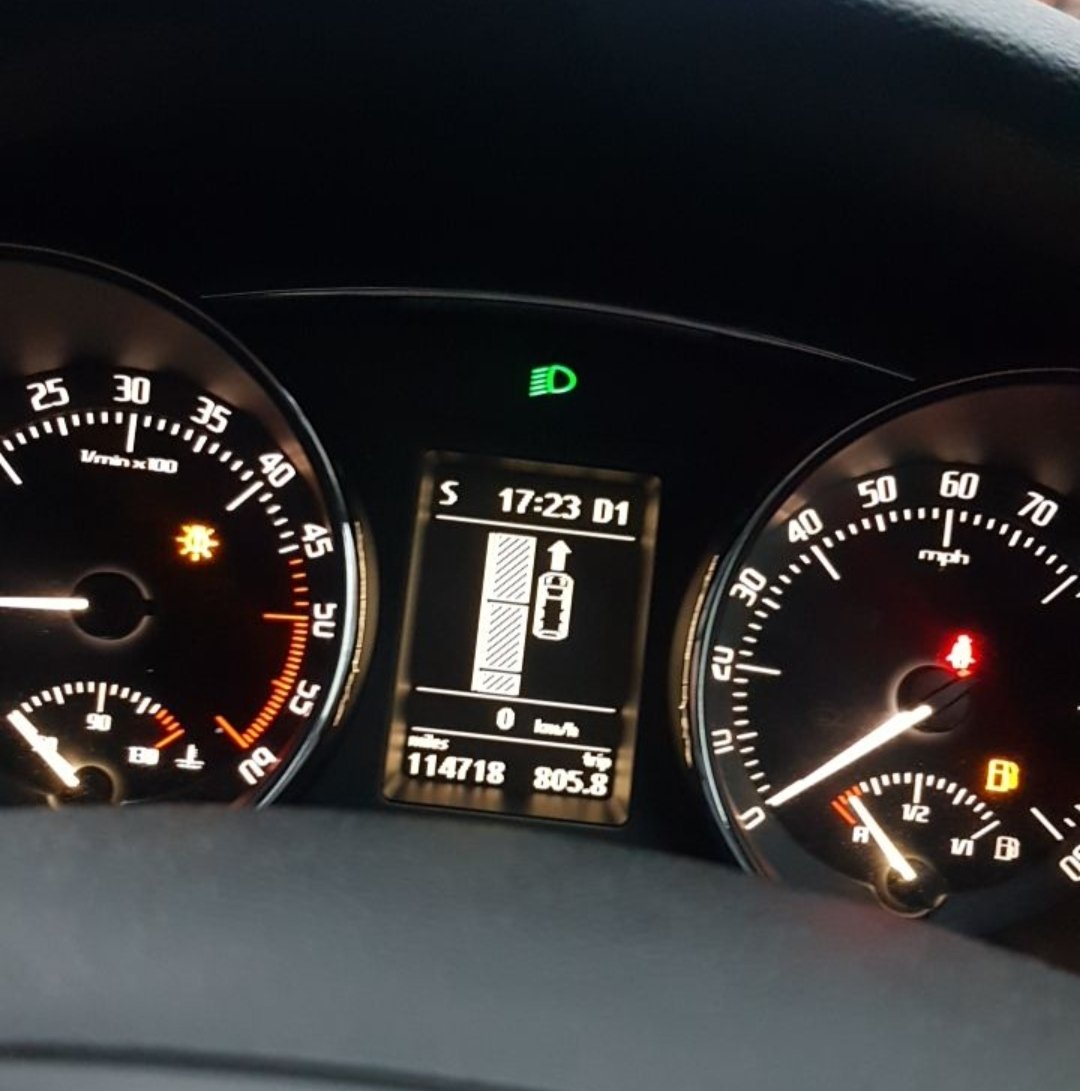

On my car whilst it does default  to the left I can switch sides with the indicators.

Mine is UK version and it does show speed in MFD and it is in km/h, my park assist default shows cars on the left.

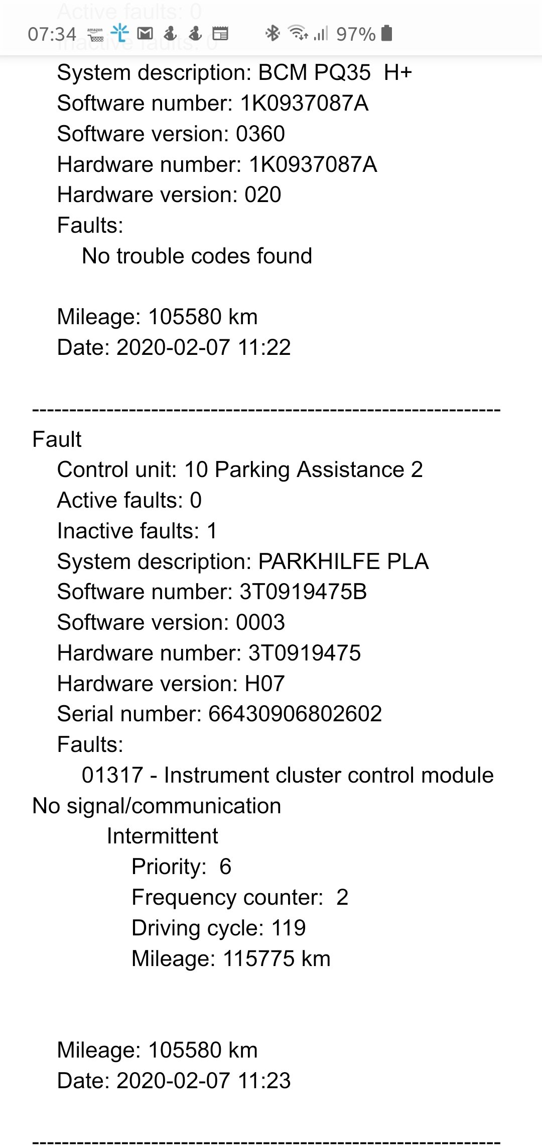

@129c
Here is my old scan. Showing module SN.

Those two part numbers are the same part, the 'B' suffix just refers to a later version of it. It wouldn't make much sense from an engineering point of view to have two different parts for left and right hand drive. It's most likely that there's a setting somewhere to change this but it will require diagnostics to change it.
