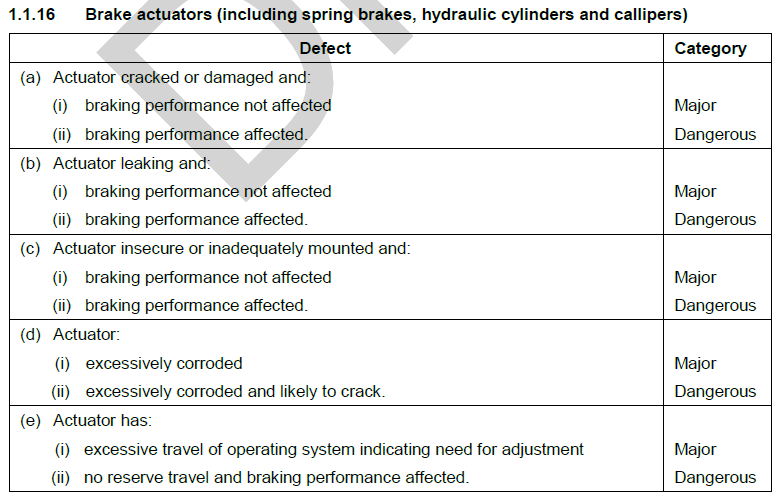

Looks like a sheared off brake nipple would be a major fail under 1.1.16 (a) as cracked or damaged?

But the nipple is part of the hydraulic cylinder (which is listed as an actuator), so a broken nipple is surely a damaged "actuator"?
A scratch on the surface is also damage, not worth debating, our opinions will not make any difference lets wait for an MOT tester to confirm.

A broad interpretation of 1.1.16 (a) (I) could cover it I guess, so I could glue it on until I get a chance to swap out the wheel cylinder, or delay the MOT until then.

On the suggestion of a workmate who does his own car work, I posted a query on the motester.co.uk site.  I got a reply from a moderator there to the effect "as long as there is no brake fluid leakage this will not present a problem at MOT"
So it will wait to be repaired in better weather. :)
Good discovery to make, that forum, could be handy for others with similar obscure queries.
Sorry people only just noticed this Thread and yes the reply you got from a Moderator is correct, a sheared of brake caliper nipple is not an MOT fail in it's self although i do advise it, how ever if it is leaking then it becomes a fail marked as DANGEROUS. i have actually aborted a test on this as when my assistant pressed the brake pedal, brake fluid was leaking out under such pressure it was just un safe to continue, the vehicle was very rotten on the outer sills (it was a ford searra) that it was taken away on a low loader.
