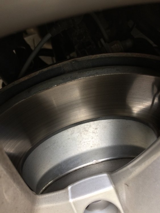

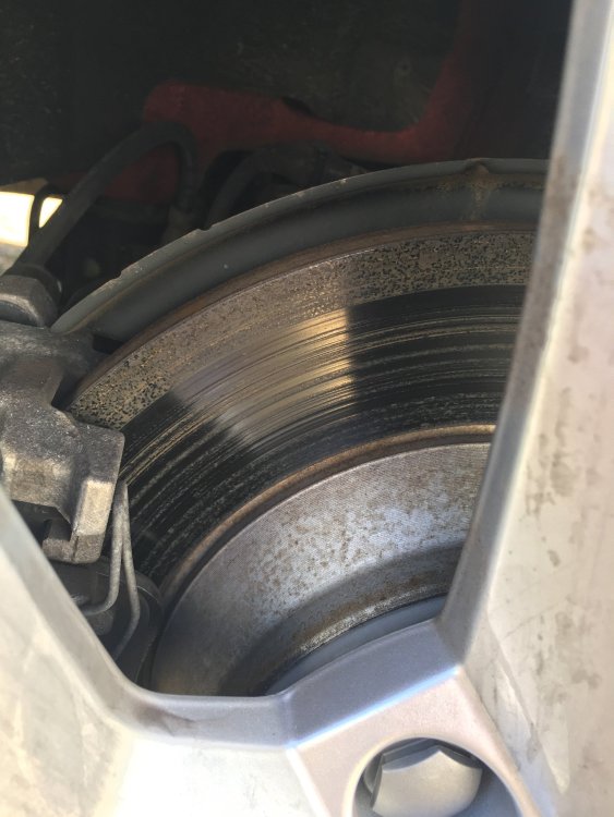

Took delivery of my wonderful kamiq last week! I am now 189 miles in and I have noticed my brake discs are scored on the rear. See photos, now I know the car is still new and maybe I should see how I go over the next 6000 miles as I know brake pads and discs are only covered from new for the first 6000 miles or 6 months which ever comes first. Has anyone come across this even so with how the new the car is?

Hi, that's truly dreadful.
It will only get worse, in my opinion, so get it back to your dealer now and register your displeasure and concern.
Maybe email the photos to Skoda UK too, ask them if they think this is OK?
As per Wino get it booked in with the local Dealer and ask them to fit new discs under warranty or you will reject under the 30 day return policy.

Yeah, I'm going to give them a call tomorrow!
Scored brakes are fairly common on Skodas.
My Kodiaq is on its third set. Around 10,000 miles between new rear discs and pads under warranty.
No arguments from my dealer. The original pads were made of cheese. Third set looks fine.
Your marks at only 189 miles are surprising.  Have you caught some grit under the pads?
Have you given the brakes a good hammering to take any “shine” off them?
And I mean a REAL work out where you activate the ABS from high speed.

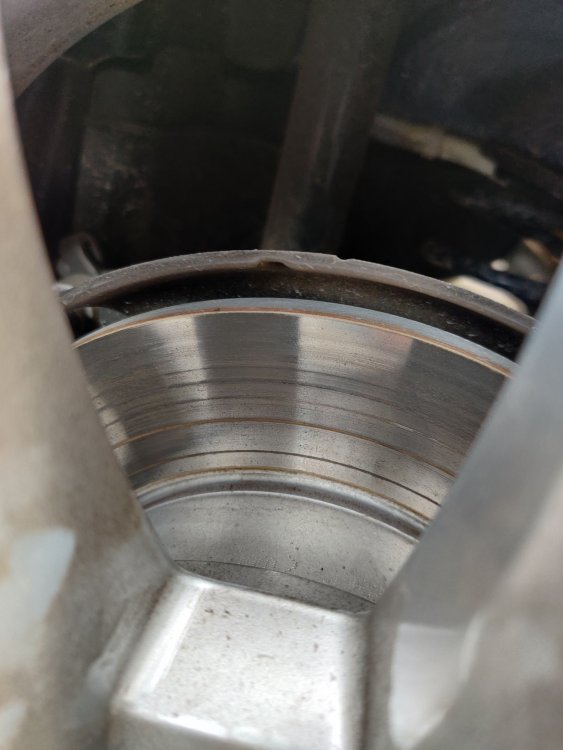

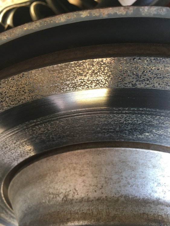

Was delivered to dealer on Tuesday and I picked it up on Friday. Has 23km on it in the yard and drove it 9km home and has been in the garage ever since. I noticed rust on discs at the yard but expected it after boat trip and was fitting mudflaps when I noticed the grooves, which are NOT like unbedded discs at all. This is my 4th VAG car in 10 years and none have been like this. Havent even had to change pads in any of the others and discs have been perfect all the way through

mine has the same only after 500miles
Mine was the same but after 6000 miles all smooth
mine have smoothed of a fair bit but not perfect after 1000km

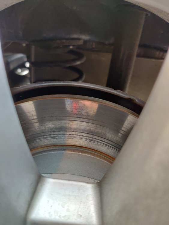

New Kamiq collected 30 November....new dealer stock...about 50 miles on clock....now 500 miles...uneven  variable deep scores on rear discs.
Front disks clean, silver and perfectly smooth.

Rear brake discs considered OK and not yet bedded in after a workshop inspection.
Will wait and see what happens in the next few months and a few more miles.
