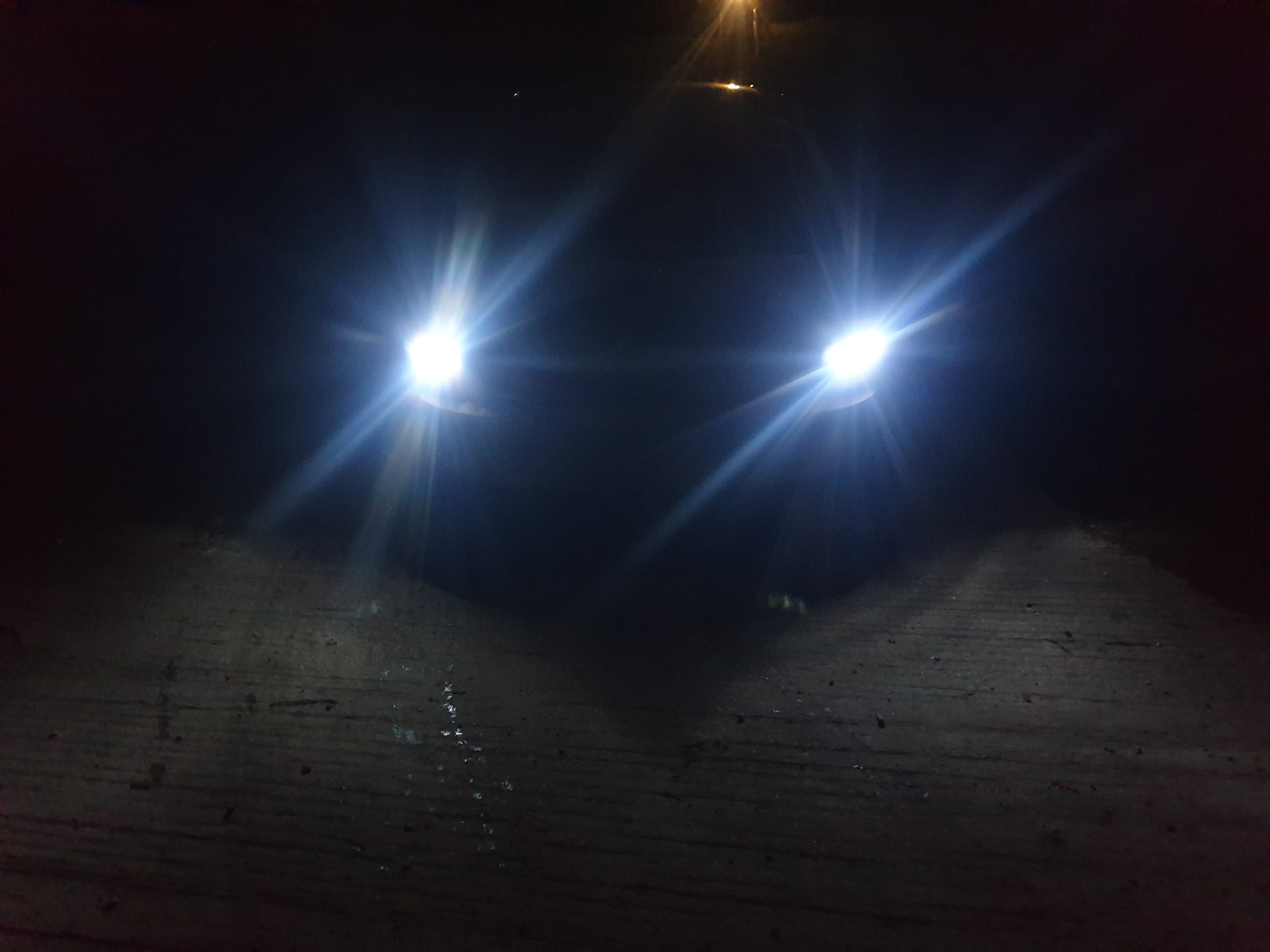

Not sure they are the exact ones I got
Not the best picture but just on a dog walk now
My good god, they're hopeless, where's the driveway? I guess the main thing is that they're blue, amirite?
