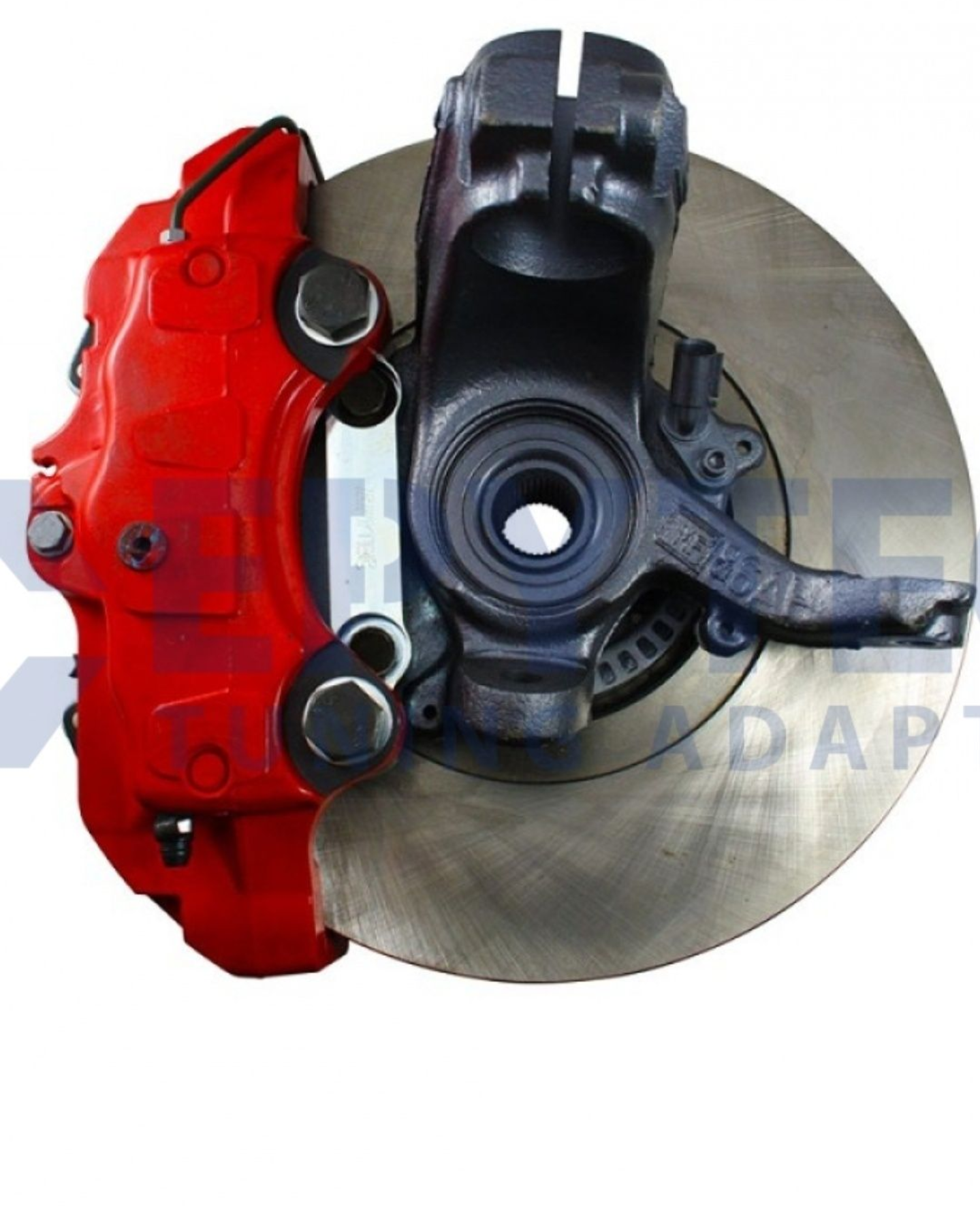

and here comes the info for the fronts 312x25mm ... red

Non-vented rears, hmm, 272mm is interesting though. Not sure how differen't the newest Polo platform is to the existing polo/fabia.
The older polo 6c from 2015 is more similar to the fabia. What is where i got all the bits from for the 312mm on the front

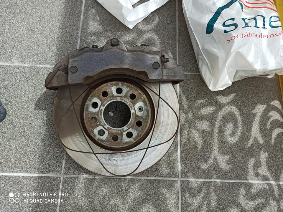

So a change of plans, got a bargain on a set of 18z calipers+ rear brakes from a VW tourage R50 for 140 euro, will try to  mount them on the Fabia.Is the adapter the same as for the 17z? And any one has a idea for a upgraded master cylinder  that would fit?
The mounting of 18z should be the same as 17z. The rotors should be something between 330 and 350mm. Use ferodo ds2500 pads.
Personally dont like 18z brembo's. Prefer 17z or the bigger 8 pot.
They where cheap so i can't complain, i just need to find a upgrade for the master cylinder.

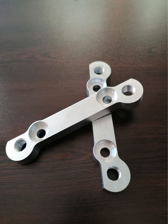

Not sure i like the look of those flimsy aluminium adaptors to hold my brakes on 😨
  • 6 months later...
Update :D
Ordered the adapters, they fit with modification, one corner that is facing the bearing housing  needs to be trimmed for few mm. After that they need a additional spacer around 3mm towards the caliber bolt holes so the brake disc is in the center of the calipers.  This is not mounted, as i don't trust the spacers so the adapter will be "cloned" with proper measurements and done by a local CNC shop.
