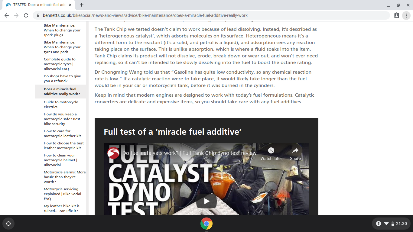

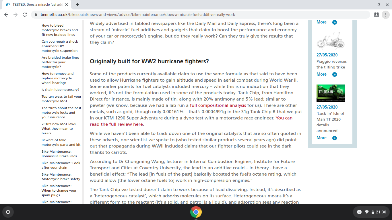

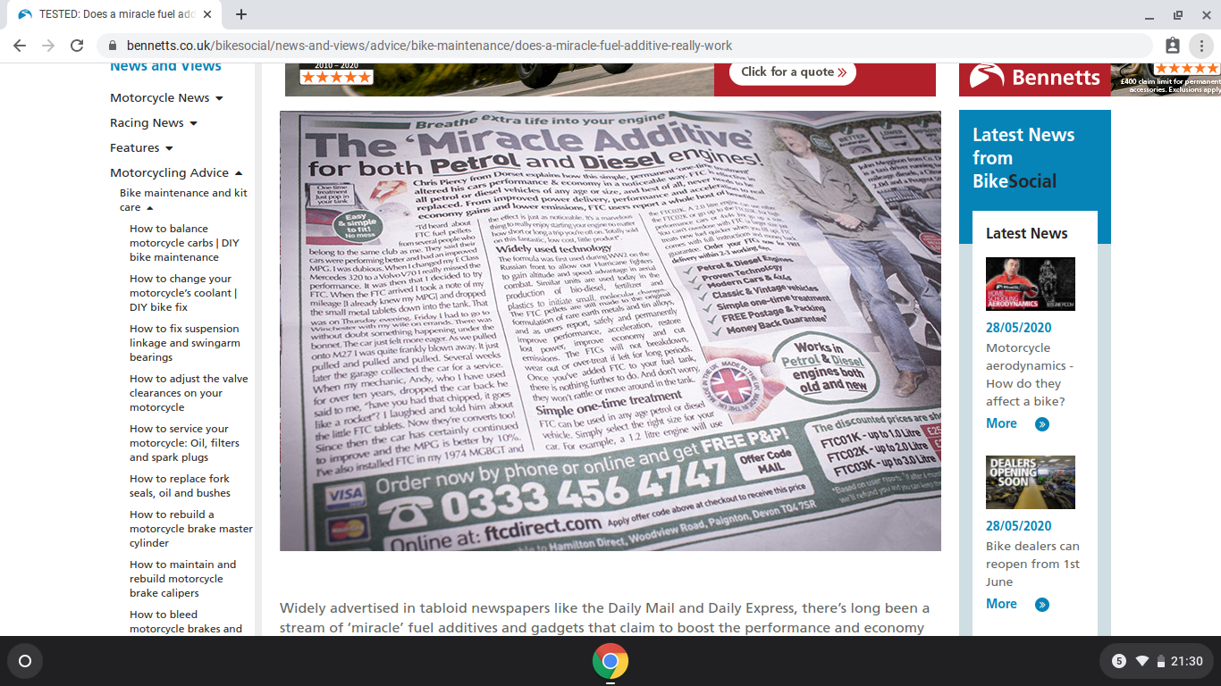

If you do think its a scam..then why haven't ou repoted them to the ASA?
@GeorgeB
Where are the adverts for the ASA (Advertising Standards Authority)  to look at?
