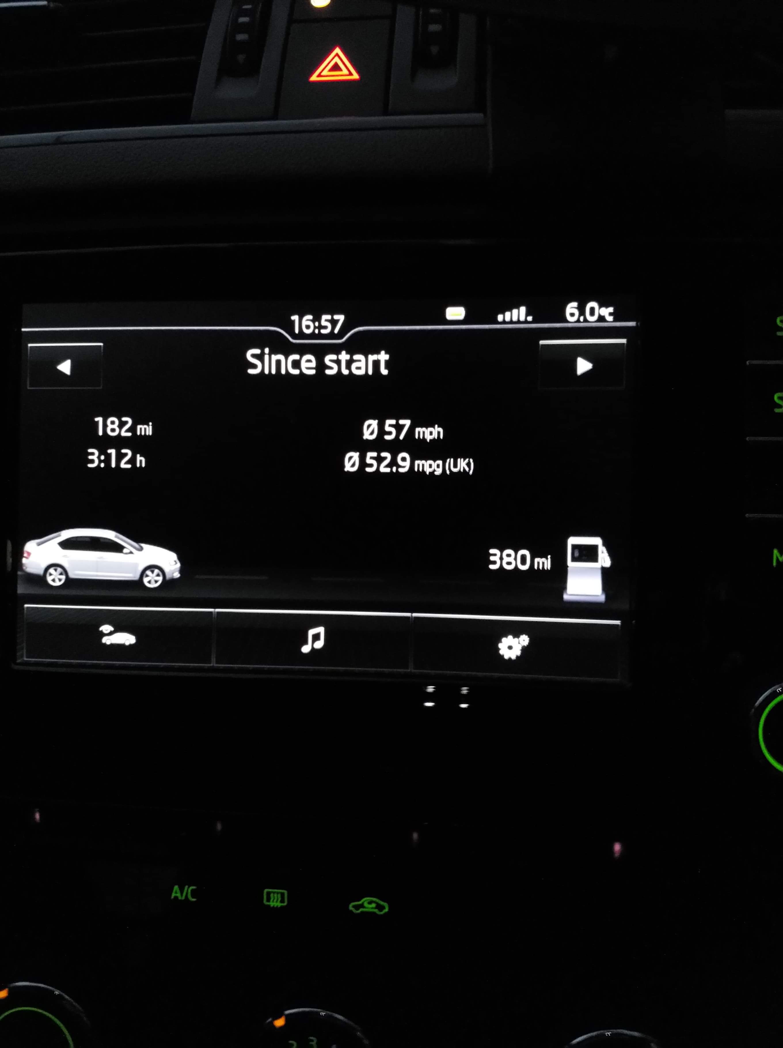

My son now has one - It's a great cruiser doing only about 2000rpm at 60mph. Economy is pretty good considering it's a petrol - my son seems to be getting around 50mpg on a run - we found a low mileage 2016 1.2tsi S model. Considering it's the poverty spec it integrates well with his technology!
Only fault thus far (touch wood) has been blocked rear washer jets - cleared with a pin. Brown rusty sludge came out to start with so clearly there is something in there that can rust so possibly a design fault!!

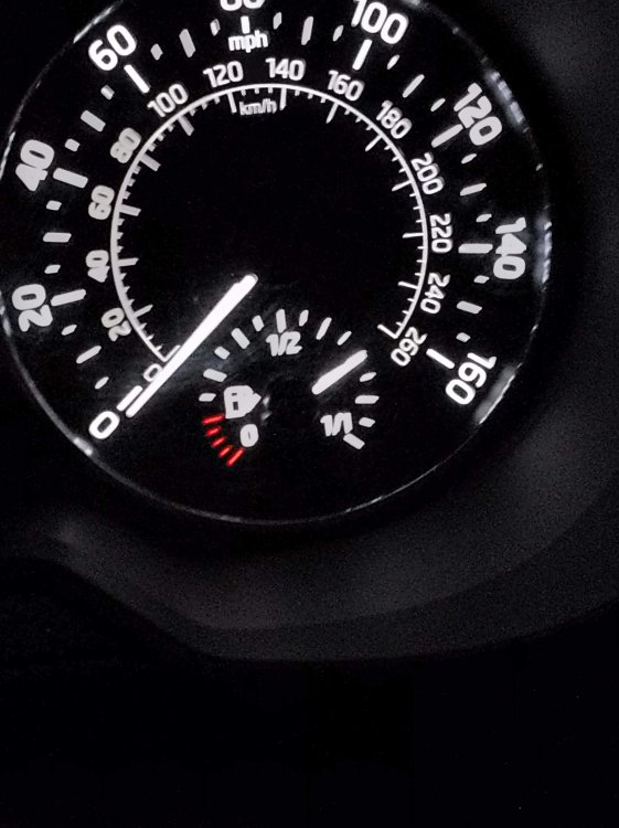

MPG and fuel level after a 182 mile drive:-
