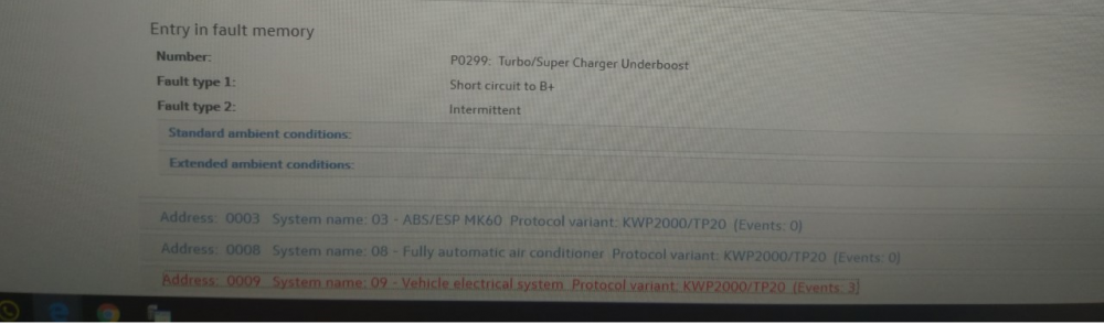

After trying all of this I then took the car in to Audi where they ran a diagnostic and the same code showed
P0299.turbos/super charger underboost
picture bellow is audi scan from main dealer
900554180_audiboostcodefromaudidealership.thumb.png.5f1fefd4db62cce91aff2e97b3cc6d17.pngaudi a3 8p1 full scan 05022020.txt
Audi has checked the vacuum lines and have said they are fine and have done a boost leak test
Where no leaks were detected, and have said the turbo is fine. they wanted to further investigate and spend another 6-7 hours at rate of £105ph which is too much to spend atm.
