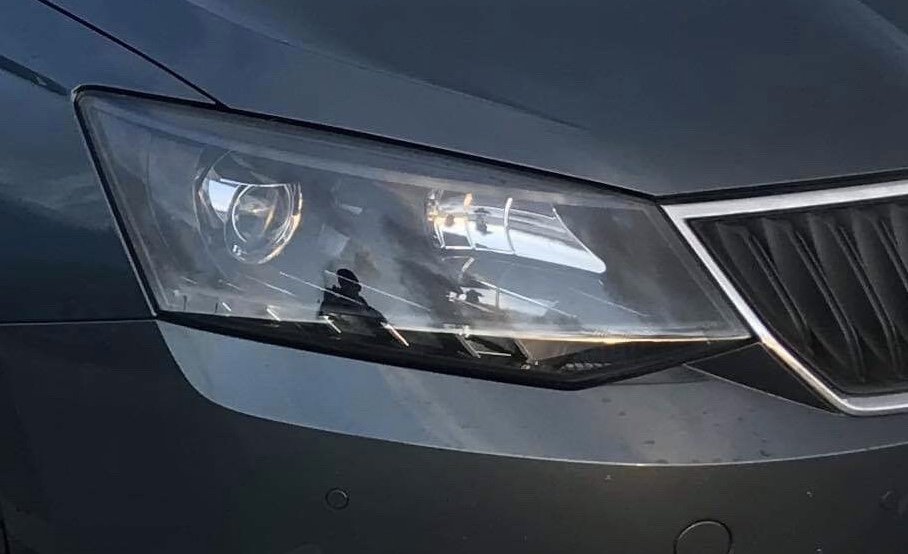

If your headlight is like the photo here I don't think the bulbs are H4 but H7. H4 are twin filament, H7 are single filament. You should be able to see which it is by just looking at them. The earlier reflector headlights only had one bulb, an H4, but these have 2 reflectors with, I suspect, separate H7 bulbs for main and dip.
That does indeed look like the headlight of my Fabia so now the bulbs are H7 which is where I started 🙂

Do have a look at the filaments before you buy, just in case they have done something wierd like one of those is a sidelight, they both look like H7s though as the H4s have a bigger bulb envelope.
That's a Fabia headlight? Looks more like a Scala one? Different grille and bumper too? I've seen a few 69/19 plate Fabias, and was recently at a dealer in the last month (sat and waited for major service, sigh, shoulda taken a sleeping bag), don't remember them looking like that. Maybe i don't notice them cos i don't recognise them as a Fabia 😂
Those may well be H7's in a dual reflector setup. Maybe they realised that H4's weren't bright enough, theyre only 1000 lumens, even 1500 from the H7's isn't amazing (1600 H4 full beam).
I checked through multiple parts sites, and they all show the same single H4 reflector, or the H7 projector + reflector. I thought the facelift was only projector or led. No reflector anymore?

Here's mine for comparison.EE92E6C3-E495-47A9-BEC6-BAD326EB8AB4.jpeg.6101a2abea2f3201b836a10fddae93f3.jpeg
