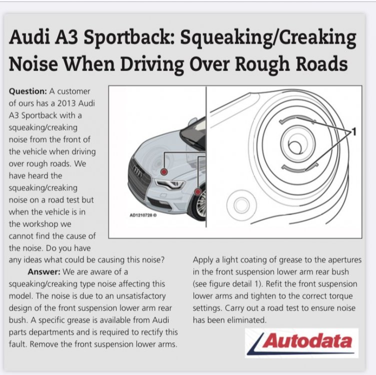

There is a bulletin about the cracking it’s the same fix as Mark 7 golf they remove and grease Lower control arm pivot bolts

This is a tpi bulletin from vag not a bodge made up by some random dealer

It’s not metal to metal contact that is causing the creek it is  insuffisant Clearance within the bush construction This is a quick cheap fix and will work for most

Thanks for the TPI.

My 2015 scout had this TPI about 2 yrs ago. The ‘squeak’ is starting to return, so I planed at some stage to have the whole arm replaced.
So hang on, the hole was too small to allow full clearance and the answer is to wack it full of lithium grease?
Why can’t they just design a new bush revision with greater clearance or no hole as appropriate and then just fit that to provide a lasting fix.
The grease sounds like a quiet until  you’re out of warranty then make the user pay for modified bushings.

Solid bush transfer more vibration to subframe so there not inclined to do this on a more comfort orientated cars.back it mk4 golf days they only yoused the solid set up on the Audi TT and more sporting models on that platform . Like all manufactures they will only do the minimum the have 2. Bushes are not going to fail any mot with this problem so it’s not a safety concern . It’s a cost per complaint more than likely there is already a revision to the bush .
