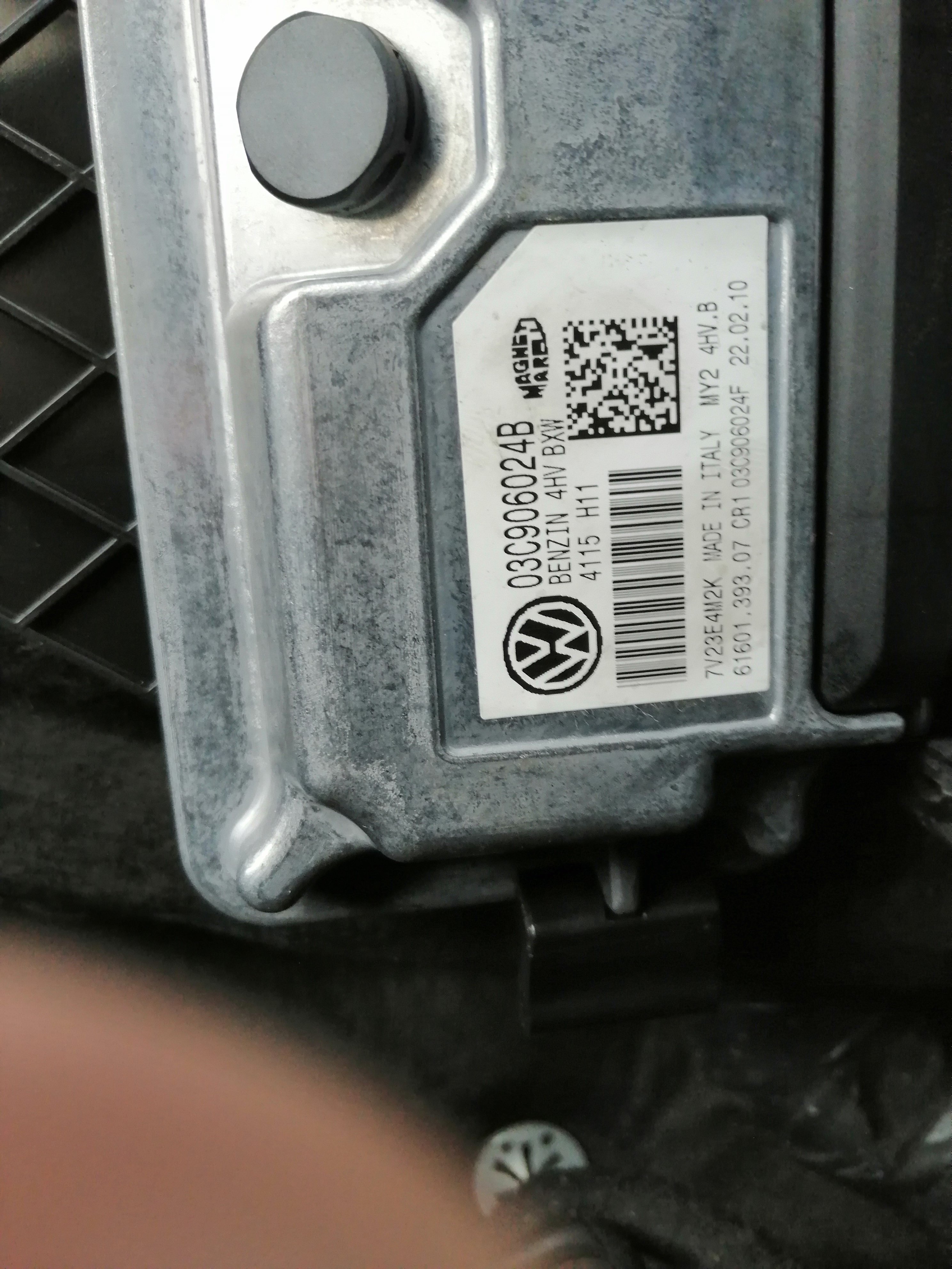

My brother has a Mk 2 Fabia Estate 1400 85hp registered November 2008 and has been having engine problems.It started in September last year when the car started losing power, eventually stopping: no warning lights came on and after the Green Flag technician had connected his diagnostic kit up the fault code PO685 was displayed . After a while the car started  and they went home. This fault kept returning and the local Skoda dealer had no interest whatsoever in the fault code found by Green Flag. Long story short, the dealer has eventually replaced the ECU with what they say is a compatible VW part . I have attached a picture of the 'new?' part and would like to know if it is fully compatible with my brother's car. The car seem to be running OK but he lacks the confidence to make any long trips in case he ends up at the roadside again.
If the part isn't the best will the correct spares be available anywhere at all please?

Is it a 5-speed manual gearbox car?
If so, I suspect this is exactly the right part. To confirm, your brother needs to look at the data sticker on the boot floor, or in the service book.  He needs to see BXW for the engine code.
See the tenth line here https://skoda.7zap.com/en/cz/fabia/fab/2008-608/9/906-906000/#1 Matching part number  03C906024B
That unit photographed appears to be ten years old, judging by the date in the top right corner of the label.  That doesn't mean it's secondhand, necessarily, just that it was built on that date.  It looks a bit too clean and shiny to have been used before, I think.

From the description 2008 1400 85hp I'd reckon that matches the BXW which was 86PS or maybe 85PS in some marques.

Many thanks everyone for your help, it's put his mind at ease now.
