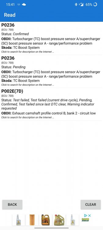

This seems to be happening more regularly so I brought a OBD code reader. I have attached a screen shot of the fault codes displayed.
P0236 relating to the turbo boost pressure sensor
P002e(7d) relating to the exhaust camshaft profile
Over the last week I have replaced the Turbo boots pressure sensor. Also the oil ran low (naughty I know, hadn't checked it in months) so topped it up with the correct specification oil.
My next port of call is the exhaust camshaft profile.

So it went in for Service with a reputable VAG specialist here in Birmingham where a diagnostic was carried out.
They advised the car is occasionally lazy on start up but couldn't find a specific issue. They said the problem may not specifically be caused by the sensors detailed in the above screen shot & their fault codes.
