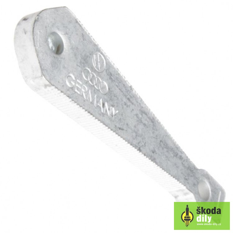

Thanks for the input,I appreciate it all. The self adjusting system is simple enough ,but as always doe not work well. when I whip the sub frame out ,I will case harden the wedges and mirror polish them. that should hep. I have no problem with the brakes apart from the self adjusters
That will stop them working altogether - the wedges have teeth on them, which they need to work properly. My experience is that they work perfectly well when everything is in good condition.
Edited by TMB
Fair comment I will see if I can replace the wedges then
I suggest you simply strip and clean the brakes and reassemble everything correctly, make sure the nylon glide pads are all present and correct, it is unusual for drum brakes to give trouble unless they've been bodged and aren't working properly.
