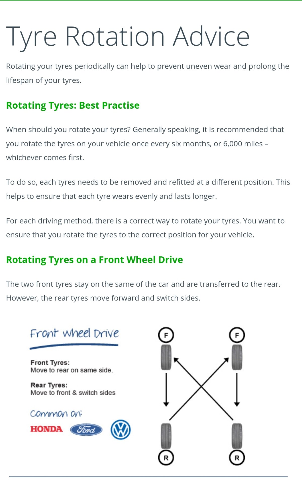

My Fabia has done 11,000 miles from new
(15 months old). Is it time to rotate tyres?
I've seen the following advice,what do you think?

Have the fronts both got plenty of tread still?
I would just put from front to the rear on the same side.
What you posted works as long as you do not have directional tyres on the car.
Yes,still good tread on the fronts.
Directional tyres were mentioned further down in the article.
