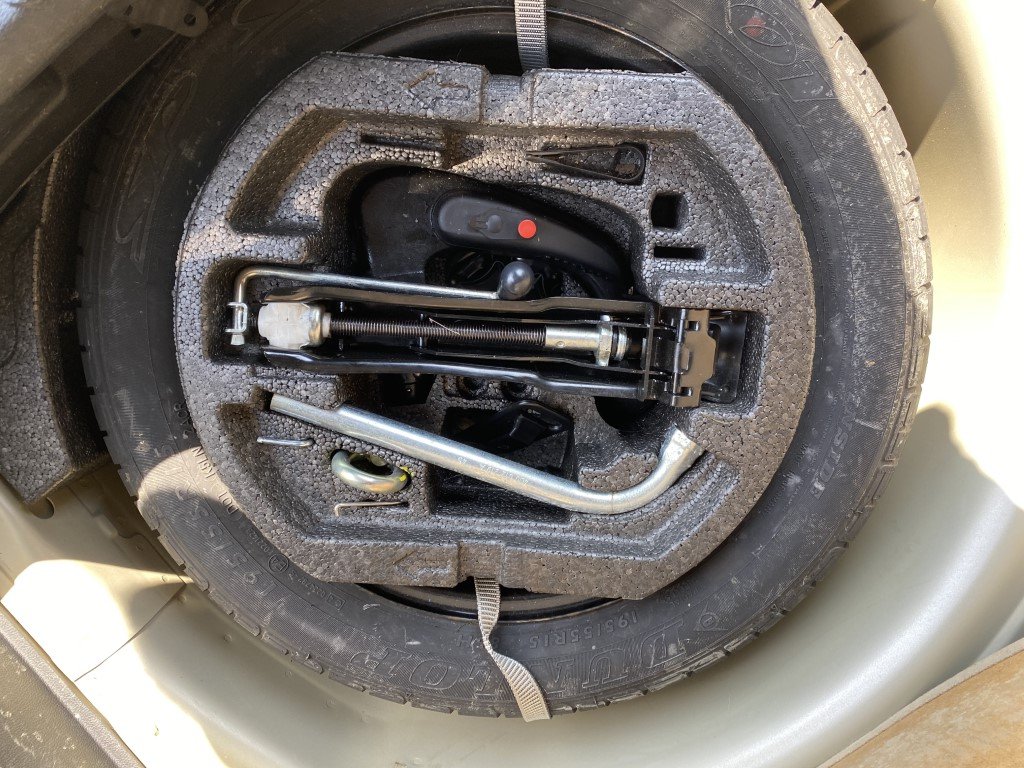

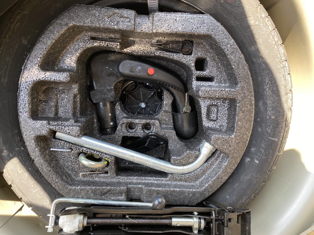

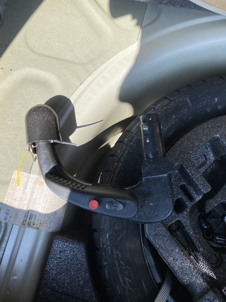

Does anyone know the roomster scout comes with a factory fitted tow bar, i picked up my 2011 roomster scout today and was suprised to find a towbar in with the spare wheel in with the moulding that takes the jack ext. :) and there is a removable panel in the bumper held on with 2 screws.

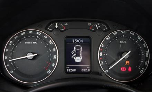

Mine also has a full length black and white panel between the clocks, the swinging headlights and cornering fog lights.

what do mean by full length black and white panel between the clocks, i will have to check out the lights now as well 😛

Mine has a full black screen with white writing - I'll be fitting the canbus adaptor soon, that will allow satnav directions to be displayed

no for towing a trailer, the factory towbar hitch is in with spare wheel but the bumper has not been cut out so it can be installed.

it is possible the swan nect was placed in the boot but its a brand new factory item still with the keys attached, i cannot see any electrics but i wont know until i pop the bumper off

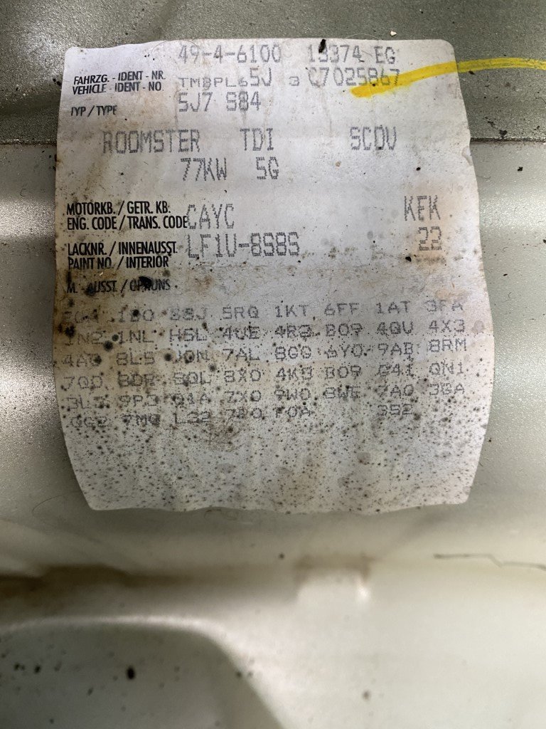

You could also look at the build codes in your service book for a factory fitted towbar- there are websites that will tell you what they mean

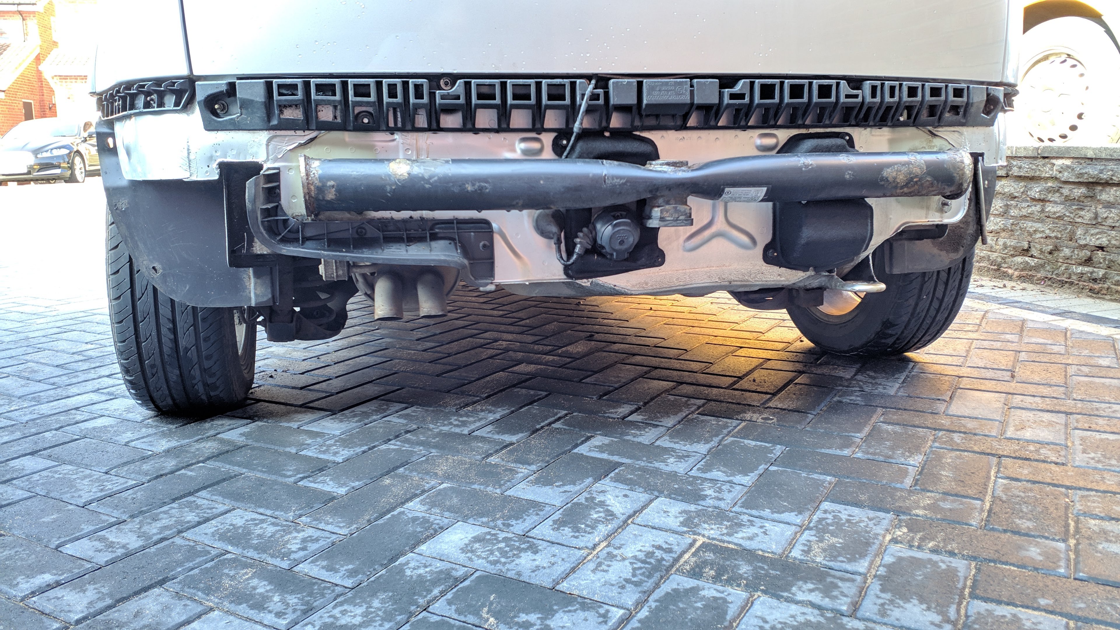

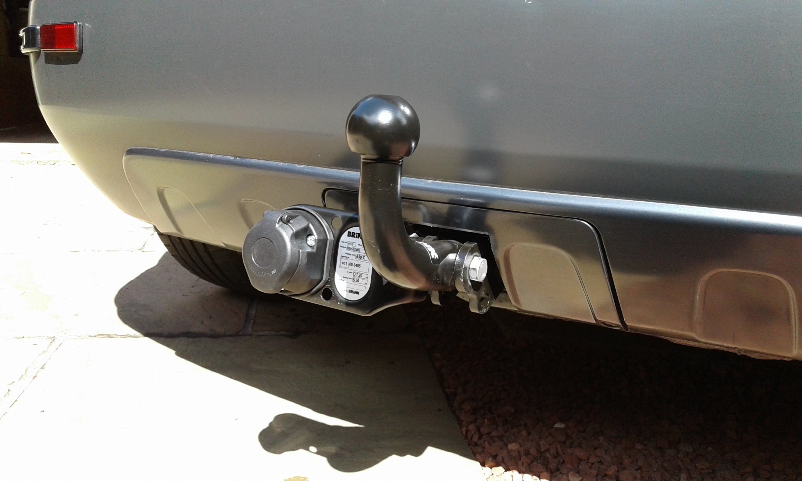

Whilst fettling the tailgate I tried to fix a dead parking sensor, well after a fair bit of anglo-saxon it became apparent that the bumper had to come off.
This is the factory fit towbar and 13 pins electrics as proved by the build codes, and this is after a HUGE amount of cleaning - I will be fitting mudflaps asap !
cheers ofr that buddy, i had the iner panel off mine yesterday and i can confirm there are no electrics heading into the bumper apart from the parking sensors 😞

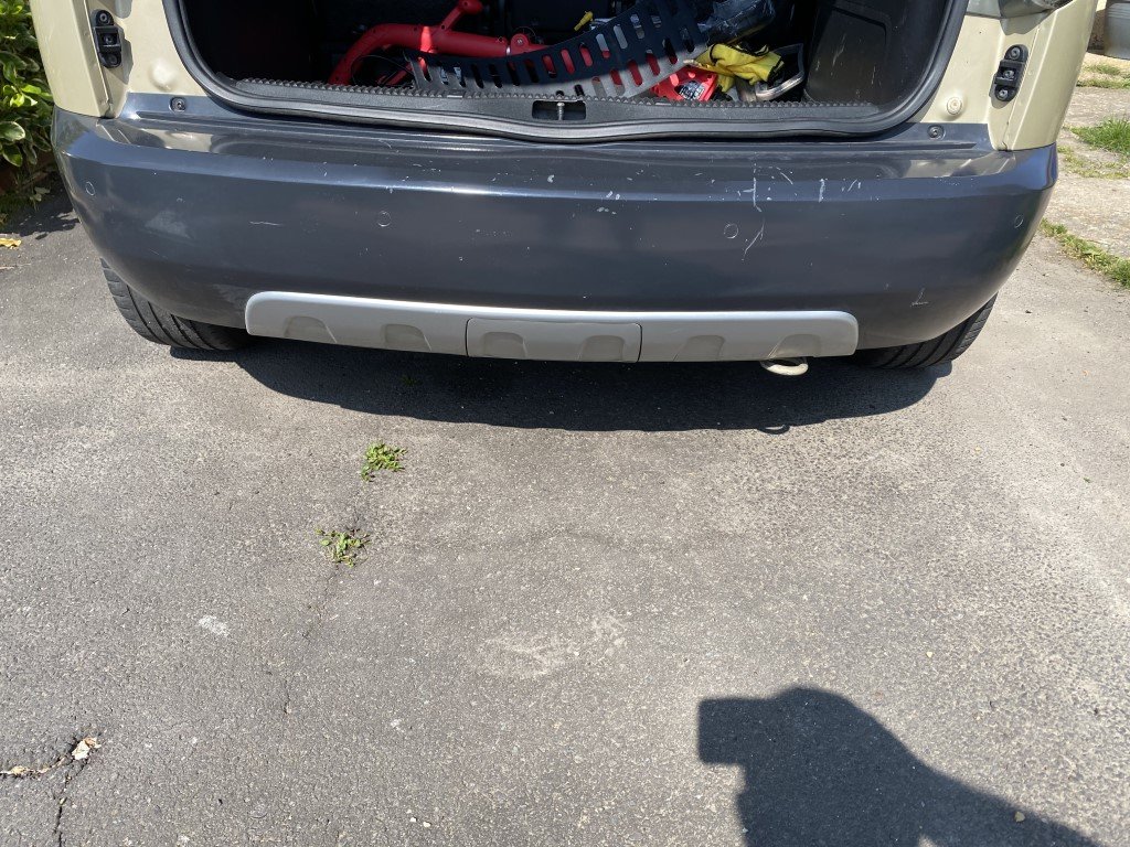

Here is the cut out / blanking plate / cover in situ...
Once removed...
What are the screws you mention? There are no screws. Unless the cover has become loose or the securing tabs have broken off and the previous owner has screwed it on instead?
Detachable swan necks aren't just randomly thrown in the boots of used cars, so if you have the outline of a removable panel, like this, then it is highly likely you'll have the receptacle for the towbar...

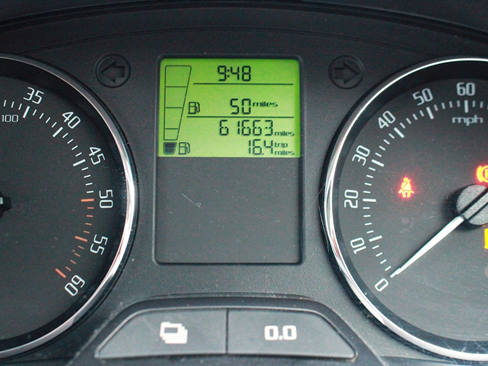

Standard...
Maxidot...
The swan neck panel the bumper of my Scout is held in place by two screws, half a turn and it pops out.
You don't need to have this panel to see whether you have a towbar fitted, just put your hand up underneath the bumper and you'll be able to feel it. - there's a gaping gap between the inner wheelarch and the bumper, big enough for me to be able to reach the parking sensor.
I think the easiest and cleanest way to see if you have a factory fitted towbar is to look on the build code sticker (in the boot, or your service book)
thanks guys, if i remove the panel on the bumper the inner section has not been cut out 😞 i found the build code sticker in the boot but no idea what the codes mean
