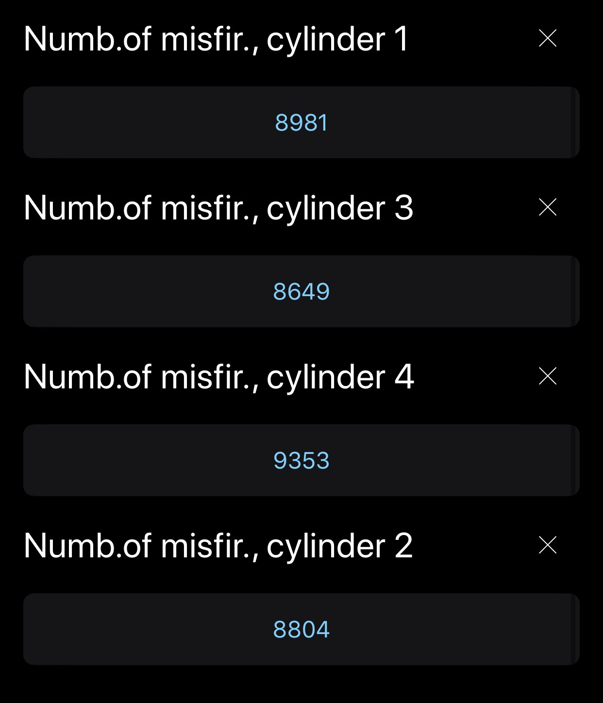

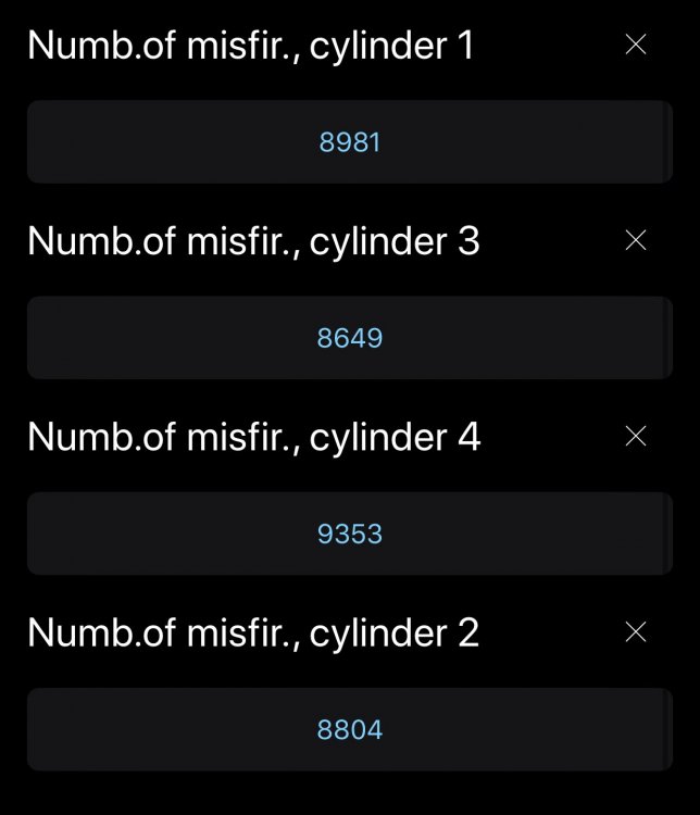

Hello,
Found an error 3 days ago:
P0303 - Cyl. 3 misfire
P0300 - Random/Multiple Cylinder  - Misfire Detected
No check engine light or any other lights on the dash.
Removed the faults (have them in a backup) and did not show up anymore since then.
Strange though, I did a live reading of parameters, for misfire, and seems to have some high numbers of misfires i believe since beginning - 2.5year old car.
And if I hit the throttle hard and go to high RPM's I get 1-2 more every now and then.
Is this normal? Should I check something? Could it be the gas although it's Premium 100.
Did anyone else read these live parameters? Or it should 0 or close to zero?

In terms of what it's counting, I wonder what 'misfire' technically means?
Spark not generated at source, spark plug didn't spark, combustion didn't happen, combustion below normal parameters, injector didn't inject, or a whole host of other things?
Don't think I've ever owned a car, new or old, where I haven't detected the occasional misfire.  Unless it's affecting the drivability of the car, I don't think I'd be concerned.
If the car averaged out as running at 2,000rpm for just an hour a day, that's 900 hours (ish) over 2.5 years, or in other terms, 54,000 minutes.  54,000 x 2,000 = 108,000,000 fires. Which equates to a successful fire rate of 99.992%.  My simplistic maths are probably squint, but what I'm thinking is 9k in 108m barely registers.

I did a similar math but different, regardless of the time droven, i's count in average of 10 misfires/day for 900 days. COnsidering nothing is affected, drivability is fine, no errors. When you have in one run many more misfires, it will probably cause the errors to trigger as it happened to me, but not enough to cause check engine light...
So assuming this is normal....
Edited by ccosmin
Sometimes too much information is as dangerous as being kept in the dark.  Unless you know the allowed specification then the readings are pretty much useless.  For example does it count as a misfire if you lift off the throttle part way through the firing cycle so fuel is interrupted?  Is your car ACT or is that only the 1.5 models?

From his first post, the misfires are pretty even across all 4 cylinders so does that make it less likely to be a dodgy plug?
Sorry, was away these days, but I have 26.000 km done, and on my last 250km drive I had around 50-70 misfires per cylinder, on the counter. Sport/ECO/Normal driving....
